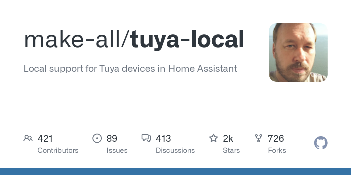

FYI… this integration works even if you have IOT core expired and it is very reliable.
This hit the spot! Thanks!!
