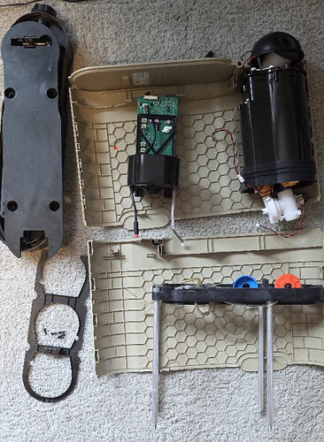

Word for the wise - these units are definitely NOT designed to repair (e.g. to replace battery). Even after "managing" ... I'm not sure there is any getting the ghost back in the machine once I get the board working.
On the plus side, more than happy to take any pictures of the innards for those curious.
Wow, yours has the valves. None of mine do. They definitely made it challenging but once you know its secrets, not too bad to open up. I notice you don't have the nozzle dome removed. If your unaware, on the top there is a little plastic disc that is attached with pressure sensitive adhesive. It can be pried off with a small spudger if you heat it gently with a hot airgun it comes off even easier. Underneath the Oto label disc is a screw to detach the dome.

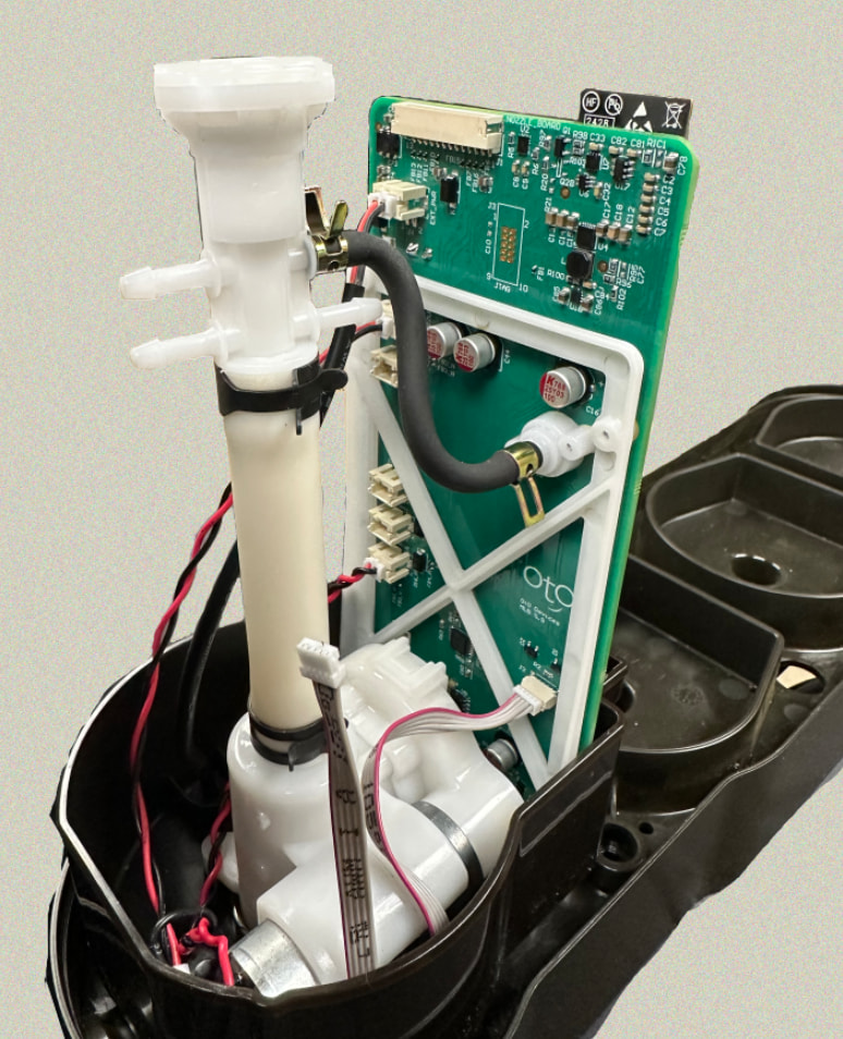

Another view :slight_smile:
At the bottom we can see the 5 pin UART cable that can be extracted from below with a black rubber plug.
Ahhh! I wasn't able to remove the nozzle (for fear of breaking it) but that will be necessary to put it back together. Are you saying I need to pry this part upwards/heat gun it? (Sorry for so many questions, and thanks for the tip!!)
It is a pretty tight fit in the sprinkle assembly itself with all 3 valves. If I can get your FW going that is one of the features I was hoping to revive - such a great idea.
Cheers
/Mas
No. I have not figured out how to pull that part out of the assembly. I was concerned I'd break it. I was only referring to the dome. The actual nozzles are on the face of the white piece in your image.
On mine the top white lollypop piece has a stem that goes into down into the top of white stem shown in my photo. That way the main valve can be separated from the lollypop stem. Inside the top white part in my photo is a o-ring.
