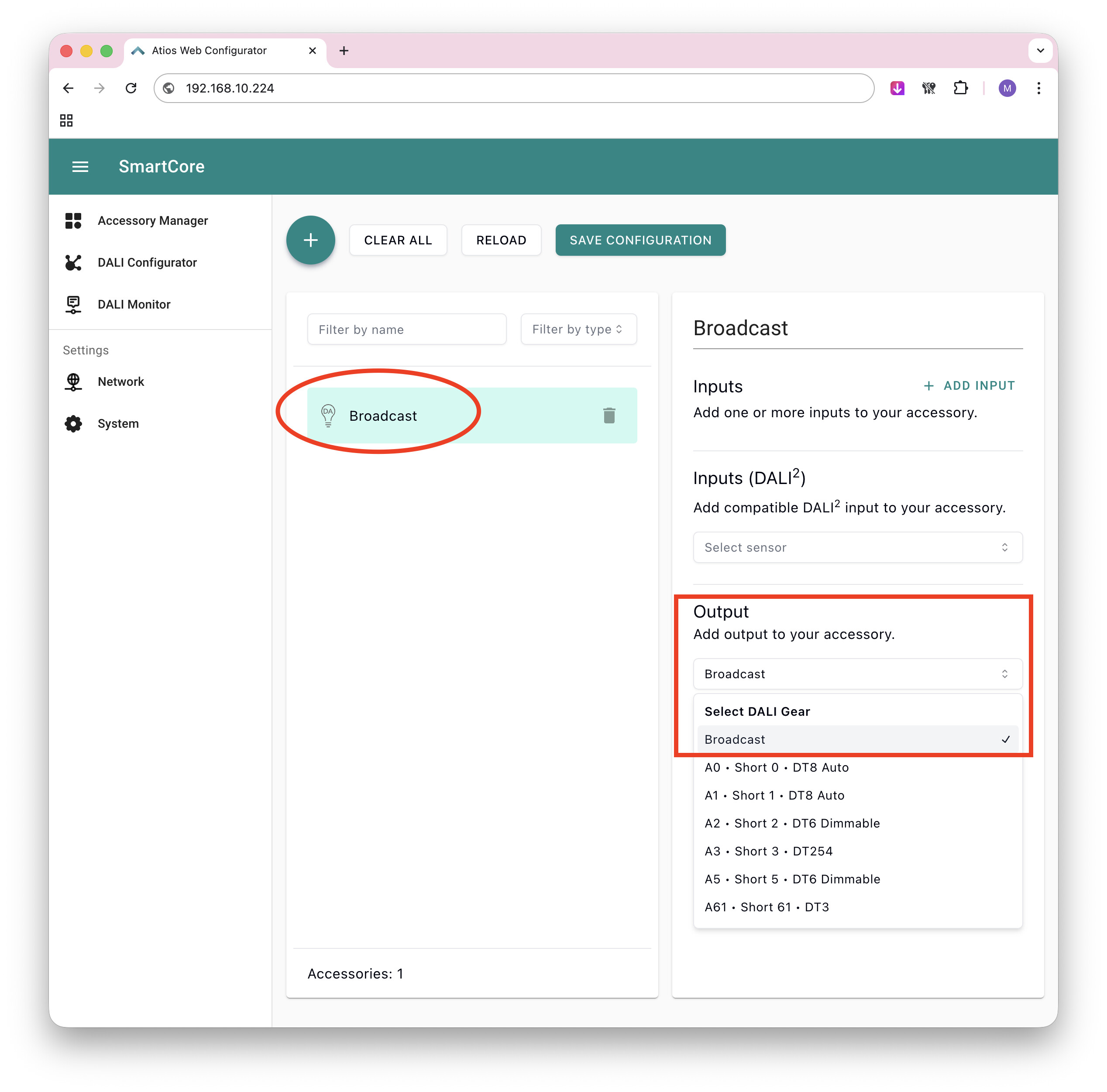

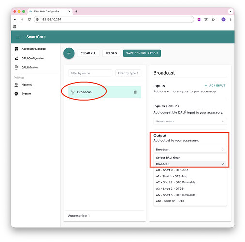

Actually that is possible, see selecting “Broadcast” (besides a single address, or a DALI group) as the output option on attached screenshot.
Even the status to the groups (if configured accordingly in the DALI Configurator) and the addresses will be synced correctly. Which is always a hassle with DALI otherwise (since no real status updates for groups exist on the bus).
