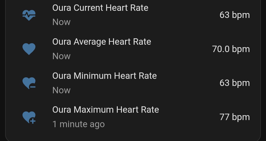

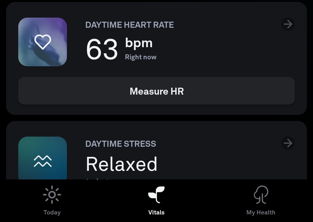

@willis-63 I just adjusted my integration to 1 minute.
Then opened my Oura app and forced a heart rate measurement.
Then went to look at HA and within a minute, my reading was there:
Please try doing the same and let me know?

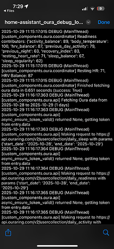

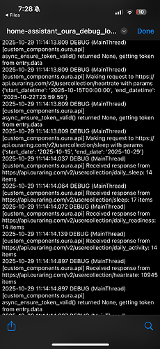

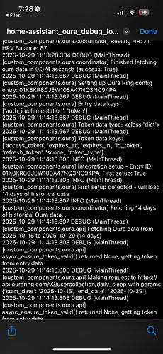

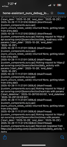

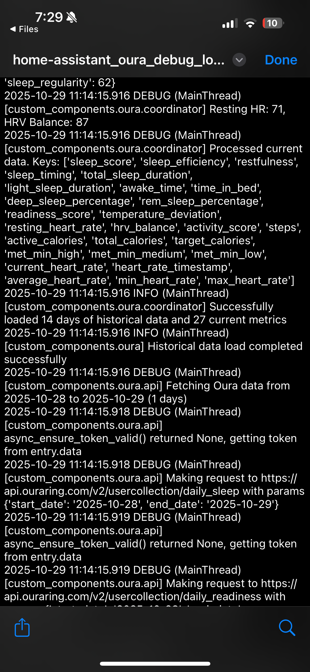

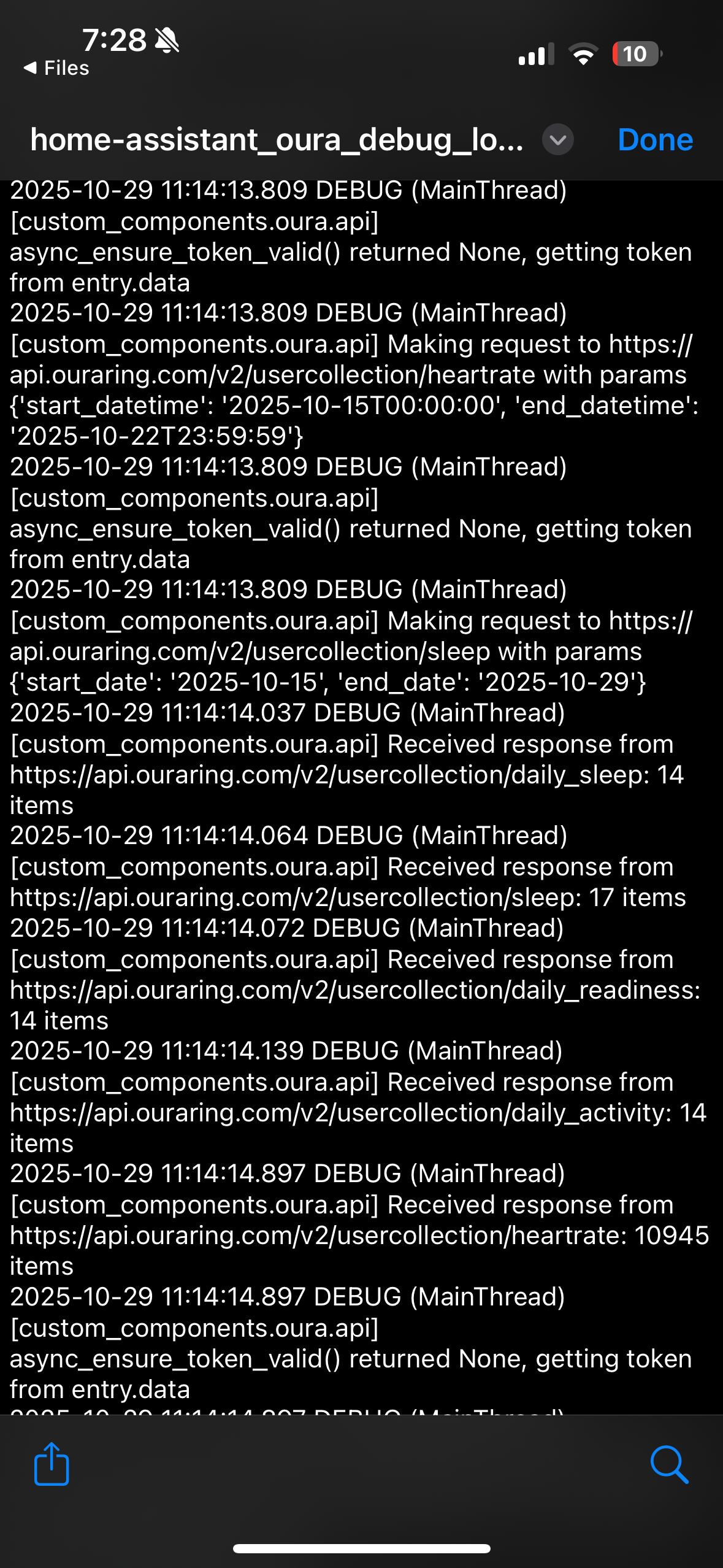

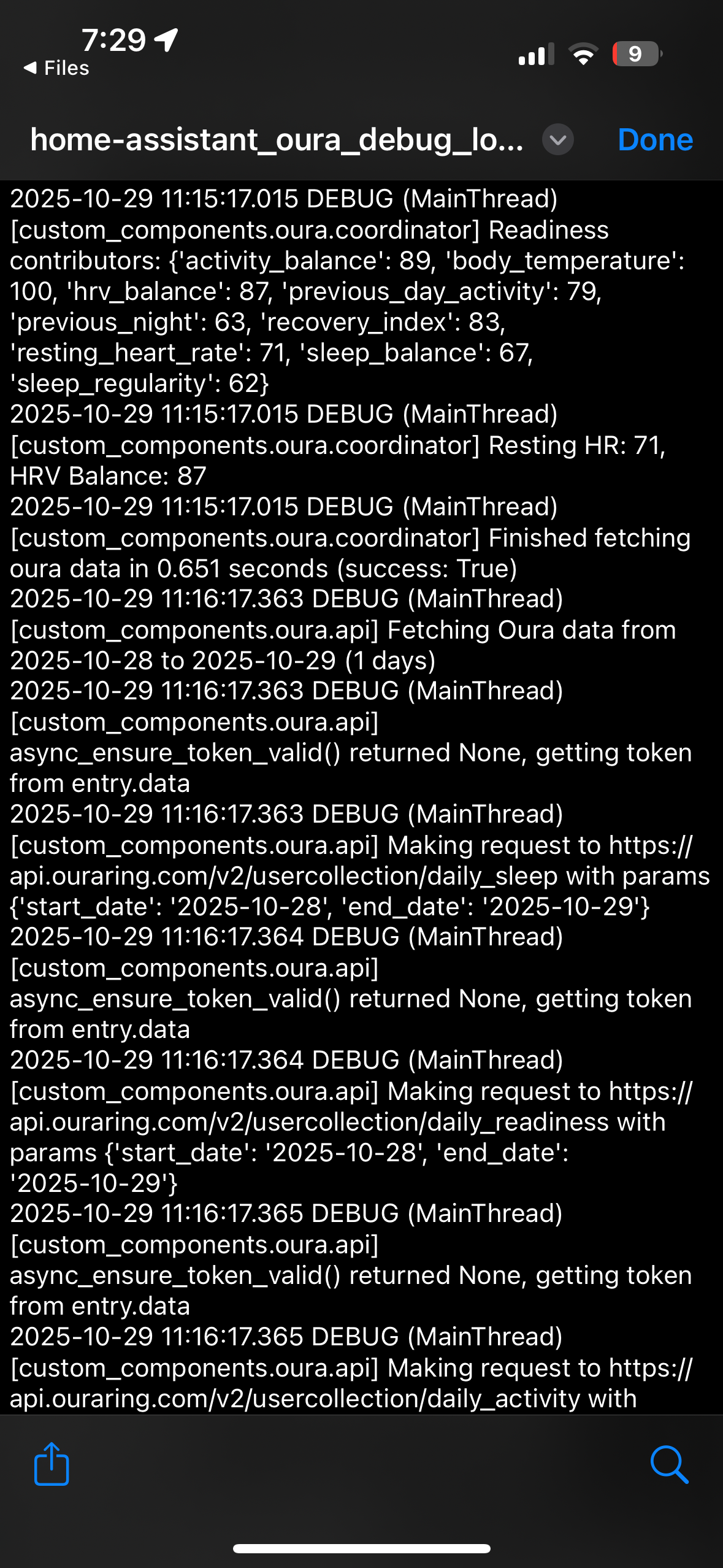

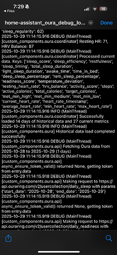

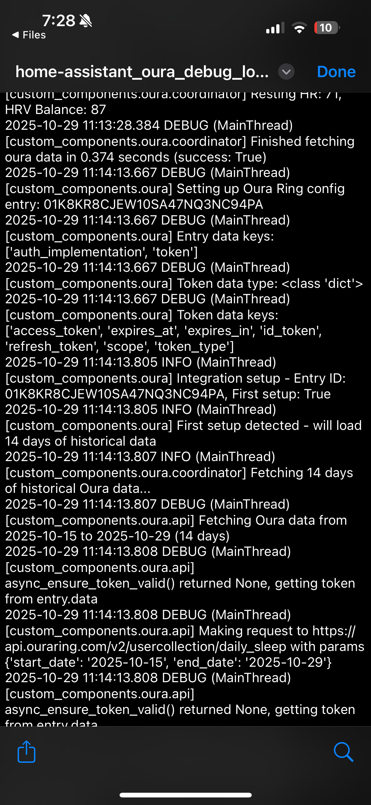

Okay that is very strange - Can you kindly provide me with some logs.
  1. Enable Debug Logging on the Integration
  2. Reload the Integration
  3. Wait 2 minutes (Since your integration is set to 1 minute)
  4. Disable Debug Logging
  5. Log File will be downloaded
Simply upload the file content on here or upload the file to some file sharing service like WeTransfer.
Inside the log files you will see entries for:
  • custom_components.oura
  • custom_components.oura.api
  • custom_components.oura.statistics
  • custom_components.oura.coordinator
Debug and Info are normal, any errors would be useful to see
I can upload the full log if needed, but I don’t see any notable errors. I actually see data in the logs. It seems to be behaving as it should. They even show successful grabbing of historical data, and successful recurring pings of the API. But as you saw in my previous screenshot, the sensors will go up to “4 hours ago” or “8 hours ago.”
I did notice that for whatever reason my API in general does not update as quickly as yours and I can’t quite explain that. I say this because even after forcing a heart rate reading in the Oura app, waiting 5min, and manually reloading the integration, my heart rate doesn’t change which would suggest the data in my cloud account hadn’t updated yet.
Edit: I checked again when I got home. It appears the sensors reloaded once on their own while I was out. I wonder if my API experience is just egregiously slow, as they seem to update when there is new information to grab.

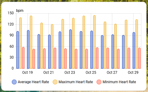

Please can you also try adding this card to your Dashboard:
type: statistics-graph
title: Activity Metrics
entities:
  - oura:average_heart_rate
  - oura:max_heart_rate
  - oura:min_heart_rate
days_to_show: 14
chart_type: bar
This should then show your entries for Historical Data.
Please confirm which Generation ring you have?
Looks like all the historical data is loaded in correctly!

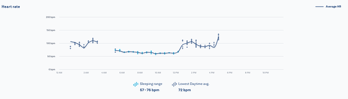

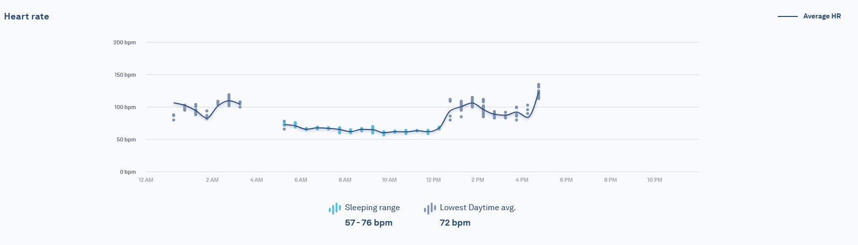

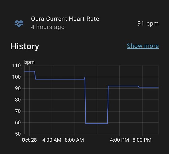

Unfortunately that’s not the answer in my case. I’m a regular subscriber, currently on the monthly payment plan. I have collected some extra information though. I’ve found that my Oura cloud account seems to reflect a day-time sync about 40-50min after it’s completed on the app. However, even with forcing a heart rate reading, that sync did not include any heart rate information for the time period between the last sync and this one. I’ve attached screenshots from my cloud account, rather than the app.
Screenshot 2025-11-02 194241
The only way I can make sense of that would be a data packaging difference between the Gen3 and Gen4, where the Gen3 simply does not consider the heart rate entity “high priority” enough to update the cloud. Maybe the smart sensing feature in the Gen4 includes tags in the payloads that allow for a more consistent uploads to the cloud, while the Gen3 relies on longer, less-complete batch uploads? I only say this because my sleep readings are instantaneously uploaded to the cloud in the morning, suggesting some data payloads or batches can be pushed through faster, maybe through “complete batch” tags or tagged as major session events?
That or there is some sort of back-end ingestion difference based on what generation your account is associated with? I’m truly just brainstorming; none of this documented or recorded anywhere besides what I’m experiencing.
Edit: this behavior continued for hours, leaving 4-5 hours without live HR data in my cloud account. This might suggest that not all sync instances carry information for all sensors, and they most likely back-fill the rest of the shown data in larger batch dumps like mornings. In that case, I would be led to believe that the Gen4 smart sensing enables more continuous payloads than my Gen3 does for daytime readings.
Final Edit: I had a random update to the current HR sensor earlier today and I couldn’t place why at first, but the update came when my heart rate hit 130, so I wonder if the ring triggered an “activity” payload? Maybe the Gen3 only updates heart rate at certain thresholds in daytime payloads.
Thank you for the inputs, this definitely seems like the Gen 3 to Gen 4 differences.
I did read somewhere on a Forum over the weekend, someone mentioned that the granularity of the Gen 4 is better.
But there is definitely a difference between the 2 generations in terms of data and syncing.

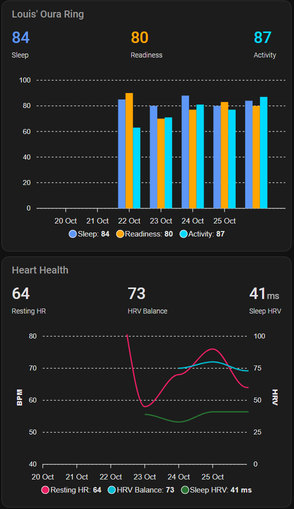

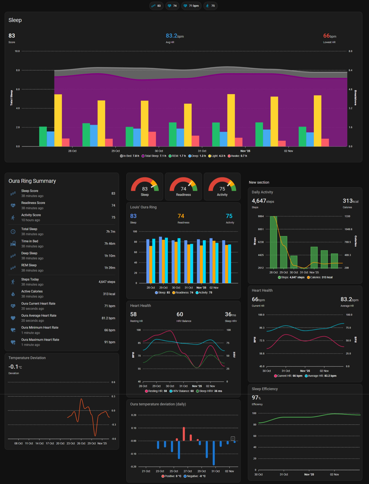

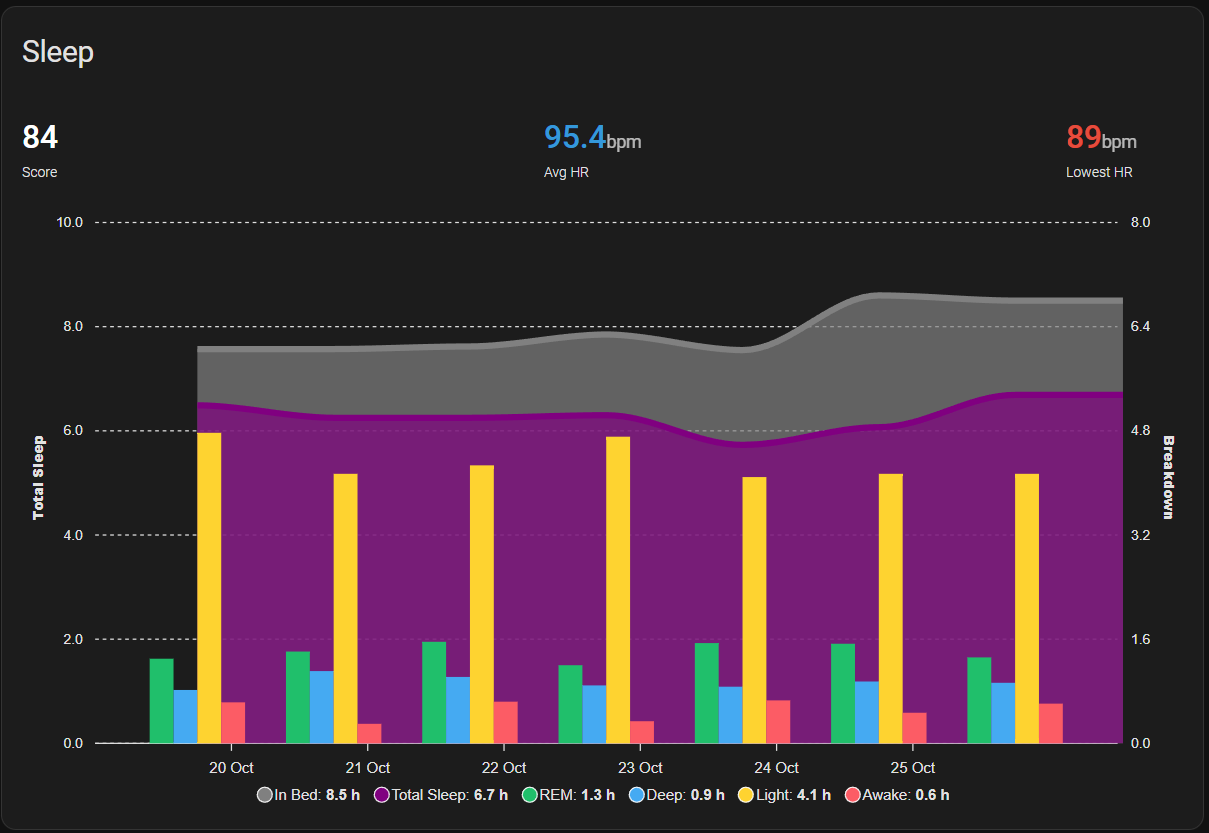

However, could you perhaps provide some screenshots from what your Dashboards are looking like now? Since it has been over a week since you installed the plugin?
Here is my Dashboard as of right now:

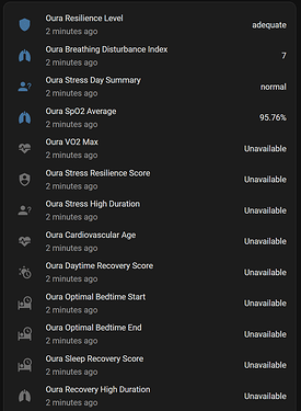

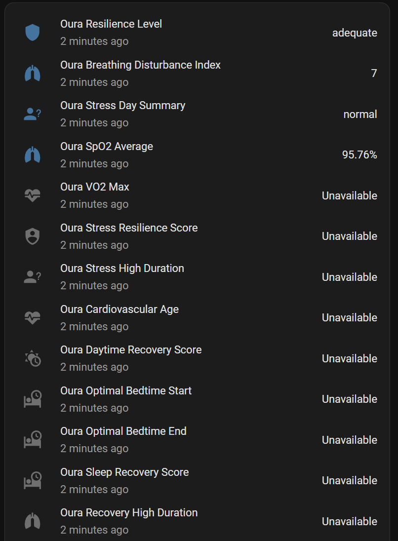

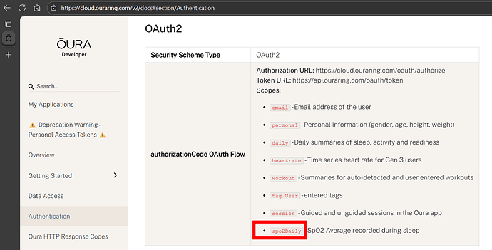

I am working on adding more sensors, like Resilience, SpO2, VO2 Max, Stress etc.:

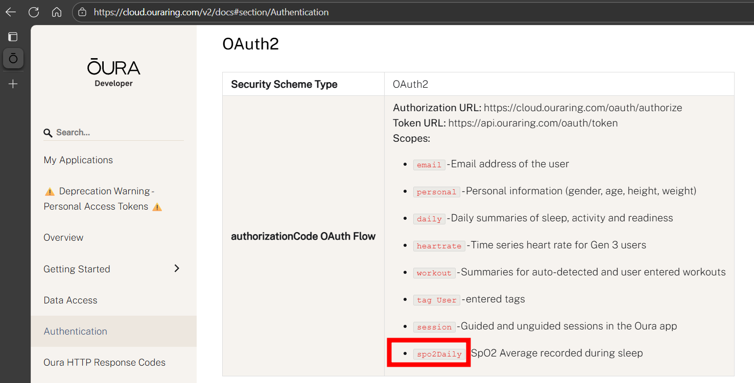

However, the Oura API documentation is definitely out of date and in some cases, just plain wrong:
Look at the Scope for SpO2:
When I use this spo2Daily scope, I get a 401 Unauthorized error
Then I just randomly tried spo2, then I was finally able to get a value back without an Auth error…

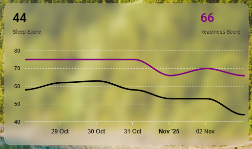

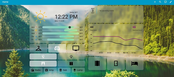

Absolutely, I haven’t set up a full dashboard for all sensors yet, but I’ve implemented a graph that uses a few of them on my main dash that I love.
Don’t mind the misalignment in the bottom, it renders correctly on my wall tablet, but I built this graph using Apex Charts card. It shows a weeks worth of trends for my sleep and readiness score. I do like your idea of displaying light, deep, and REM sleep durations as bar graphs too, so I may find a way to utilize that if space allows.
