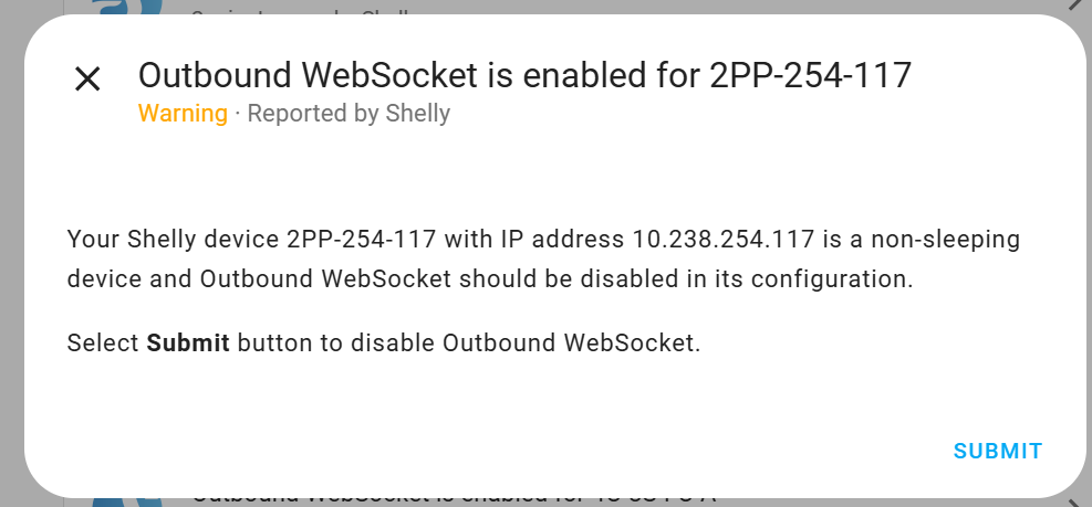

I’ve used the Outbound WebSocket on all my shelly devices to point to my HA installation. My bad, I now know it should’ve been only used on battery Shelly devices that have a sleep mode.
I need to remove that from almost 100 devices. What are the consequences of having the Outbound WebSocket configured on always-on devices?
Thank you!
Hi, you can remove the outbound WebSocket configuration from the devices and after that restart the Shelly integration.
The consequences with websocket connection is a higher network traffic and cpu
