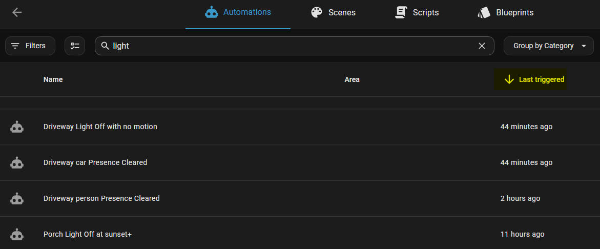

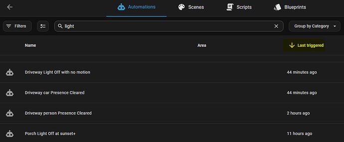

How do you normally control the Living Room lights? If it’s an automation or script, look at when it was last triggered.
Also, if an automation is triggered by the floods, check that last triggered time as well.
