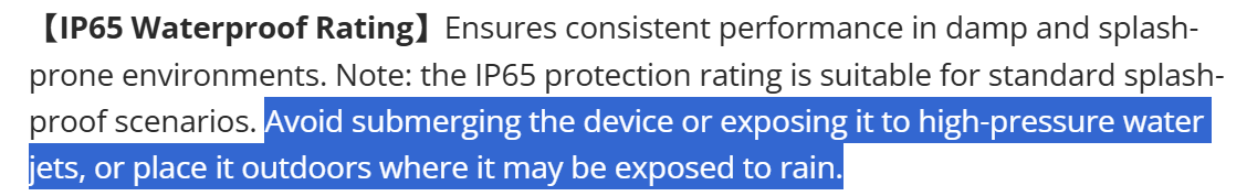

Not sure why they would classify it as IP65 (which should withstand water from any direction), then say it's not suited for outdoor rain in the product page :man_shrugging::
I have a feeling this is more meant for bathrooms where high humidity is an issue, but if you already have one and you're happy with it enough to get 8 more, then I hope I'm wrong.
Most should be fine if placed under a cover like just under a roof awning as the ratings are more for being under constant heavy rain and weather elements.

IP65 doesn't include submerging.
You can place IP65 device under direct rain but you can't place it in flood-prone areas or where water can collect
They likely recommended not to place it under rain either for their ignorance or to prevent complains from ignorant users.
