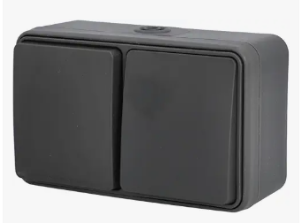

Trying to stuff in a Shelly 1PM inside an outdoor momentary switch or a normal switch that leaves enough room internally to put a Shelly there. And the IP rating has to be at least IP55. USA / EU
Almost all switches you find online don’t show much space they occupy internally for the switch, so I can’t buy simply by size itself.
Can anyone recommend a switch?
(Photo for reference of what i’m looking for)

Another option could be double-one for extra space…
Yeah those double ones could be an option, i just didn’t find any with momentary switch combinations. It’s all normal toggle switch + socket or 2x toggle switch.
