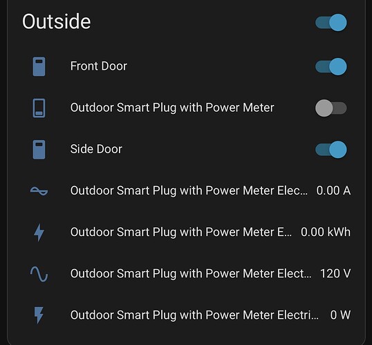

When I installed a plug I use for my sump pump, it listed four items it displays. How can I tuck those somewhere like if i click on the switch, it shows the information there rather than where the devices are?

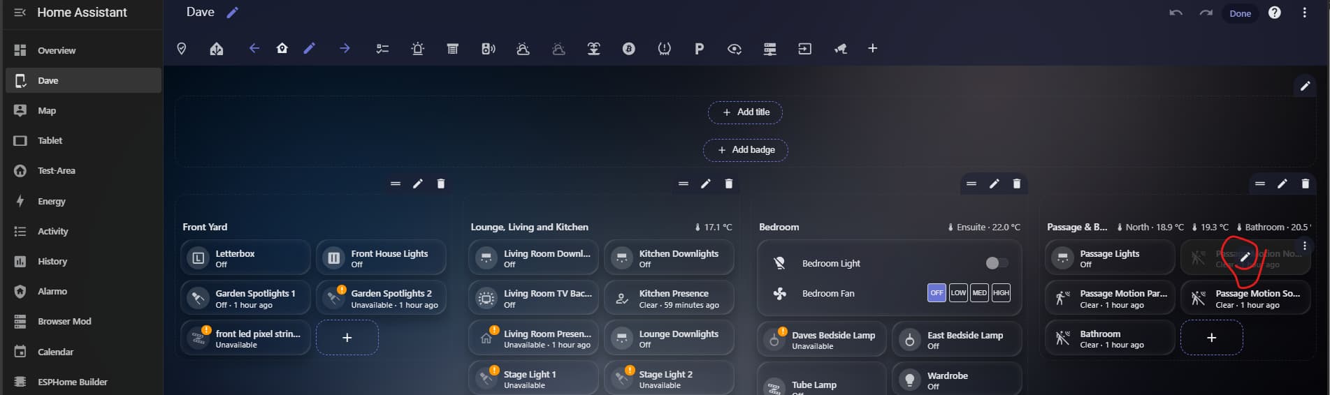

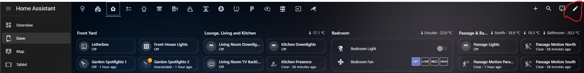

Edit your dashboard:

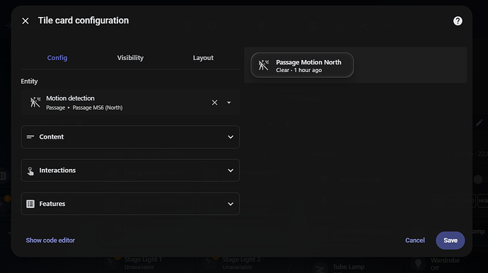

Edit the card:
See what pops up:

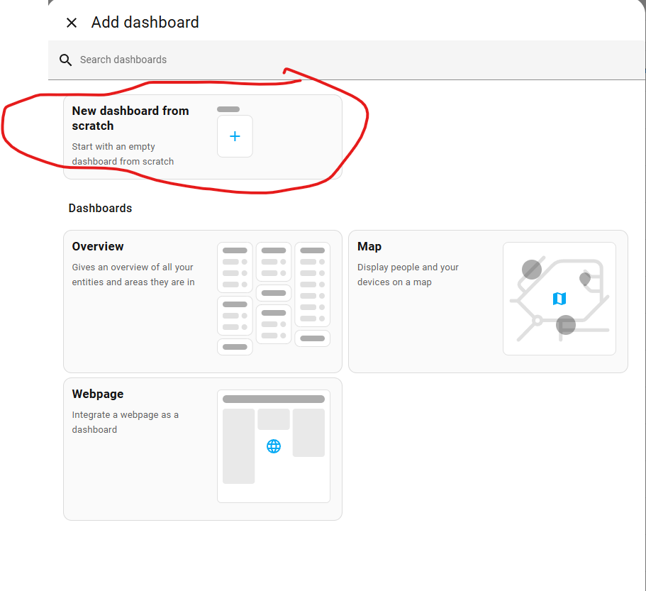

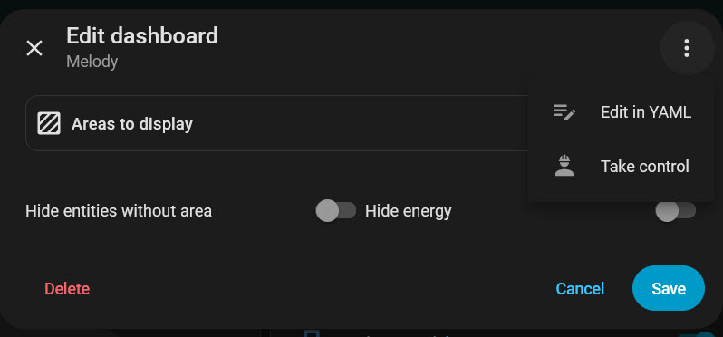

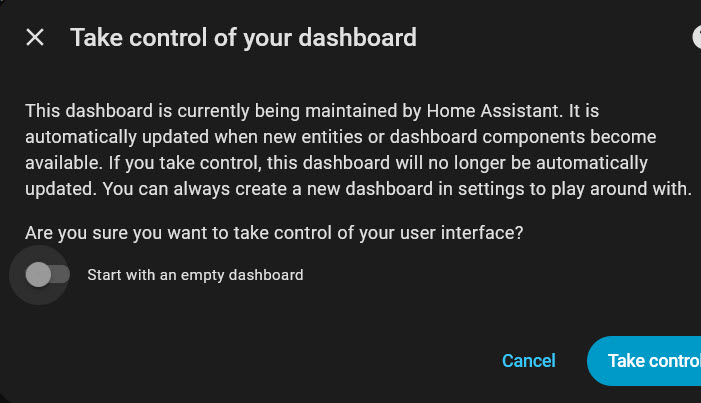

When i go to edit the dashboard I get this? I thought originally I created my own dashboard but it looks like this one now is owned by HA, and I have to take control. Is there a dashboard video?
You did create a dashboard. But, it looks like you created an Overview dashboard. You can delete that and create another one. New dashboard from scratch.
Or, flip the Start with an empty dashboard switch and Take control. Easier!
