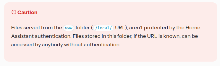

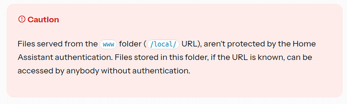

  • I uploaded the converted file(s) via File editor into a subfolder within the ‘www’ folder (Ex. /homeassistant/www/custom_sounds). Once the file(s) were in place, I modified the automation(s) to include the audio files I wanted played. Below is an example of an action that I have setup for reference.
