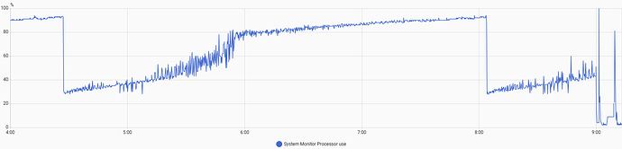

After updating to Home Assistant OS 15.0 the CPU usage sky rocket to 90% also the temp to 72ºCelsius (before the average was 45ºC)

If you still want to search for the root cause:
  • 87% of time spent in user space indicates that its not a kernel issue. It could be a custom component or add-on for example that causes this.
  • The next step would be to ssh into the root OS and look at top, iostat, docker stats outputs. To do that you need to setup HAOS root access. See here how to do that: Debugging the Home Assistant Operating System | Home Assistant Developer Docs
  • It might be enough though to use the add-on “Advanced SSH and Web Terminal” and disable “secure mode” in the add-on. You can then run “docker stats” and check if any of the add-ons are causing the issue.

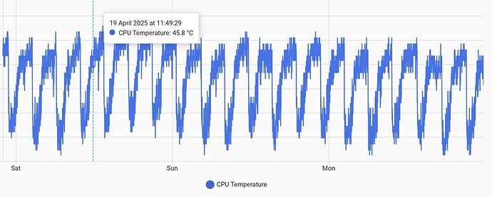

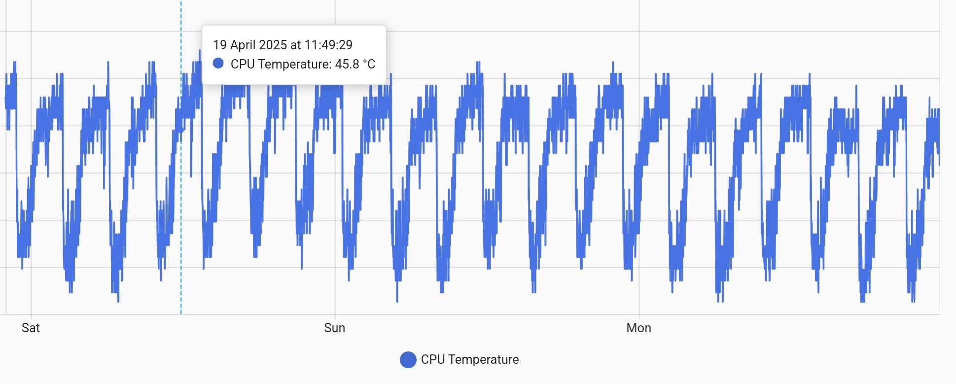

I have a suspicion I am seeing the same thing. Ever since last Thursday it’s (CPU temp) been cycling up and down every 3.5 hours
Will investigate further tomorrow
–EDIT-- I tracked this down. I must have accepted an update to VS Code Server. That was the culprit
For those seeing the same, you will need to restart your PI (In my case) completely, not just HA, after uninstalling this thing
Its amazing, it was such a creeping death.
