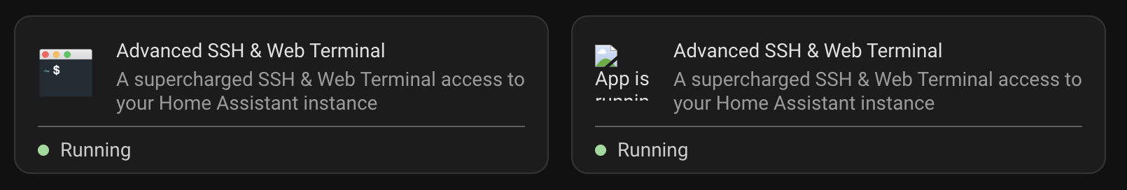

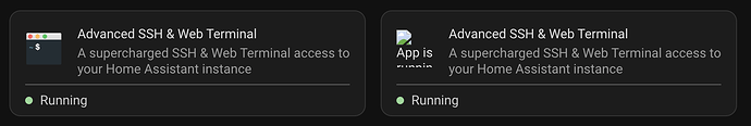

Not quite sure why the logo and icon are not showing up:
I copied them from the repo:
➜  ~ ls -l /addons/ssh
total 480
-rw-r--r--    1 root     root           195 Aug  2 14:32 Dockerfile
-rw-r--r--    1 root     root          1668 Aug  2 14:46 config.yaml
-rw-r--r--    1 root     root        237777 Aug  2 14:34 icon.png
-rw-r--r--    1 root     root        237807 Aug  2 14:35 logo.png
