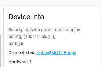

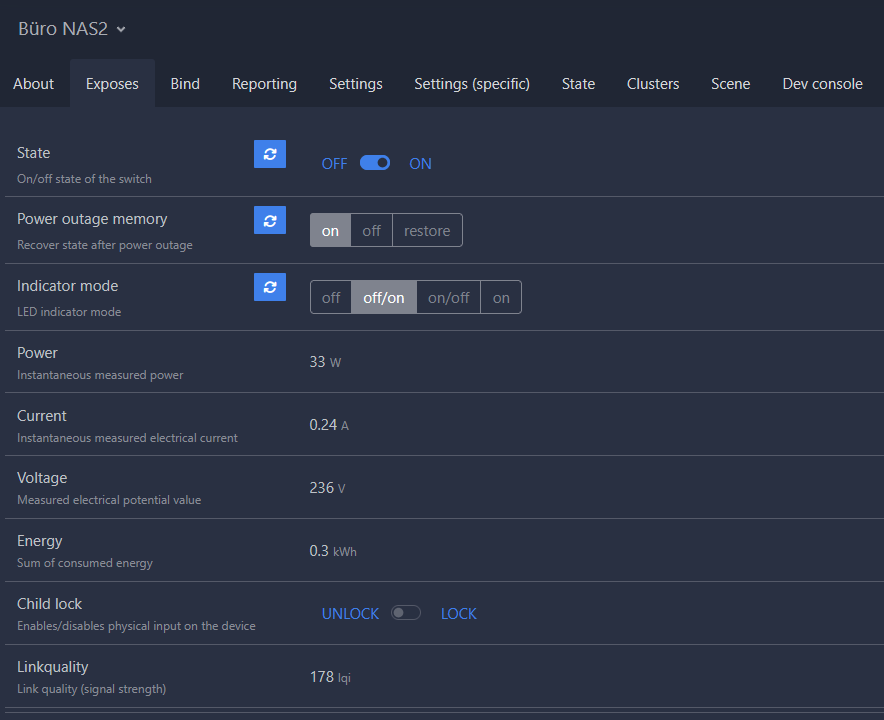

With the latest I have the issue, that it has been paired successfully and shows all values (see screenshot), but when searching e.g. “NAS2” in devices or entities in Home Assistant it doesn’t find anything. The same for the developer tools/states.

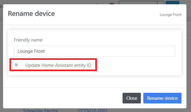

Use the blue edit button bottom left of that page or on the main devices list to rename the device (to something easily searchable) and make sure you have the update home assistant switch on:
See if that updates Home Assistant. If it does then change the name back - making sure you have the switch on again.

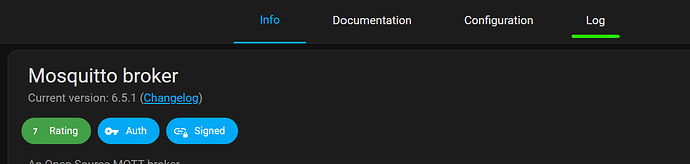

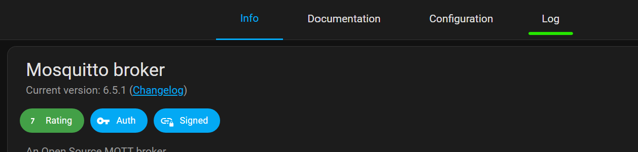

You can also check the Mosquitto Broker logs to ensure the broker is communicating to MQTT
I had the option tagged, when renaming when device. Didn’t solve the issue.
Regarding the Mosquito Broker Log. All my Zigbee → Z2M → HA automations are working, so I guess, the communication must be ok/working.

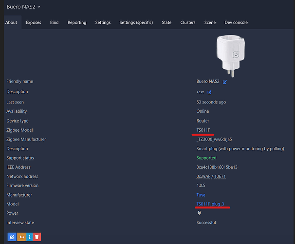

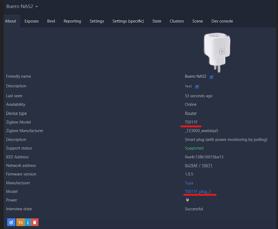

You are on a troubled device firmware(v1.0.5). Using Z2M, see if the OTA update works.

I did, here is the Z2M log of the renaming process. According to Z2M it was ok:
info 2025-06-13 07:04:51z2m:mqtt: MQTT publish: topic 'zigbee2mqtt/bridge/response/device/rename', payload '{"data":{"from":"Buero NAS2","homeassistant_rename":true,"to":"AAAAA"},"status":"ok","transaction":"4bpij-1"}'
info 2025-06-13 07:04:51z2m:mqtt: MQTT publish: topic 'zigbee2mqtt/AAAAA/availability', payload '{"state":"online"}'

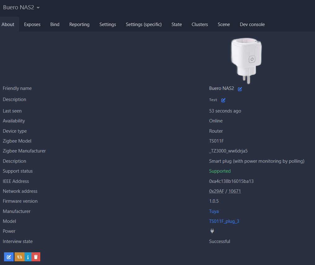

Regarding the firmware. The other (working) devices show the same firmware version 1.0.5. On the OTA check Firmware Version installed and available is shown: 1.0.01-3.6.07 (for the other devices of the same type as well). So I think the firmware version should be fine.

Broken attribute reporting functionality
Starting with firmware version 1.0.5 (which comes pre-flashed on plugs produced since Q4 2021) core functionality on this plug is broken. TuYa has disabled the automatic reporting of power, voltage and current values meaning they need to be polled instead. The poll interval can be controlled through the measurement_poll_interval option.
If your plug is affected, it will be detected as TS011F_plug_3 instead of TS011F_plug_1
Directly from Z2M
Even if measurement_poll_interval not set, it should be discovered.
I do agree, but it is a Tuya device. If the Tuya bridge was used, I suspect it would be discovered by HA.

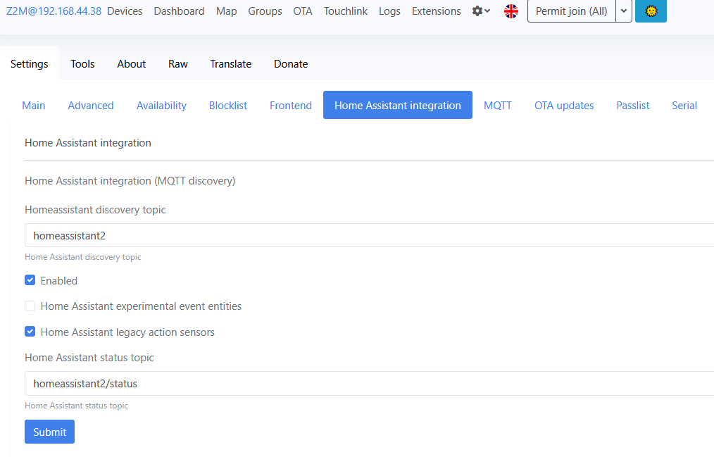

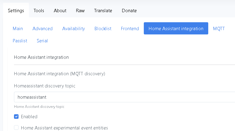

So here is the HA integration setting. It’s enabled. Not sure why there is “homeassistant2”. However, Z2M/HA integration is working, I added yesterday three other devices (one was the exact the same socket which came with the same delivery) without a problem.

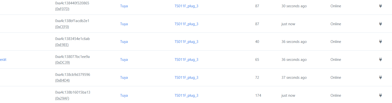

Here you can see the other devices I have. They are working fine. So I still believe it’s not a problem with the firmware?

Change discovery topic to homeassistant. It should work
i tried but get this error:
<small>2025-06-13 08:21:14</small>`z2m: Request 'zigbee2mqtt/bridge/request/options' failed with error: 'Extension with name HomeAssistant already present'`
