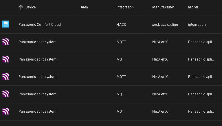

Tom, I also found something interesting. If I navigate to Settings, Devices & Services, select Devices and filter for "panasonic", I see a new entry:
The Panasonic Comfort Cloud device is new in my experience. Not only that, It has an entry for the Living Room A/C unit, and is clearly connected and showing live data.
You should be reporting this to the custom integration developer in your issue. Or you may get some help from other user's of the integration in this topic:
