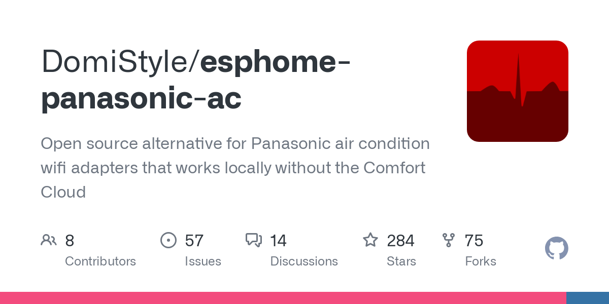

I guess this local integration still works:

Yes,

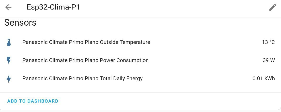

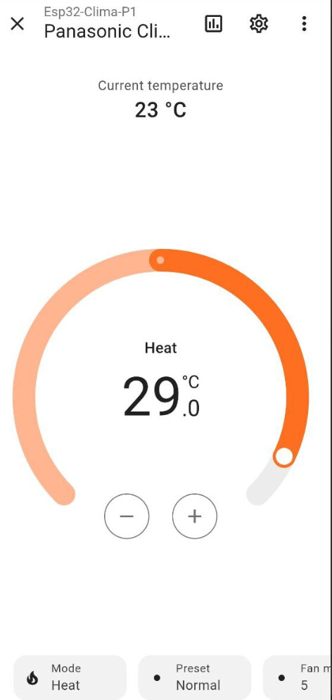

I confirm that I built it and it works perfectly, my air conditioner is a ducted system

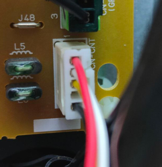

I have also put together 3 of the “Ingenious Makers P11” boards for my units at home (indoor unit type CS-TZ35WKEW + 2x CS-TZ15WKEW).
They already come with a WLAN dongle, but I plugged the modules into the CNT port and they work together without issue.
Some things to beware of:
The PCB linked on their site has a flaw: The temperature sensor’s data line is not connected to any of the IO pins of the ES32, so without a bodge wire, it cannot be used. I used a small piece of wire to connect the correct side of the resistor to pin 8, and it works.
If you want to solder the module directly to the pins on the board (and not use female headers) beware of interference from the cap with the USB-C port.
The wifi reception on these modules can act difficult, but so far it seems that once they are connected, it is stable.
