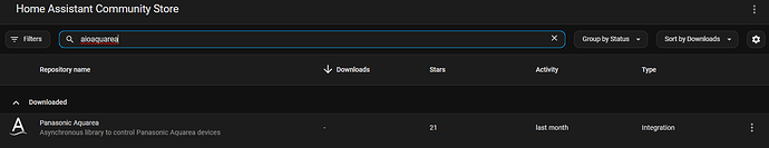

Just search for “aioaquarea” in HACS, this will be the only option returned.
If it does not show up, you may need to add it as a custom repository - there are several YouTube videos on how to do it.

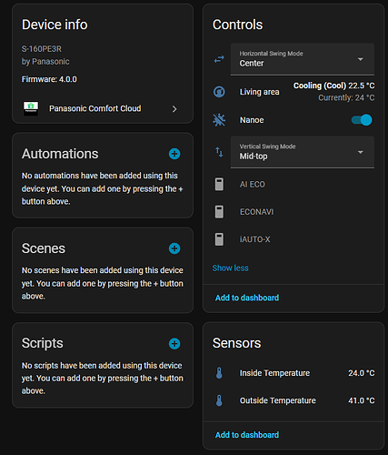

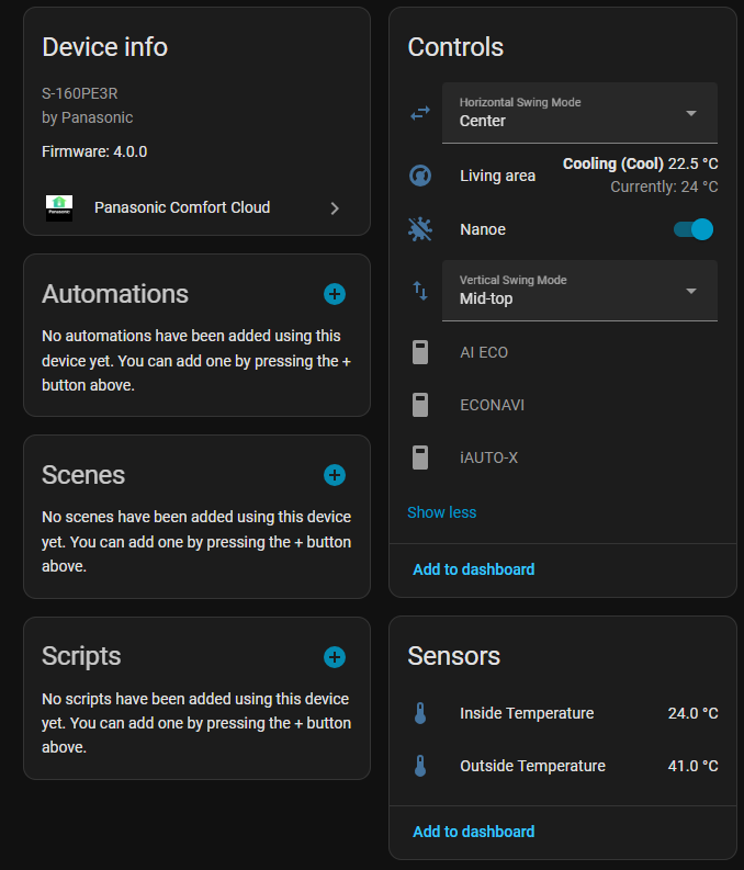

Hi! I just started Home Assistant and added my Panasonic aircon via your integration. I entered my Panasonic CC login credentials and ticked “Enable daily energy sensors” but I still don’t see the energy/power sensors. Need your help please on what to do next.

Workaround until the fix is merged: Edit custom_components/panasonic_cc/const.py and change DEFAULT_ENABLE_DAILY_ENERGY_SENSOR = False to True, then restart HA. Note: this will be reset if you update the integration via HACS.
If your energy sensors aren’t showing up even though you ticked the checkbox during setup, I’ve submitted a fix: https://github.com/sockless-coding/panasonic_cc/pull/448
This also fixes the 500 error when clicking the Configure button.
Check if your devices have energy measurements in the app. If so check the fix and workaround I have posted
Hey! Thanks for sharing the workaround. I followed it and it's now showing these sensors: sensor.daily_cooling_energy, sensor.daily_energy, sensor.cooling_extrapolated_power, sensor.current_extrapolated_power, sensor.daily_heating_energy, sensor.heating_extrapolated_power. Extrapolated power sensors have unavailable states while cooling energy now shows values/numbers. Also, 500 error is still not fixed on my end.
