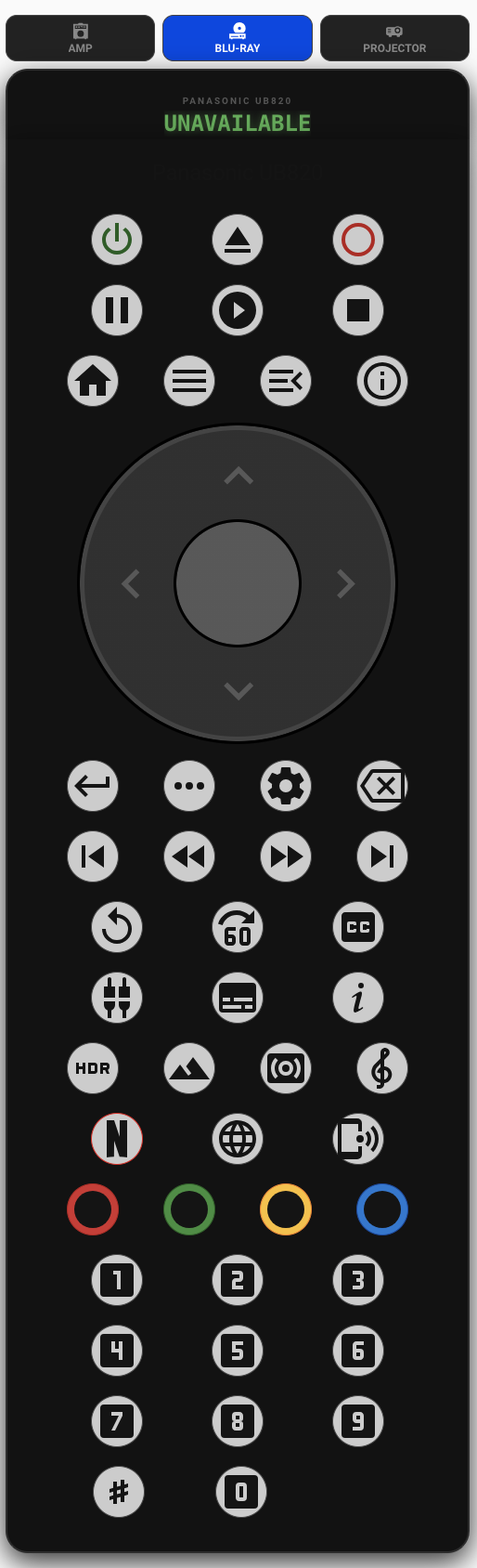

I’m happy to share the first version of my custom integration for Panasonic UB series Bluray players (eg. UB820, UB9000).
I know that some integrations already exists, but I found they missed some of the available commands or lacked the possibility to enable/disable authentication.
Since not everyone runs a hacked firmware to remove the authentication, I thought that this could be helpful to other people like me.
The “Secret” key is not easily available online, but can be obtained.
I also included the YAML used to build a “virtual remote” using universal-remote-card and button-card.
Here’s the Github repo, feel free to test the integration:
https://github.com/matteoraf/ha-panasonic_ub
Feedback and contributors are more than welcome!
