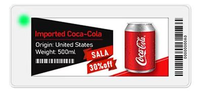

Confirmed working product and more detailed information:
The label I tested is a 2.13" e-paper display, with 256x128 resolution and three colors: white, black, and red.
There are already other Home Assistant integrations for other ESL / e-paper labels, but these devices don’t all use one shared standard. Different brands often use different protocols, so this integration is specifically for the PANDA / ETAG BLE labels that advertise as ETAG-*.
