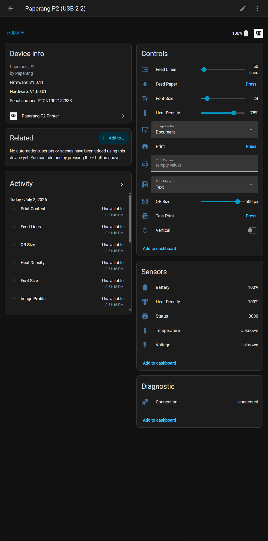

:control_knobs: Interactive Device Page
All controls live right on the device page — no YAML editing needed:
Control Type What It Does
Print Mode dropdown text / image / QR / pickup code
Print Content text input what to print
Font Size slider (12–96) text size
Heat Density slider (0–100%) print darkness
QR Size slider (100–576px) QR code dimensions
Image Profile dropdown portrait / landscape / document / high_contrast / light
Vertical toggle rotate 90° for vertical printing
Feed Lines slider paper advance
:bar_chart: 6 Real-Time Sensors
Sensor Unit
Battery %
Status diagnostic code
Voltage mV
Temperature °C
Heat Density %
Connection connected/disconnected
Static info (model, firmware, board version, serial number) shows on the device card.

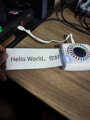

# Print morning weather
service: paperang.print_text
  text: |
    🌤️ Good morning!
    Today: {{ states('weather.home') }}
    High: {{ state_attr('weather.home', 'temperature') }}°C
  font_size: 20
  heat_density: 60

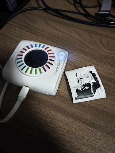

paperang.print_image Camera snapshots, floor plans, memes

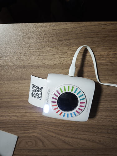

paperang.print_qr WiFi credentials, URLs, home automation shortcuts

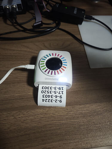

paperang.print_pickup_code Package locker codes — big, bold, readable

Print Pickup Code When Package Arrives
automation:
  - alias: "Print Pickup Code on Delivery"
    trigger:
      - platform: state
        entity_id: sensor.package_delivery
    action:
      - service: paperang.print_pickup_code
          pickup_code: "{{ states('input_text.pickup_code') }}"
