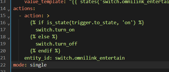

I’m not sure how the forum parser will display this, but to be safe here is a screenshot of the last block in the HA yaml interface, where you can see the entity_id color is confused with the preceding multiline jinja block.
Confusingly, if I save and reopen this automation then HA changes my folded style > to a literal | – why does it do that, is that just part of how it works?
Anyway, just checking whether I’m not doing anything wrong. Any comments on whether the code should be improved would also be appreciated.
