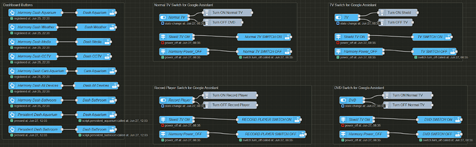

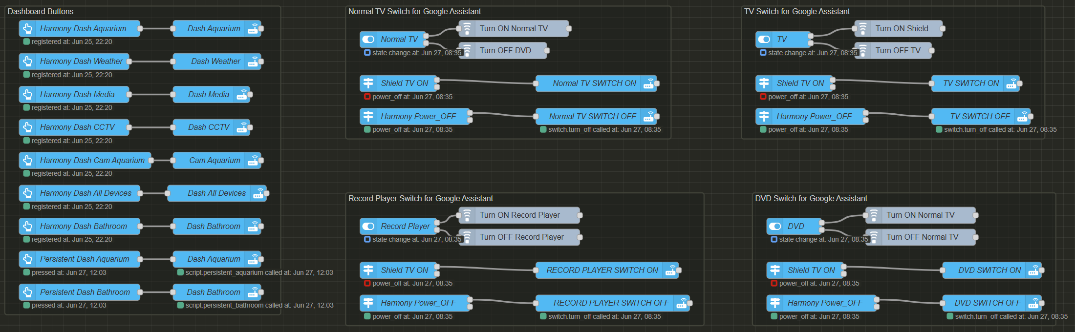

I setup switches and buttons that I expose to Google Assistant.
I can then use a voice command to activate the switch and trigger node red flow, you could also trigger HA Automations.
When adding a switch you can add it to a Google Home App dashboard. Buttons are exposed but cannot be seen or added to a dashboard. Google Assistant can see them but not physically available to add as a UI element in Google Home.
Setting the voice commands within Google Home for that particular switch is what points Google Assistant to that device.
The triggers you see below for DVD etc. Is maintaining the Switch State in Google Home.
I only expose the few entities I want Google Assistant to control through voice, otherwise it makes a mess of the devices to add to rooms in Google Home.

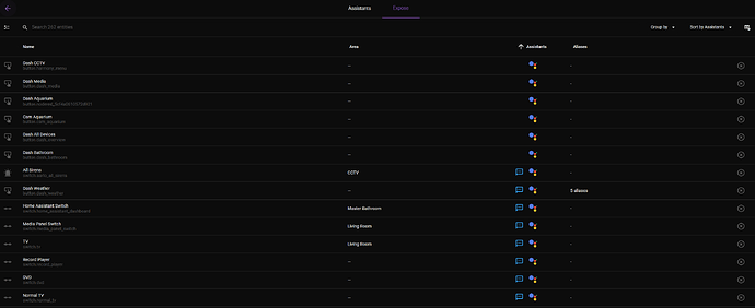

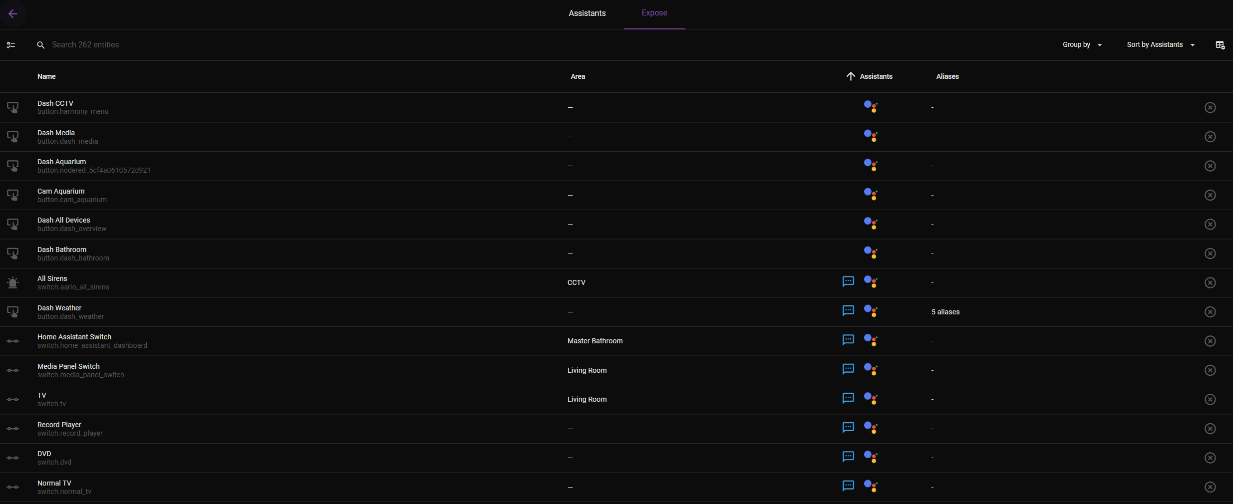

What/where is this screen? With Assitants/Expose tabs? I’ve never seen this before.
Settings> Voice Assistants> Click in the top menu Exposes>

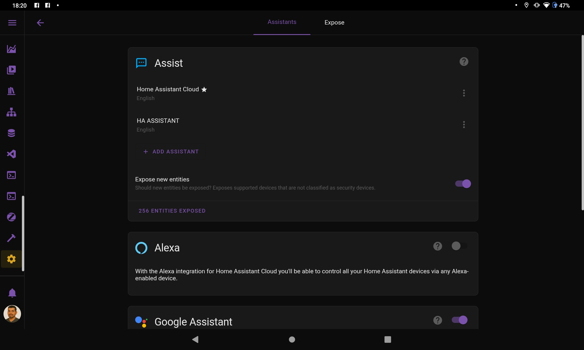

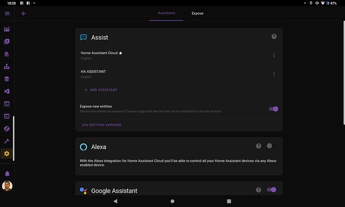

How are you getting multiple assistants assigned
You have to add the assistants first. I use NabuCasa paid.
