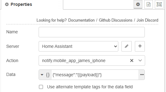

Is there a way to pass notify entities to an Action Node? I’m working on some alarm system code, and want to use a function node to pass the “recipient” to the Action Node (or a different node, if that’ll make it work).
For instance, in the image below, I want to pass in mobile_app_james_iphone via json, if that makes sense…
Thanks!!

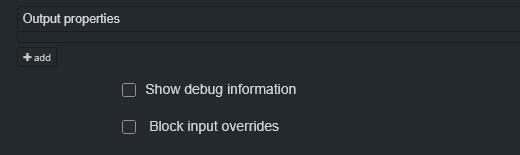

You can send a JSON object with the full config of the node. Make sure the box to block input overrides is unchecked in the action node.

Message needs to be in the data section but i believe the block input override is still checked.

If it is unchecked and you still get the error, delete that action node and pull a new one out to the workspace.

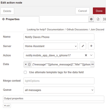

Here’s the way I do it. Absolutely no claim that is this the best way, or even a good way :slight_smile:

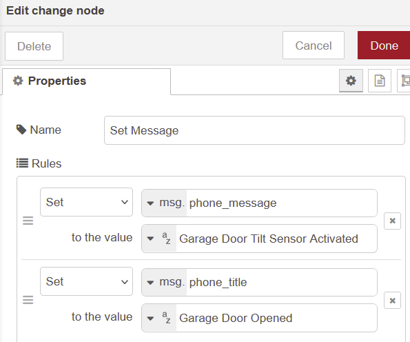

First, I set the message and title (heading) properties I want:
(Note: The variable names (eg “phone_message”) can be anything you want)

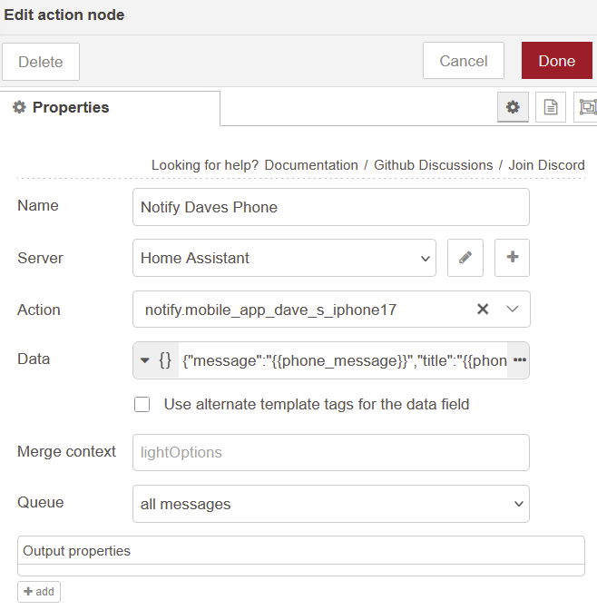

This info is passed to an Action Node:

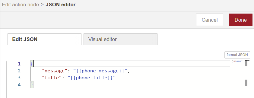

And this is the layout of the Data section of that Action Node:
