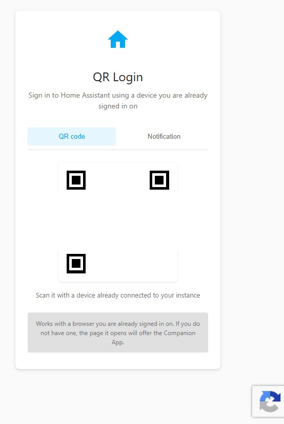

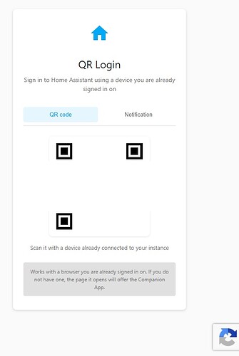

QR code — the page shows a QR code. Scan it with any device. The approval
page works out how to authenticate you: a browser with an existing Home
Assistant session shows the request straight away, the Companion App
authenticates through its native bridge, and a browser with no session is
offered the app or a normal login instead of a dead end.

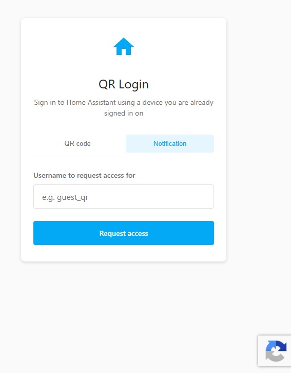

Push notification — you type the username you’re requesting access for. If
it matches a configured mapping, an actionable notification goes to the
approving device with Approve / Reject buttons. Nothing else to open.
