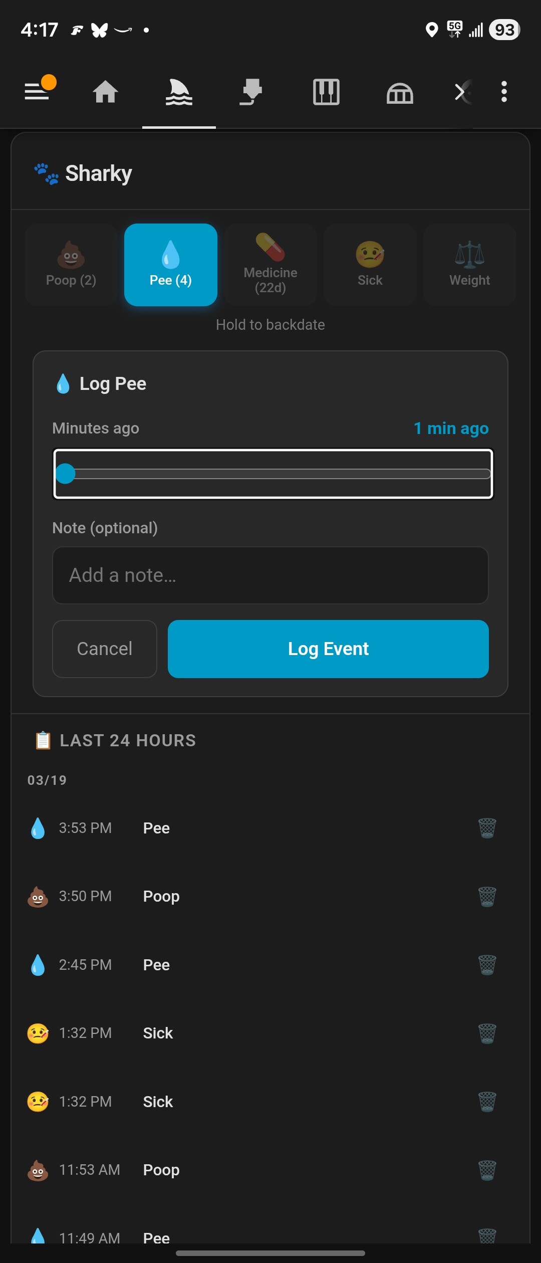

  • Quick-log buttons — tap to log instantly, hold to backdate

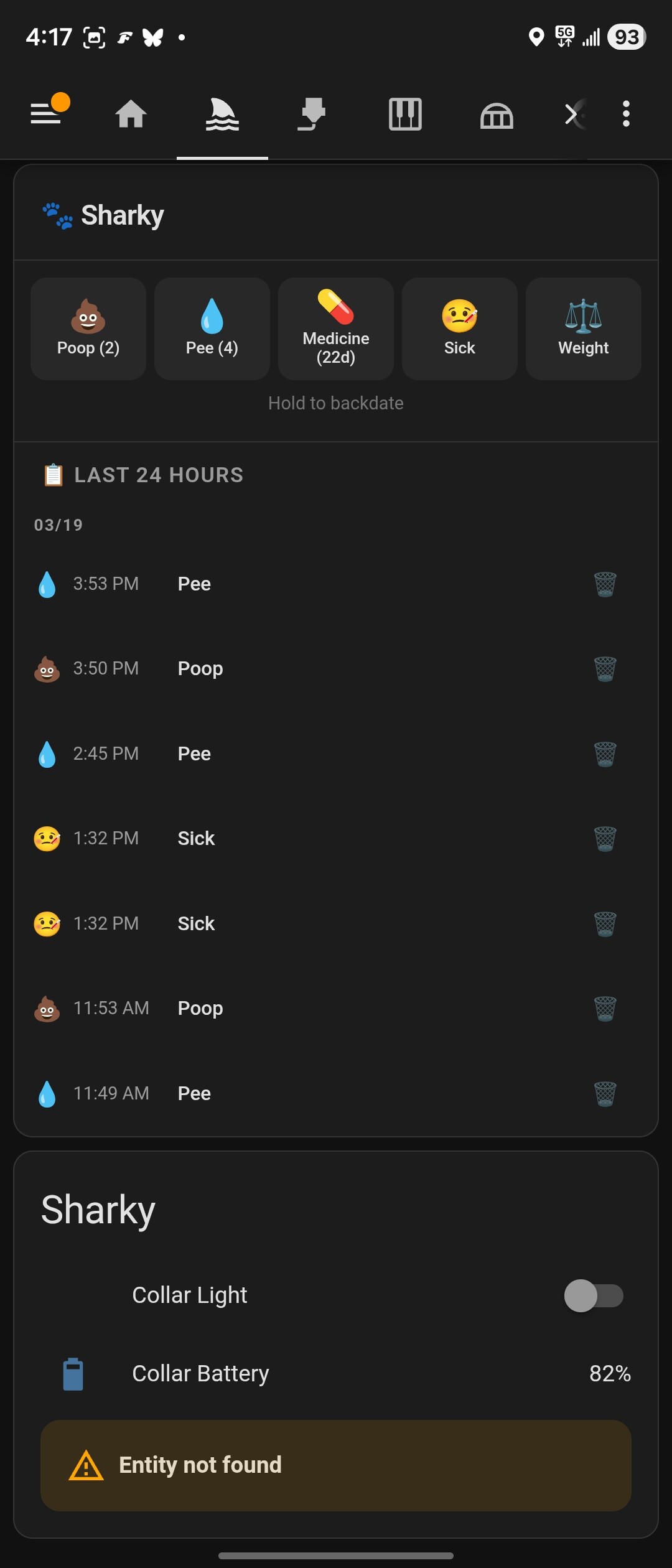

  • 24-hour timeline with inline delete

Use custom:pawsistant-card for the version with the log. Or do you mean you want the compact version to have a popup log of some kind?
Yes, I'd like to use a compact card (only buttons) and expand it to a bigger one for ckecking the log.

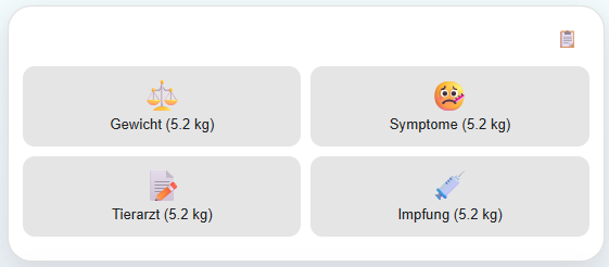

I added a weight today and it is shown on every button. Is this intended behavior ?
Definitely not intended! I've published v2.20.0b2 which I hope fixes this. Please let me know and thanks for the bug report
v2.20.0b2 fixed it, thanks.
