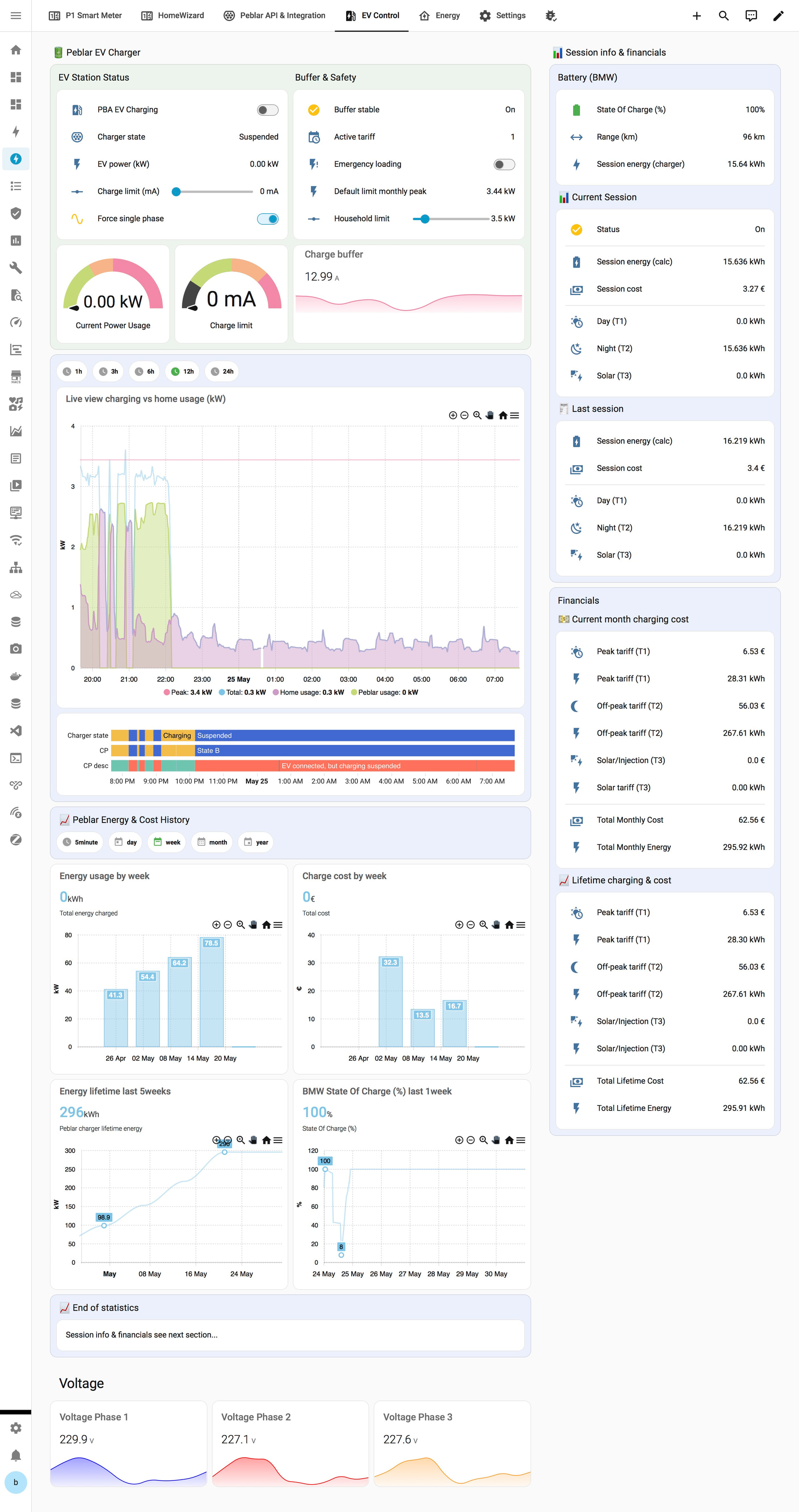

Got my Peblar Business installed as well last month. Good looking, local (no cloud bullshit and subscriptions), best value for money, full functionality…. Default integration not covering 100% functionality and management in HA but using it together with this API integration every single topic needed covered. 100% scheduling and load balancing (keeping track of capacity tariff in Belgium) from within HA.
What kinda functionality is missing?

Hi, with your input (code) in your topic, I managed (with some help from AI) to make an automation en script that returns the actual RFID, Starttime, StopTime and Sessionnumber in a few helpers.
With this helpers you can start other automations
@Rklootwijk Got it working
