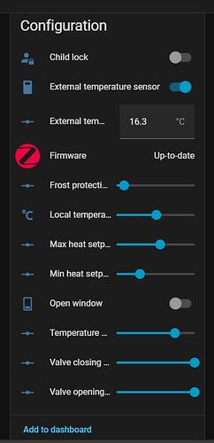

Well, i did some testing: I connected my spare zb gateway and spare trv to my test HA via zb2mqtt.
  • i selected “external” on my sensor “select.trv_temperature_sensor_select”
  • i created an automation which sends fixed number “23.9” to “number.name_external_temperature_input” every full hour.
I created automation at 8:29, first send was at 9:00, then at 10:00, then last at 11:00 (so that’s 3 hours+ of not changing a value). If i’m looking at correct sensor (that’s select.trv_temperature_sensor_select) then this sensor is still at “external”. Am i looking at the wrong sensor? Which one should jump to internal_2 (or _3)?
Well, to tell my results of above test:
  • as long as i’ve had my automation enabled sensor remained at “external”. Note that i’ve sent fixed (exactly same) number every hour, so number definitely didn’t change.
  • then i disabled automation and after 2 hours sensor jumepd to “external_2”
  • after re-enabling automation sensor immediately jumped to “external_3”
So, after all i guess there’s no bug in trv. It must be your automation working …well, wrong ?.

Have you tried using ZHA recently, instead of Z2M ?
I haven’t had any issues using ZHA, once I became aware of the External sensor dropping back to Internal, if it doesn’t get updates at least every two hours.
Using TRVZ 1.4.1 exposes open/close %, if you need it…
Might be easier than introducing more Sonoff hardware?
Also does it whenever you change the batteries. I now have an automation that checks for this and switches it back on!

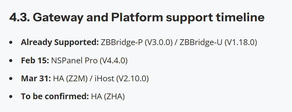

Have you heard that there is now firmware 1.4.4 (already released to eWelink hub users, hopefully soon to Z2M) which should add adaptive mode.

Did anyone “received” firmware update in zha mode yet? I have one test valve in z2m, that one updated, but 3 valves in zha mode didn’t receive fw update information yet, it still says “updated”…

Not even confirmed :rofl:
I received the update on Z2M, but Z2M support is coming later.
Funny (or not) that page listed initially ZHA support coming earlier than Z2M, but it’s been updated to the current “To be confirmed”
What I’ve read about the 1.4.4 from eWeLink forums it’s not silver bullet solution.
I’ve had Better Thermostat Beta version’s PID for some time now and it manages to maintain the same hysteresis as plain 0-100 valve actuation did. Which is no surprise in my case as the temperature sensor’s accuracy is now the limit. But it’s nice to hear the valve move only slightly. Although now it moves slighly more often so I don’t know if this has any effect on battery life :slight_smile:
