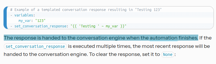

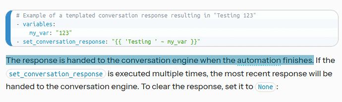

Interesting, I was thinking about running a script but not like this script.turn_on
Nullify the response by setting it to "" and add a TTS action to give the desired response.
set_conversation_response:
I tried "" and None. Assist would stuck in responding state.
EDIT: method with external script works! Thanks! :tada:
