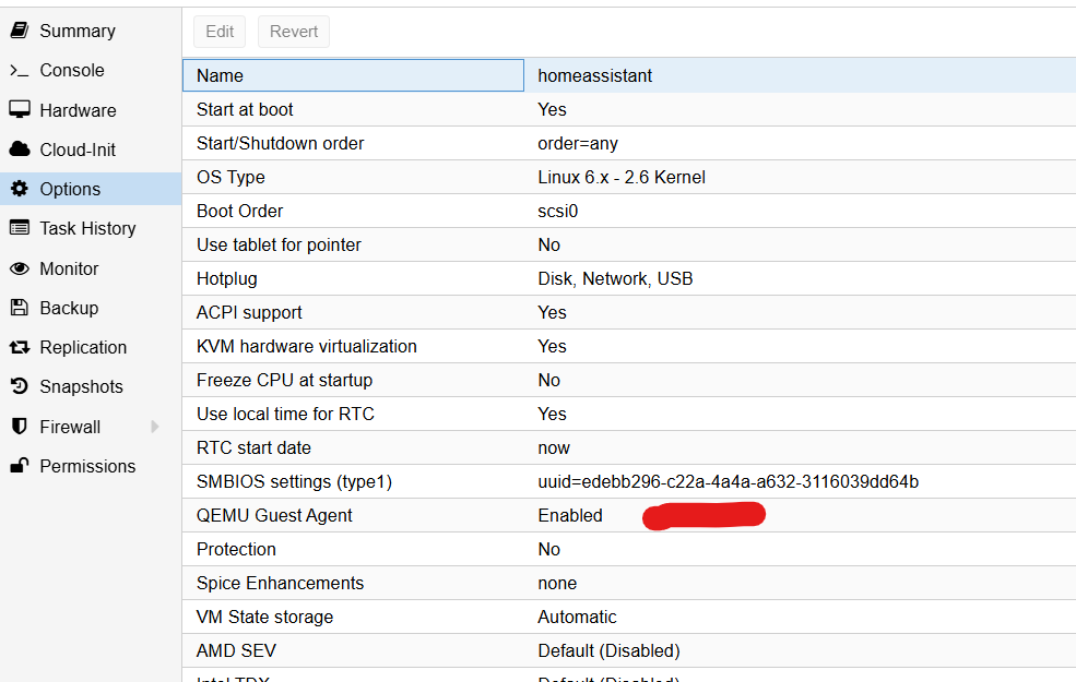

If you are running the db externally you could try disabling the qemu agent:

I will indeed try to disable the qemu-agent in the hope that this solves my issue without creating new problems.
Edit: Disabling qemu-agent seems to do the trick, @fleskefjes - thank you!

Summary:
Disabling qemu-agent seems to do the trick.
The freeze-thaw spam is completely gone.
