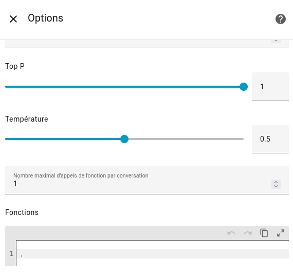

  • Custom LLM API Agents: select only “Enable LLM Agent”
  • I’m using only instructions_prompt
  • other prompts can not be empty so I used “.”
This setup is for chat and it’s working. I did not test if sonar is able to control “Assist”.

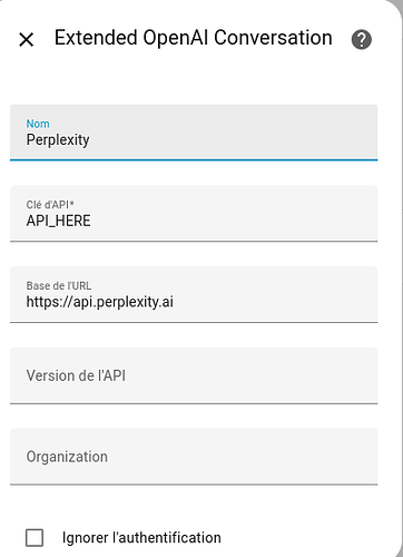

I tried to follow your instruction but I’m getting an error message when I try to chat with the assistant. Can you explain some of the steps like I’m 5? I’d really appreciate that. lol
First I had to set up an API group in perplexity in order to get an API key.
I installed the custom hacs integration extended_openai_conversation
When adding a new entry, i get the pic that I posted above.
API key is fine
Base url is fine
API version ? I’m guessing sonar or sonar-pro.
Do you check the ignore auth box?
After, I can configure the entry, theres a bunch of options
When I add a new assistant, sending any message result in an error.
