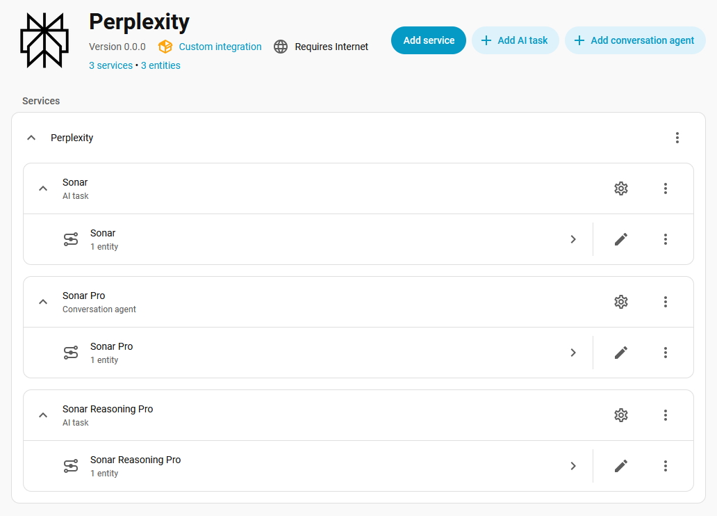

To configure integration in Home Assistant, go to Settings >> Devices & services >> Add integration >> Perplexity or use My Home Assistant link.
Open your Home Assistant instance and start setting up a new integration.
To generate API key go to https://www.perplexity.ai/account/api/keys
