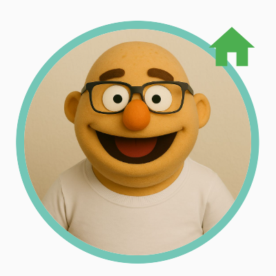

Finally happy enough to show mine.
It’s heavily based on some of the cards in this topic but with some changes.
The profile picture changes based on a calendar so for different holidays we have a different profile picture i.e. Halloween or Christmas etc…
Also when it’s someone’s birthday the profilepicture changes.
Then the icon changes based on location zones.
Against all expection chatgpt was a great help with this but it took some time to get all the errors out of it that it kept creating.
Also it takes the person.name entity and uses that for everything so you don’t have to specify entities and paths everywhere.

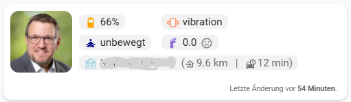

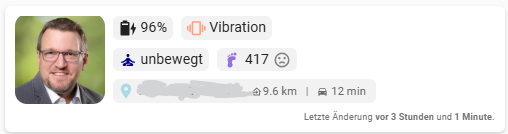

I have constructed my own person card with the help of Google Gemini. This worked reasonably well (with some trial & error). I guess, some of the coding is overly complicated… but, Tbh, I would not have been able to do this fairly complex programming on my own…
What still doesn’t work: zone-specific avatar pictures, on_tap action for the different items (i.e. show a map if I click on the avatar picture). So, any help is appreciated!

Mhkay, I have now completely and manually overhauled the card.
It bugged me out that I was not able to define seperate on_tap actions for the various bits of information. As far as I understood, the button-card only allows one such action for the whole button. Therefore, I have divided the one button with all information into vertical and horizontal stacks of custom buttons for each bit of information. The on_tap action opens the details-page of each entity.
However, I don’t like that the custom-data always aligns to the right of the button. I had to shrink the button-container to counter that… but this way, the grid gets destroyed… any Ideas on how to align the button content to the left?
For the daily steps counter, I now make use of the utility-meter integration that calculates the daily steps and resets the counter every night. Because my smartphone only counts the steps since it’s last reboot:
I added this to my configuration.yaml:
utility_meter:
  mario_daily_steps:
    source: sensor.mario_smartphone_steps_sensor
    cycle: daily
Also, I have removed some AI-generated gibberish code regarding zone-specific Avatars and the automatic fetching of the zone-icon… these parts unfortunately still don’t work… any ideas??

So, I have found a way to automatically retrieve the icon from the current zone by browsing all the zone-entities and match their friendly-name against the person-state… This is the code:
      const personState = states["person.xxxxxx"];
      let zoneIcon = 'mdi:map-marker';
      let zoneIconColor = 'lightblue';
      let zoneName = personState.state;
    // Durchlaufe alle Entities, die als Zone definiert sind (entity_id beginnt mit "zone.")
    Object.keys(states).forEach(entityId => {
      if (entityId.startsWith("zone.")) {
        const zone = states[entityId];
        if (zone.attributes && zone.attributes.friendly_name === zoneName) {
          zoneIcon = zone.attributes.icon || zoneIcon;
      if (personState.state === 'not_home') {
        zoneIcon = 'mdi:home-export-outline';
        zoneIconColor = 'dimgray';
        zoneName = 'unterwegs';
Embed code is live for Ventusky btw.

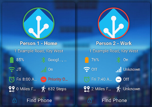

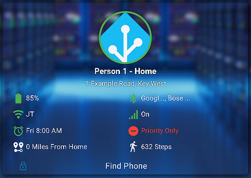

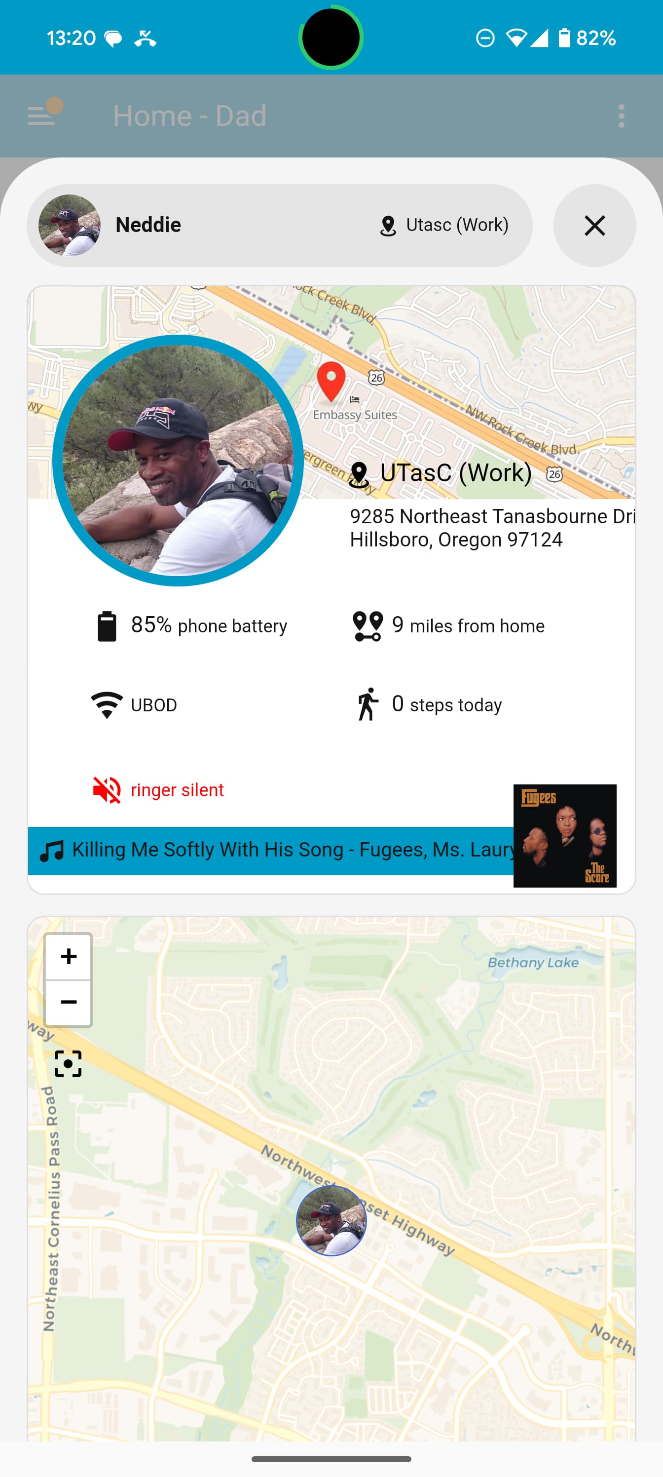

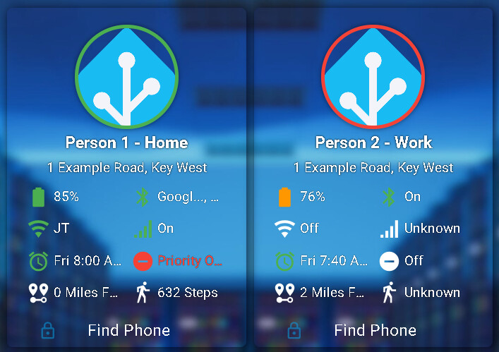

Hi Everyone!
I wanted to share the 1,000,000,000th iteration of my custom “Person Card” that I am using.
I am using the HTML-Jinja2-Template custom card because I find it easier to work in CSS/HTML than I do in the custom button card or picture elements card, and it is much more flexible.
The card pulls in a bunch of info from the mobile app integration (location, battery, WiFi, bluetooth, steps, etc.) and is pretty responsive to different display sizes, so it works great on both desktop and mobile, at least for me.
Obviously, you would need to replace all the entities below, both in the entities: and in the HTML code.
Disclaimer: I built this with the assistance of generative AI (ChatGPT and Github CoPilot). There may be unused and/or redundant code and it may not work for you at all.
Screenshots
Requirements:
  • Card: HTML-Jinja2-Template-card
  • Integration: Mobile App
  • Optional-ish (if you tweak the code to remove the parts that use these)
    • Custom stack-in-card – for stacking cards nicely
    • card-mod – for some visual tweaks
    • Google Travel Time Integration for distance from home
    • For the Find Phone button (because I couldn’t figure out to do it with the HTML template card)
      Custom button-card - For the Find Phone button
      Custom restriction-card - if you want to lock the Find Phone button so that it requires 2 clicks, useful on mobile to prevent accidental activations
      – a script that calls some service to locate your device. I use Home Assistant’s Mobile App to unmute / set volume then play a notification sound
Theme
Code
type: custom:stack-in-card
mode: vertical
cards:
  - type: grid
    square: false
    columns: 1
    cards:
      - type: custom:html-template-card
        title: ""
        ignore_line_breaks: true
        entities:
          - person.joel
          - sensor.joels_location
          - binary_sensor.joels_phone_is_charging
          - sensor.joels_phone_battery_level
          - binary_sensor.joels_phone_wifi_state
          - sensor.joels_phone_wifi_connection
          - binary_sensor.joels_phone_bluetooth_state
          - sensor.joels_phone_bluetooth_connection
          - binary_sensor.joels_phone_mobile_data
          - binary_sensor.joels_phone_android_auto
          - sensor.home_joel_distance
          - sensor.joels_phone_do_not_disturb_sensor
          - sensor.joels_phone_next_alarm
          - sensor.joels_phone_steps
          - script.find_joels_phone
        content: |
          <style>
             ha-card {
              padding-bottom: 0px !important;
            .device-card {
              display: grid;
              grid-template-columns: repeat(2, 1fr);
              grid-template-rows: auto auto auto auto auto auto;
              gap: 0.25em 0.25em;
              padding: 0;
              width: 100%;
              background: none;
              background-size: cover;
              font-family: Roboto, sans-serif;
              color: white;
              box-sizing: border-box;
              padding: 0px !important;
            .profile {
              grid-column: 1 / -1;
              display: flex;
              flex-direction: column;
              align-items: center;
              gap: 0.1em;
              margin-bottom: 0;
              min-width: 0;
              cursor: pointer;
            .profile-pic {
              width: 20vw;
              max-width: 100px;
              height: auto;
              aspect-ratio: 1 / 1;
              border-radius: 50%;
              border: solid 4px white; /* fallback */
              box-shadow: 0 0 5px rgba(0,0,0,0.5);
              background-image: url('/local/ha.png');
              background-position: center;
              transition: border-color 0.3s ease;
            .profile-pic[data-location="home"] {
              border-color: #4caf50;
            .profile-pic[data-location="not_home"] {
              border-color: #ff9800;
            .profile-pic[data-location="Work"] {
              border-color: #f44336;
            .name {
              font-weight: bold;
              font-size: clamp(1rem, 2vw, 1.2em);
              text-shadow: 0 0 2px black;
              min-width: 0;
            .location {
              font-size: clamp(0.8rem, 1.5vw, 1em);
              min-width: 0;
              text-transform: capitalize;
            .sensor-item {
              display: flex;
              gap: 0.25em;
              font-size: 1em;
              background: none;
              padding: 0.2em 0.2em;
              margin: 0;
              border-radius: 6px;
              cursor: pointer;
              transition: background 0.3s;
              text-shadow: 0 0 1px black;
              min-width: 0;
              overflow: hidden;
            .sensor-item ha-icon {
              flex-shrink: 0;
              width: 24px;
              height: 24px;
            .sensor-item span {
              white-space: nowrap;
              overflow: hidden;
              text-overflow: ellipsis;
              min-width: 0;
            .sensor-item:hover {
              background: rgba(255, 255, 255, 0.1);
            ha-icon {
              color: white;
            .sensor-item[data-state="on"] ha-icon {
              color: #4caf50;
            .charging-indicator {
              display: none;
            .charging-indicator[data-charging="on"] {
              display: inline;
            .wifi-on {
              display: none;
            .wifi-off {
              display: inline;
            .wifi-on[data-wifi="on"] {
              display: inline;
            .wifi-off[data-wifi="on"] {
              display: none;
            .battery-high {
              color: #4caf50 !important;
            .battery-medium {
              color: #ff9800 !important;
            .battery-low {
              color: #f44336 !important;
            .dnd-on {
            .alarm-on {
            .locate-btn {
              border: 1px solid rgba(255, 255, 255, 0.3);
              border-radius: 8px;
              padding: 0.5em 1em;
              font-size: 1em;
              font-weight: bold;
              text-align: center;
              cursor: pointer;
            .locate-btn:hover {
              background: rgba(255, 255, 255, 0.2);
          </style>
          <div class="device-card">
            <div class="profile" onclick="this.dispatchEvent(new CustomEvent('hass-more-info', {bubbles:true, composed:true, detail:{entityId:'person.joel'}}))" data-location="{{ states('person.joel') }}">
              <div class="profile-pic" data-location="{{ states('person.joel') }}"></div>
              <div class="name">Person 1 - {{ states('person.joel').replace('_', ' ') | title }}</div>
              <div class="location" onclick="event.stopPropagation(); this.dispatchEvent(new CustomEvent('hass-more-info', {bubbles:true, composed:true, detail:{entityId:'sensor.joels_location'}}))">{{ states('sensor.joels_location').replace('_', ' ') }}</div>
            </div>
            <div class="sensor-item" data-state="{{ states('binary_sensor.joels_phone_is_charging') }}">
              {% set battery_level = states('sensor.joels_phone_battery_level') %}
              {% if battery_level not in ['unknown', 'unavailable', 'none'] and battery_level | int >= 80 %}
                <ha-icon icon="mdi:battery" class="battery-high" onclick="this.dispatchEvent(new CustomEvent('hass-more-info', {bubbles:true, composed:true, detail:{entityId:'binary_sensor.joels_phone_is_charging'}}))"></ha-icon>
              {% elif battery_level not in ['unknown', 'unavailable', 'none'] and battery_level | int >= 21 %}
                <ha-icon icon="mdi:battery" class="battery-medium" onclick="this.dispatchEvent(new CustomEvent('hass-more-info', {bubbles:true, composed:true, detail:{entityId:'binary_sensor.joels_phone_is_charging'}}))"></ha-icon>
              {% else %}
                <ha-icon icon="mdi:battery" class="battery-low" onclick="this.dispatchEvent(new CustomEvent('hass-more-info', {bubbles:true, composed:true, detail:{entityId:'binary_sensor.joels_phone_is_charging'}}))"></ha-icon>
              {% endif %}
              <span onclick="this.dispatchEvent(new CustomEvent('hass-more-info', {bubbles:true, composed:true, detail:{entityId:'sensor.joels_phone_battery_level'}}))">
                {{ states('sensor.joels_phone_battery_level') }}%
                <span class="charging-indicator" data-charging="{{ states('binary_sensor.joels_phone_is_charging') }}"> Charging</span>
              </span>
            </div>
            <div class="sensor-item" data-state="{{ states('binary_sensor.joels_phone_bluetooth_state') }}">
              <ha-icon icon="mdi:bluetooth" onclick="this.dispatchEvent(new CustomEvent('hass-more-info', {bubbles:true, composed:true, detail:{entityId:'binary_sensor.joels_phone_bluetooth_state'}}))"></ha-icon>
              <span onclick="this.dispatchEvent(new CustomEvent('hass-more-info', {bubbles:true, composed:true, detail:{entityId:'sensor.joels_phone_bluetooth_connection'}}))">
                {% if states('binary_sensor.joels_phone_bluetooth_state') == 'on' %}
                  {% set devices = state_attr('sensor.joels_phone_bluetooth_connection', 'connected_paired_devices') %}
                  {% set connection_count = states('sensor.joels_phone_bluetooth_connection') %}
                  {% if (devices is none or devices | length == 0) or connection_count == '0' %}
                    On
                  {% else %}
                    {{ devices | map('regex_replace', '.*\\((.*)\\)', '\\1') | map('truncate', 8, True) | join(', ') }}
                  {% endif %}
                {% else %}
                  Off
                {% endif %}
              </span>
            </div>
            <div class="sensor-item" data-state="{{ states('binary_sensor.joels_phone_wifi_state') }}">
              <ha-icon icon="mdi:wifi" onclick="this.dispatchEvent(new CustomEvent('hass-more-info', {bubbles:true, composed:true, detail:{entityId:'binary_sensor.joels_phone_wifi_state'}}))"></ha-icon>
              <span onclick="this.dispatchEvent(new CustomEvent('hass-more-info', {bubbles:true, composed:true, detail:{entityId:'sensor.joels_phone_wifi_connection'}}))">
                {% if states('binary_sensor.joels_phone_wifi_state') == 'on' %}
                  {% if states('sensor.joels_phone_wifi_connection') == '<not connected>' %}
                    On
                  {% else %}
                    {{ states('sensor.joels_phone_wifi_connection') }}
                  {% endif %}
                {% else %}
                  Off
                {% endif %}
              </span>
            </div>
            <div class="sensor-item" data-state="{{ states('binary_sensor.joels_phone_mobile_data') }}" onclick="this.dispatchEvent(new CustomEvent('hass-more-info', {bubbles:true, composed:true, detail:{entityId:'binary_sensor.joels_phone_mobile_data'}}))">
              <ha-icon icon="mdi:signal"></ha-icon>
              <span>{{ states('binary_sensor.joels_phone_mobile_data') }}</span>
            </div>
            <div class="sensor-item" data-state="{{ states('sensor.joels_phone_next_alarm') }}" onclick="this.dispatchEvent(new CustomEvent('hass-more-info', {bubbles:true, composed:true, detail:{entityId:'sensor.joels_phone_next_alarm'}}))">
              {% if states('sensor.joels_phone_next_alarm') not in ['unavailable', 'unknown', 'none'] %}
                <ha-icon icon="mdi:alarm" class="alarm-on"></ha-icon>
              {% else %}
                <ha-icon icon="mdi:alarm"></ha-icon>
              {% endif %}
              <span>
                  {{ as_timestamp(states('sensor.joels_phone_next_alarm')) | timestamp_custom('%a %-I:%M %p') }}
                {% else %}
                {% endif %}
              </span>
            </div>
            <div class="sensor-item" data-state="{{ states('sensor.joels_phone_do_not_disturb_sensor') }}" onclick="this.dispatchEvent(new CustomEvent('hass-more-info', {bubbles:true, composed:true, detail:{entityId:'sensor.joels_phone_do_not_disturb_sensor'}}))">
              {% if states('sensor.joels_phone_do_not_disturb_sensor') == 'on' or states('sensor.joels_phone_do_not_disturb_sensor') == 'priority_only' %}
                <ha-icon icon="mdi:minus-circle" class="dnd-on"></ha-icon>
                <span class="dnd-on">
                  {% if states('sensor.joels_phone_do_not_disturb_sensor') == 'priority_only' %}
                    Priority Only
                  {% else %}
                  {% endif %}
                </span>
              {% else %}
                <ha-icon icon="mdi:minus-circle"></ha-icon>
                <span>{{ states('sensor.joels_phone_do_not_disturb_sensor') }}</span>
              {% endif %}
            </div>
            <div class="sensor-item" data-state="{{ states('sensor.home_joel_distance') }}" onclick="this.dispatchEvent(new CustomEvent('hass-more-info', {bubbles:true, composed:true, detail:{entityId:'sensor.home_joel_distance'}}))">
              <ha-icon icon="mdi:map-marker-distance"></ha-icon>
              <span>
                {% if states('sensor.home_joel_distance') not in ['unknown', 'unavailable', 'none'] %}
                  {{ states('sensor.home_joel_distance') | float | round(0) }} Miles From Home
                {% else %}
                {% endif %}
              </span>
            </div>
            <div class="sensor-item" data-state="{{ states('sensor.joels_phone_steps') }}" onclick="this.dispatchEvent(new CustomEvent('hass-more-info', {bubbles:true, composed:true, detail:{entityId:'sensor.joels_phone_steps'}}))">
              <ha-icon icon="mdi:walk"></ha-icon>
              <span>
                {% if states('sensor.joels_phone_steps') not in ['unknown', 'unavailable', 'none'] %}
                  {{ states('sensor.joels_phone_steps') | float | round(0) }} Steps
                {% else %}
                {% endif %}
              </span>
            </div>
          </div>
  - type: grid
    square: false
    columns: 1
    cards:
      - type: custom:restriction-card
        css_variables:
          "--restriction-lock-row-margin-top": "-8px"
        row: true
        restrictions: null
        card:
          type: custom:button-card
          card_mod:
            style: |
              ha-card {
                background: transparent !important;
                box-shadow: none !important;
                padding: 0px 2px 6px 2px !important;
                margin: 0px 2px 0px 2px !important;
          color: auto
          styles:
            card:
              - margin: 0px
              - padding: 0px
          tap_action:
            action: call-service
            service: script.find_joels_phone
            confirmation:
              text: Are you sure you want to locate Person 1's phone?
square: false
columns: 1
Hello, and thank you for this wonderful sharing that I’m trying to create!
Could you please tell me where your avatars come from?
My person card implementation. Thanks for the inspiration
Can you share the code?
Would also love the code too, looks great!
Here is the template to add to the top of your dashboard yaml when using the raw configuration editor. Make sure you have installed the custom-button-card from HACS first. Other integrations are proximity, companion app (for phone sensors) a configured home zone, and spotify. Most information is optional. Add the variable but leave it blank - it should still render without throwing an error.
Template code for dashboard
button_card_templates:
  person_card:
    variables:
      var_person_entity: Person Entity
      var_device_tracker: Location tracking device
      var_phone_device_type: Enter iphone or android
      var_iphone_wifi_ssid: (iPhone only) phone SSID sensor
      var_phone_battery_state: Phone battery state sensor
      var_phone_battery_level: Phone battery level sensor
      var_phone_ringer_mode: (Android Only) Phone ringer mode sensor
      var_phone_ringer_volume: (Android Only) Phone ringer volume level
      var_geocoded_location: Entity to provide exact addresses
      var_spotify: spotify entity. Leave blank if not used
      var_wifi_connection: (Android Only) Phone wifi connection name sensor
      var_step_counter: Step counter entity
      var_home_proximity: Proximity to home distance sensor
      var_activity: Activity detection sensor
      var_travel_direction: Proximity to home travel direction sensor
      var_map_api_key: geoapify.com map api key
    show_name: false
    show_state: false
    show_icon: false
    show_entity_picture: false
    entity: '[[[ return variables.var_person_entity ]]]'
    aspect_ratio: 1/1
    triggers_update:
      - '[[[ return variables.var_activity ]]]'
      - '[[[ return variables.var_spotify ]]]'
    tap_action:
      action: none
    styles:
      card:
        - padding: 0% 0% 0% 0%
      custom_fields:
        photo:
          - position: absolute
          - top: 8%
          - left: 4%
          - width: 38%
          - height: 38%
          - border: 7px solid var(--primary-color);
          - border-radius: 50%
        map_area:
          - background-color: var(--primary-color)
          - background: |
                if ( states[variables.var_device_tracker]) {
                  return `url('https://maps.geoapify.com/v1/staticmap?style=osm-bright&width=600&height=230&center=lonlat:${states[variables.var_device_tracker].attributes.longitude},${states[variables.var_device_tracker].attributes.latitude}&zoom=14.0&marker=lonlat:${states[variables.var_device_tracker].attributes.longitude},${states[variables.var_device_tracker].attributes.latitude};type:material;color:%23ff3421;icontype:awesome&scaleFactor=2&apiKey=${variables.var_map_api_key}')`;
          - background-repeat: no-repeat
          - background-size: cover;
          - width: 100%
          - height: 35%
          - top: 0%
          - left: 0%
          - font-size: 8px
        zone:
          - justify-self: start
          - font-weight: bold
          - font-size: 100%
          - top: 27%
          - left: 53%
          - width: 60%
          - height: 100%
          - text-align: left
          - color: black
          - font-size: 100%
        geolocation:
          - font-size: 80%
          - top: 36%
          - left: 53%
          - width: 50%
          - text-align: left
          - color: var(--primary-text-color)
        travel:
          - font-size: 80%
          - top: 58%
          - left: 60%
          - width: 50%
          - text-align: left
          - color: var(--accent-color)
        proximity:
          - font-size: 90%
          - top: 53%
          - left: 53%
          - width: 50%
          - text-align: left
        battery:
          - font-size: 90%
          - top: 53%
          - left: 10%
          - width: 50%
          - text-align: left
          - color: |
                if ( states[variables.var_phone_battery_level] )  {
                  if (states[variables.var_phone_battery_level].state <= 15 )
                    return `red`;
                  if (states[variables.var_phone_battery_level].state >= 16 && states[variables.var_phone_battery_level].state < 45)
                    return `orange`;
                  else
                    return `green`;
        ringer:
          - font-size: 90%
          - top: 80%
          - left: 10%
          - width: 50%
          - text-align: left
          - color: |
                  if ( states[variables.var_phone_ringer_mode] ) {
                    if (states[variables.var_phone_ringer_mode].state == "silent")
                      return `red`;
                    else
                      return `var(--primary-text-color)`;
        steps:
          - font-size: 90%
          - top: 66%
          - left: 53%
          - width: 50%
          - text-align: left
        wifi:
          - font-size: 90%
          - top: 66%
          - left: 10%

    custom_fields:
      map_area: ''
      photo: |
          return `<img style="width: 100%;height: 100%; object-fit: contain;" src='${entity.attributes.entity_picture}' >`
      zone: |
          if (`${entity.state}` == 'not_home') {
          return `<ha-icon icon="mdi:home-export-outline"
            style="width: 10%; height: 10%";>
            </ha-icon><span> Away</span>`;
          if (`${entity.state}` =='home') {
          return `<ha-icon
            icon="mdi:home"
            style="width: 10%; height: 10%;">
            </ha-icon><span> ${entity.state}</span>`;
          } else {
          return `<ha-icon
            icon="mdi:map-marker-radius"
      geolocation: |
          if ( states[variables.var_geocoded_location] ) {
            if ( variables.var_phone_device_type == 'iphone')
              return `
                <span>
                  ${states[variables.var_geocoded_location].attributes['Sub Thoroughfare']}
                  ${states[variables.var_geocoded_location].attributes.Thoroughfare} <br />
                  ${states[variables.var_geocoded_location].attributes.Locality},
                  ${states[variables.var_geocoded_location].attributes['Administrative Area']}
                  ${states[variables.var_geocoded_location].attributes['Postal Code']}
                </span>`;
            else
              return `
                <span>
                  ${states[variables.var_geocoded_location].attributes.sub_thoroughfare}
                  ${states[variables.var_geocoded_location].attributes.thoroughfare} <br />
                  ${states[variables.var_geocoded_location].attributes.locality},
                  ${states[variables.var_geocoded_location].attributes.administrative_area}
                  ${states[variables.var_geocoded_location].attributes.postal_code}
                </span>`;
      travel: |
          if ( states[variables.var_travel_direction] && states[variables.var_travel_direction].state == 'towards' ) {
           return `
              <span>
                Heading Home
              </span>`;
          } else {
            return ` `
      battery: |
          if (states[variables.var_phone_battery_state]) {
            if (states[variables.var_phone_battery_state].state.toLowerCase() =='charging') {
              return `<ha-icon icon="mdi:battery-charging" style="width: 12%; height: 12%; ">
              </ha-icon>
              <span style="color: var(--text-color-sensor);">
               ${states[variables.var_phone_battery_level].state}%
                <span style="font-size: 80%;" >
                  phone charging
                </span>
              </span>`;
            } else {
              if (states[variables.var_phone_battery_level].state < 11) {
                return `<ha-icon icon="mdi:battery-10" style="width: 12%; height: 12%;"> </ha-icon>
                      phone battery
                    </span>
                  </span>`;}
              if (states[variables.var_phone_battery_level].state >=10 && states[variables.var_phone_battery_level].state < 20)
                return `<ha-icon icon="mdi:battery-20" style="width: 12%; height: 12%;"> </ha-icon>
                      phone battery
                    </span>
                  </span>`;
              if (states[variables.var_phone_battery_level].state >= 20 && states[variables.var_phone_battery_level].state < 30)
                return `<ha-icon icon="mdi:battery-30" style="width: 12%; height: 12%;"> </ha-icon>
                      phone battery
                    </span>
                  </span>`;
              if (states[variables.var_phone_battery_level].state >= 30 && states[variables.var_phone_battery_level].state < 40)
                return `<ha-icon icon="mdi:battery-40" style="width: 12%; height: 12%;"> </ha-icon>
                      phone battery
                    </span>
                  </span>`;
              if (states[variables.var_phone_battery_level].state >= 40 && states[variables.var_phone_battery_level].state < 50)
                return `<ha-icon icon="mdi:battery-50" style="width: 12%; height: 12%;"> </ha-icon>
                      phone battery
                    </span>
                  </span>`;
              if (states[variables.var_phone_battery_level].state >= 50 && states[variables.var_phone_battery_level].state < 60)
                return `<ha-icon icon="mdi:battery-60" style="width: 12%; height: 12%;"> </ha-icon>
                      phone battery
                    </span>
                  </span>`;
              if (states[variables.var_phone_battery_level].state >= 60 && states[variables.var_phone_battery_level].state < 70)
                return `<ha-icon icon="mdi:battery-70" style="width: 12%; height: 12%;"> </ha-icon>
                      phone battery
                    </span>
                  </span>`;
                if (states[variables.var_phone_battery_level].state >= 70 && states[variables.var_phone_battery_level].state < 80)
                return `<ha-icon icon="mdi:battery-80" style="width: 12%; height: 12%;"> </ha-icon>
                      phone battery
                    </span>
                  </span>`;
                if (states[variables.var_phone_battery_level].state >= 80 && states[variables.var_phone_battery_level].state < 90)
                return `<ha-icon icon="mdi:battery-90" style="width: 12%; height: 12%;"> </ha-icon>
                      phone battery
                    </span>
                  </span>`;
              if (states[variables.var_phone_battery_level].state >= 90 && states[variables.var_phone_battery_level].state <= 100)
                return `<ha-icon icon="mdi:battery" style="width: 12%; height: 12%;"> </ha-icon>
                      phone battery
                    </span>
                  </span>`;
      ringer: |
          if (variables.var_phone_device_type == 'iphone') {
            return ` `
          } else {
                return `<ha-icon
                  icon="mdi:volume-off"
                  </ha-icon>
                    ringer silent
                  </span>`
              if (states[variables.var_phone_ringer_mode].state == "vibrate")
                return `<ha-icon icon="mdi:volume-vibrate"
                  </ha-icon>
                    ringer vibrate
                  </span>`
              else
                return `<ha-icon
                  icon="mdi:volume-high"
                  </ha-icon>
                  <span> ${states[variables.var_phone_ringer_volume].state}
                      ringer level
                    </span>
                  </span>`
      steps: |
          if ( states[variables.var_step_counter] ) {
            return `<ha-icon
              icon="mdi:walk"
              </ha-icon>
              <span>${Math.round(states[variables.var_step_counter].state).toFixed(0)} <span style="font-size: 80%;" >steps today</span></span>`
      wifi: |
            if ( states[variables.var_iphone_wifi_ssid] ) {
              if ( states[variables.var_iphone_wifi_ssid].state == 'Not Connected')
                 return `<ha-icon
                  icon="mdi:wifi-off"
                  </ha-icon>
                    <span style="font-size: 80%;" >Disconnected</span>`;
              else
                 return `<ha-icon
                  icon="mdi:wifi"
                  </ha-icon>
                    <span style="font-size: 80%;" > ${states[variables.var_iphone_wifi_ssid].state} </span>`;
          } else {
            if ( states[variables.var_wifi_connection] ) {
              if ( states[variables.var_wifi_connection].state == '<not connected>' )
                return `<ha-icon
                icon="mdi:wifi-off"
                </ha-icon>
              else
                return `<ha-icon
                icon="mdi:wifi"
                </ha-icon>
                <span style="font-size: 80%;" >${states[variables.var_wifi_connection].state}</span>`;
      media_playing: |
            if ( (states[variables.var_spotify])  && (states[variables.var_spotify].state == "playing" )) {
              return `<marquee> <ha-icon
              icon="mdi:music"
              style="width: 20px; height: 20px;"></ha-icon
              <span> ${states[variables.var_spotify].attributes.media_title}
              - ${states[variables.var_spotify].attributes.media_artist} </marquee>`;
            } else {
              return ` `;
      media_image: |
            if ((states[variables.var_spotify])   && (states[variables.var_spotify].state == "playing" )) {
              return `<img style="width: 100%;height: 100%; object-fit: contain;" src='${states[variables.var_spotify].attributes.entity_picture}' >`;
            } else {
              return ` `;
      proximity: |
          if ( states[variables.var_home_proximity] ) {
          return `<ha-icon
            </ha-icon>
            <span>
               ${Math.round(states[variables.var_home_proximity].state).toFixed(0)}
            <span style="font-size: 80%;" >miles from home</span></span>`
      activity: |
          if ( states[variables.var_activity] ) {
            let var_activity_state = states[variables.var_activity].state.toLowerCase();
            if ( var_activity_state == 'in_vehicle' || var_activity_state == 'automotive')
              return `<ha-icon icon="mdi:car" style="width: 70%; height: 70%;"></ha-icon>`;
            else if ( var_activity_state == 'on_bicycle' || var_activity_state == 'cycling')
                return `<ha-icon icon="mdi:bicycle" style="width: 70%; height: 70%;"></ha-icon>`;
            else if ( var_activity_state.toLowerCase() == 'running')
                return `<ha-icon icon="mdi:run-fast" style="width: 70%; height: 70%;"></ha-icon>`;
            else if ( var_activity_state == 'still' || var_activity_state == 'stationary')
                return `<ha-icon icon="mdi:sofa" style="width: 70%; height: 70%;"></ha-icon>`;
            else if ( var_activity_state.toLowerCase() == 'walking' || var_activity_state == 'on_foot') {
                return `<ha-icon icon="mdi:shoe-print" style="width: 70%; height: 70%;"></ha-icon>`;
            } else {
                return `<ha-icon icon="mdi:map-marker-question-outline" style="width: 70%; height: 70%;"></ha-icon>`;
Here is the yaml to create the card. Replace the variables with your entities that match the required settings. If using an iPhone, make sure to set variable var_device_type: to iphone…
Card Yaml
template: person_card
   var_map_api_key: api key from geoapify.Register to first, its free
Sorry took a while to answer. I was working on one function to show if the person is headed towards home.
Also here is an example card configuration that give my current card
Arcade Bliss Card Config Example
variables:
  var_person_entity: person.arcadebliss
  var_device_tracker: device_tracker.arcadeblisss_talkie_talkie
  var_phone_battery_state: sensor.pixel_8_pro_battery_state
  var_phone_battery_level: sensor.pixel_8_pro_battery_level
