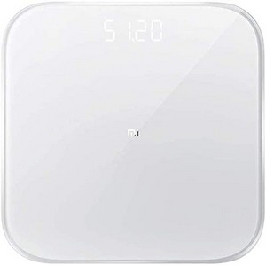

Person weighting/scale device with Home Assistant connection for tracking
Are there already person weighting/scale devices on the market (which can be bought in The Netherlands) which have a connection (WiFi, ZigBee, Matter, Z-Wave) with Home Assistant to keep track if your weighting/scale results? Suggestion about what is good device to buy and integrate into HA?
