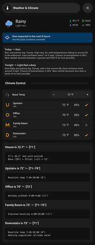

Solution
(Screenshot at the bottom shows an example with actual temp values and targets.)
I broke this into 3 layers:
Layer 1: Outdoor-Driven Comfort Offset
Instead of relying on static schedules, HA reacts to weather. I pull outdoor temperatures from a nearby station and compute a 3-day average to decide whether we’re in a “cold” or “warm” period. A simple curve maps outdoor temps to an offset (0 to +3 in heating season, 0 to −3 in cooling season). Example:

Layer 2: House Target Temperature
I defined an input helper to set the base comfort temperature. That represents my desired “feels like” temperature. The global house target temperature is calculated based on that base temperature plus that outdoor-temperature offset. This keeps the whole house generally a little warmer on cold days and a little cooler on hot ones. Example:
Base 70º, Outside 48º → Offset +1 → Target = 71º
I’m also accounting for when I’m on vacation and clamping minor fluctuations to avoid big swings.

Layer 3: Per-Floor Behavior
I created automations for each floor. Think tiny nudges (like +1 in the morning, or 0 at night) based on how that space is actually used and time of day. Example:
Upstairs:
  • 05:00–06:00 – Morning pre-warm (+1º)
  • 06:00–20:30 – Day baseline (0º)
  • 20:00–21:00 – Evening warm-up (+1º)
  • 21:00–05:00 – Night setback (-1º)
Floors with heating and cooling get a derived heat/cool set points (range). The one floor with just radiant heat gets a single set point. Each zone ends up feeling “right” at the right time without ever pushing radiant into big temperature swings.

I’m being explicit with redundant choose cases to make reading automation traces easier. Some floors have an additional condition to suppress heating if the current temperature exceeds a certain value. The Office has more conditions based on location and whether I’m working from home or from the office.
Debugging panel
I have a markdown card that explains, in plain English, what each room is targeting and why. It’s been incredibly useful for debugging and tuning. I still update it manually when I tweak automations, but I can figure out something more clever later. I’ve also added quick toggles to enable/disable each floor’s automations in case I want to apply a quick override to the set points.
Results
So far it’s been really stable; predictable warming, and way more control than Nest’s built-in logic alone. I still get the occasional overshoot because I’m still learning how much time it takes for radiant heat to heat each space. So I’m still fine-tuning timings and offsets for each floor, but so far it’s been a huge upgrade. Obviously, I haven’t tested summer behavior yet, and I expect to do some further tweaking when that happens.
Happy to answer questions. Would love to hear feedback or smarter ideas to evolve this!

  - type: custom:bubble-card
    card_type: separator
    sub_button: []
    icon: ""
  - type: custom:vertical-stack-in-card
    cards:
      - type: tile
        entity: input_number.house_base_temperature
        icon: mdi:home-thermometer
        color: dark-grey
        hide_state: true
        vertical: false
        features:
          - type: numeric-input
            style: buttons
        features_position: inline
        card_mod:
          style: |
            ha-card {
              background: color-mix(in oklch, var(--blue-color) 30%, black 70%);
              background: var(--primary-card-background);
        card_type: climate
        entity: climate.upstairs
        icon: fas:u
        show_state: false
        show_attribute: true
        attribute: hvac_action
        show_last_changed: false
        show_icon: true
        hide_target_temp_low: true

  - type: markdown
    content: >
      {% set outside =
      states('sensor.weather_station_feels_like')|float %}
      {% set cold = is_state('input_boolean.cold_outside','on') %}
      {% set base_temp = states('input_number.house_base_temperature')|float %}
      {% set house_target =
      states('input_number.house_target_temperature')|float %}
      {% set presence = states('input_select.home_presence') %}
      ### House is {{ states('sensor.temperature_inside')|round(1) }}º ← [{{
      house_target|int }}°]
        {% if presence == 'Vacation' %}
          Vacation mode active ({{ '66' if cold else '78' }}º)
        {% else %}
          It's {{ outside|round(1) }}° and {{ 'cold' if cold else 'warm' }} outside
          Base ({{ base_temp|int }}º) + {{ "Offset (" }}
          {%- if cold -%}
            {%- if outside < 35 -%}+3
            {%- elif outside < 45 -%}+2

      {% set up_curr =
      state_attr('climate.upstairs','current_temperature')|float %}
      {% set up_low  = state_attr('climate.upstairs','target_temp_low')|float %}
      {% set up_high = state_attr('climate.upstairs','target_temp_high')|float
      {% set h = now().hour + now().minute/60 %}
      ### Upstairs is {{ up_curr|int }}° ← [{{ up_low|int }}–{{ up_high|int }}°]
          (Vacation mode)
      {% else %}
        {% if 5.5 <= h < 7.5 %}
          05:30–07:30 — Morning preheat (+1°)
        {% elif 7.5 <= h < 20 %}
          07:30–20:00 — Baseline temp (0°)
        {% elif 20 <= h < 21 %}
          20:00–21:00 — Evening warm-up (+1°)
        {% else %}
          21:30–5:00 — Night setback (−1°)
        {% endif %}
      {% endif %}
      {% set off_curr = state_attr('climate.office','current_temperature')|float
      {% set off_target = state_attr('climate.office','temperature')|float %}
      {% set workday = is_state('binary_sensor.workday_sensor','on') %}
      ### Office is {{ off_curr|int }}° ← [{{ off_target|int }}°]
          Vacation offset (−3°)
      {% else %}
        {%- if 22 <= now().hour or now().hour < 8 %}
          22:00–08:00 — Night setback (−2°)
        {%- elif workday and 8 <= now().hour < 9 %}
          08:00–09:00 — Workday preheat (+1°)
        {%- elif workday and 9 <= now().hour < 18 and is_state('person.alaa_shaker','home') %}
          09:00–18:00 — WFH baseline (+1°)
        {%- elif 8 <= now().hour < 22 %}
          08:00–18:00 — Baseline temp (0°)
        {%- else %}
          18:00—22:00 — Off-hours baseline (0°)
        {%- endif %}
      {%- endif %}
      {%- if off_curr > 72 %}
          Heating suppressed (already warm)
      {% endif %}
      {% set fr_curr =
      state_attr('climate.family_room','current_temperature')|float %}
      {% set fr_low  = state_attr('climate.family_room','target_temp_low')|float
      {% set fr_high =
      state_attr('climate.family_room','target_temp_high')|float %}
      ### Family Room is {{ fr_curr|int }}° ← [{{ fr_low|int }}–{{ fr_high|int
          (Vacation mode)
      {% else %}
        {% if 6 <= now().hour < 10 %}
          06:00–10:00 – Elevated baseline (+1°)
        {% elif 10 <= now().hour < 23 %}
          10:00–23:00 — Baseline temp (0°)
        {% else %}
          23:00–06:00 — Night setback (−1°)
        {% endif %}
      {% endif %}
      {% set dn_curr =
      state_attr('climate.downstairs','current_temperature')|float %}
      {% set dn_target = state_attr('climate.downstairs','temperature')|float %}
      {% set dh = now().hour + now().minute/60 %}
      ### Downstairs is {{ dn_curr|int }}° ← [{{ dn_target|int }}°]
          (Vacation mode)
      {% else %}
        {%- if 5.5 <= dh < 7.5 %}
        {%- elif 7.5 <= dh < 18 %}
          07:30–18:00 — Baseline temp (0°)
        {%- elif 18 <= dh < 19 %}
          18:00–19:00 — Evening warm-up (+1°)
        {%- else %}
          19:00–05:30 — Night baseline (0°)
        {%- endif %}
      {%- endif %}
      {%- if dn_curr > 72 %}
      {% endif %}
