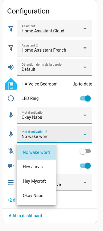

The other way I tried to do it is at the Voice PE level but there it does not even show as an option

I can’t see what you have because the drop down box is open , but in the option Wake word engine location, change that to In Home Assistant.
