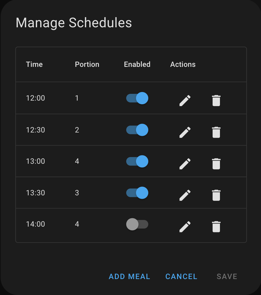

Here is some images. I hope to setup a gif soon to show it off properly!
Card view:

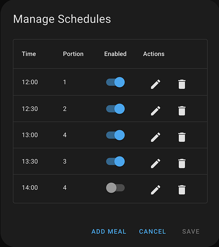

Popup with schedules:

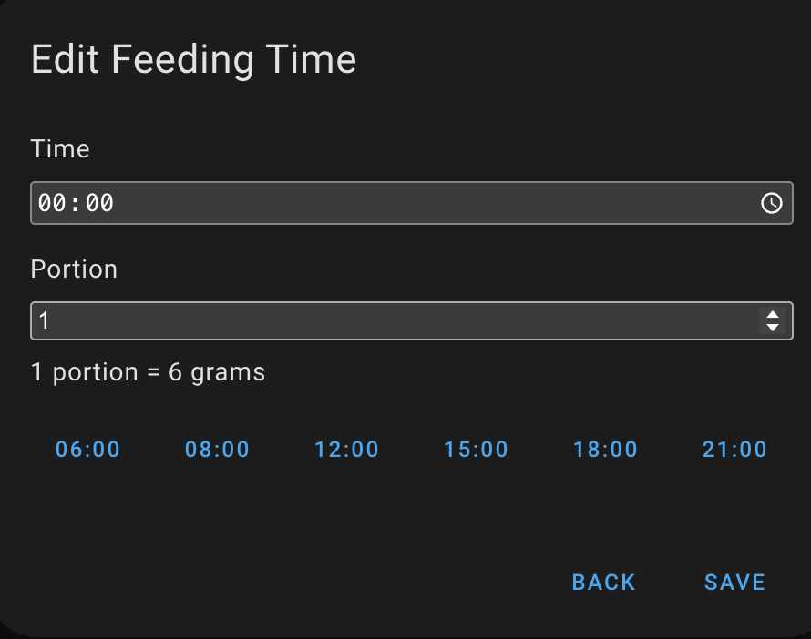

Edit view accessed from the schedules view:

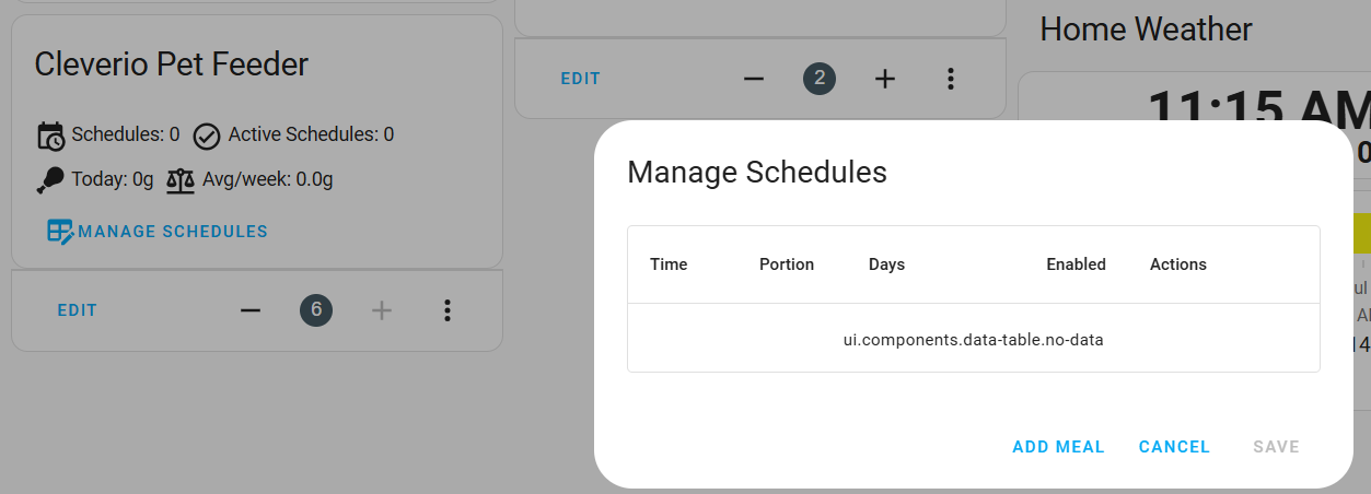

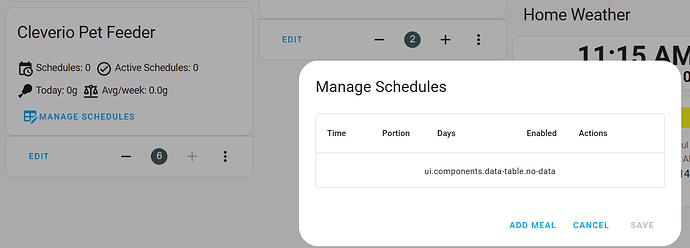

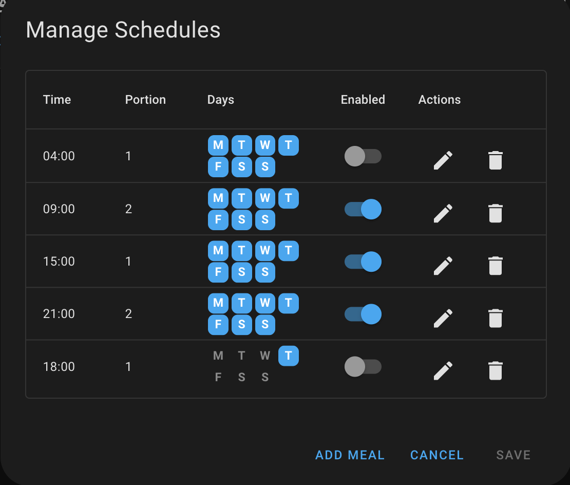

Looks like this is fork specific. I’m using different localTuya fork (GitHub - rospogrigio/localtuya: local handling for Tuya devices) and after setting up, it show the below. When I click “add meal” additional menu pops-up, but then quick closes on its own (cannot even take snapshot).
Is there a way to migrate to a different fork without loosing other configs? I have several other tuya devices that I’d prefer not to reconfigure from scratch.
I’ve updated the card to address the odd closing issue and it should no longer close unexpectedly. Thanks for noticing it!
Regarding the issue with local tuya. It appears the project isn’t actively maintained and I’m not aware of a quick way to switch over to tuya local. If you’re able to add the meal_plan logic directly into your existing local tuya setup, you might be able to continue using it without major changes. Otherwise, I don’t see an easy workaround at the moment.

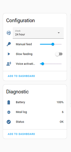

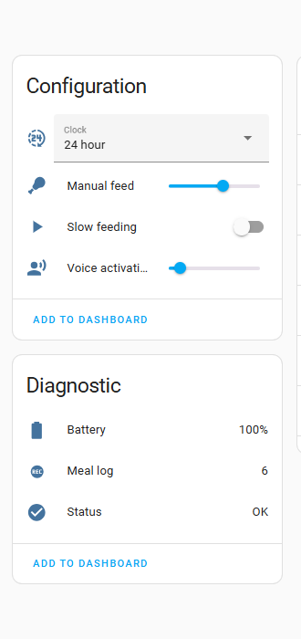

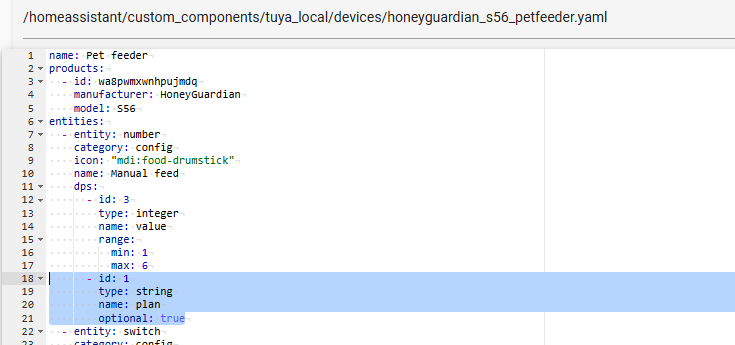

Trying out the suggested fork of the local tuya on the 2025.7, but meal_plan isn’t there yet, even though available in the local tuya device settings. Guess have to wait for the update.
Hi again! There is no 2025.7 yet for tuya local. I also see that you have a honeyGuardian and the mealplan there is nested as extra attribute within manual feed. I made a PR so now it should be part of next release.
I was able to setup the meal plan, but looks like honeyguardian base64 is different, it doesn’t contain days. Essentially, you setup the same schedule for everyday. Not sure if you’d be interested to make this into a universal card.
Your card base4:
const [daysBits, hour, minute, portion, status] = bytes.slice(i, i + 5);
Honeyguardian values decoded by a fellow githubber :slight_smile:
https://github.com/Bellavista/Tuya-Local-Honeygaridan-S56/wiki#:~:text=Value%20exsample%20code%20inside%20there,6%20meal%20portion%20yes%20planned
"value": "DAABAQweAgENAAQBDR4DAQ4ABAEOHgYB"
Plan 1: 00001100 00000000 00000001 00000001 --> time:12:00 portion:1 status/planned? yes
Plan 2: 00001100 00011110 00000010 00000001 --> time:12:30 portion:2 status/planned? yes
Plan 3: 00001101 00000000 00000011 00000000 --> time:13:00 portion:3 status/planned? no
Plan 4: 00001101 00011110 00000100 00000001 --> time:13:30 portion:4 status/planned? yes
Plan 5: 00001110 00000000 00000101 00000001 --> time:14:00 portion:5 status/planned? yes
Plan 6: 00001110 00011110 00000110 00000001 --> time:14:30 portion:6 status/planned? yes
I can take a look to see if it can be generalized and check whether daysBits exists.

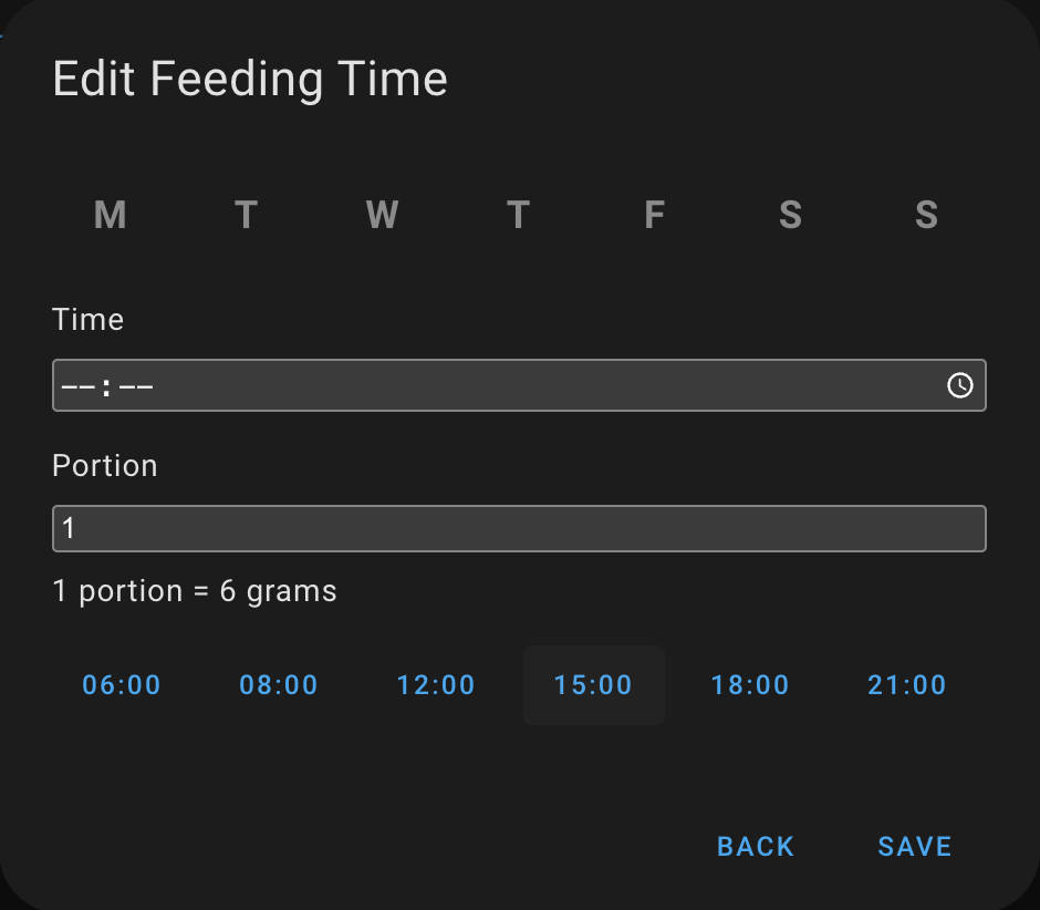

Now there should be support in case the device is missing daysBits. I also hide the days column and remove selector for days in the edit view.

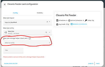

This is awesome! Thank you! It picked up my existing schedule that I setup in the app right off the bat!

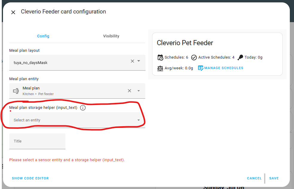

May I ask what is this new field for? Is this if the meal plan in the attribute of another entity?
Also, not sure if it’s honeyguardian specific, but the number of schedules must always =6.
So, the delete button should really be a clear schedule button.

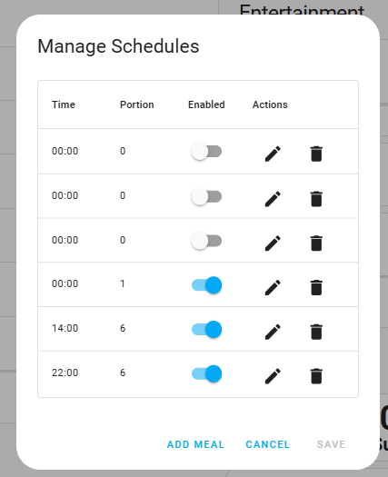

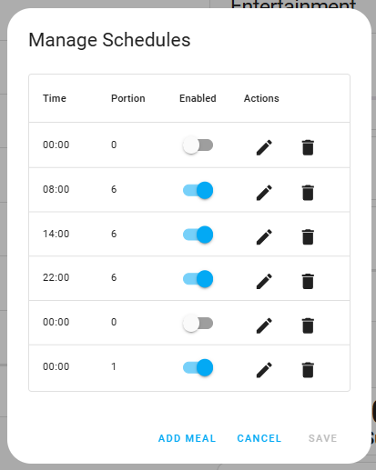

Ex. I deleted 1 schedule it shifted other schedules around unpredictably.
Before deleting…
After deleting…
If the total number of schedules is >6, it will schedule the feeder, but in the app it will only show first 6 schedules.

To answer your question about the new field, it is intended to handle reloads and restarts. Due to limitations in Tuya Local and cases of missing or invalid data, I added a helper to store the data as a fallback.
Regarding the unexpected shifting, it seems the table was sorted by the “enabled” column after pressing delete. I do not think anything is actually wrong, but I will take a closer look to understand why the sorting behaves that way.

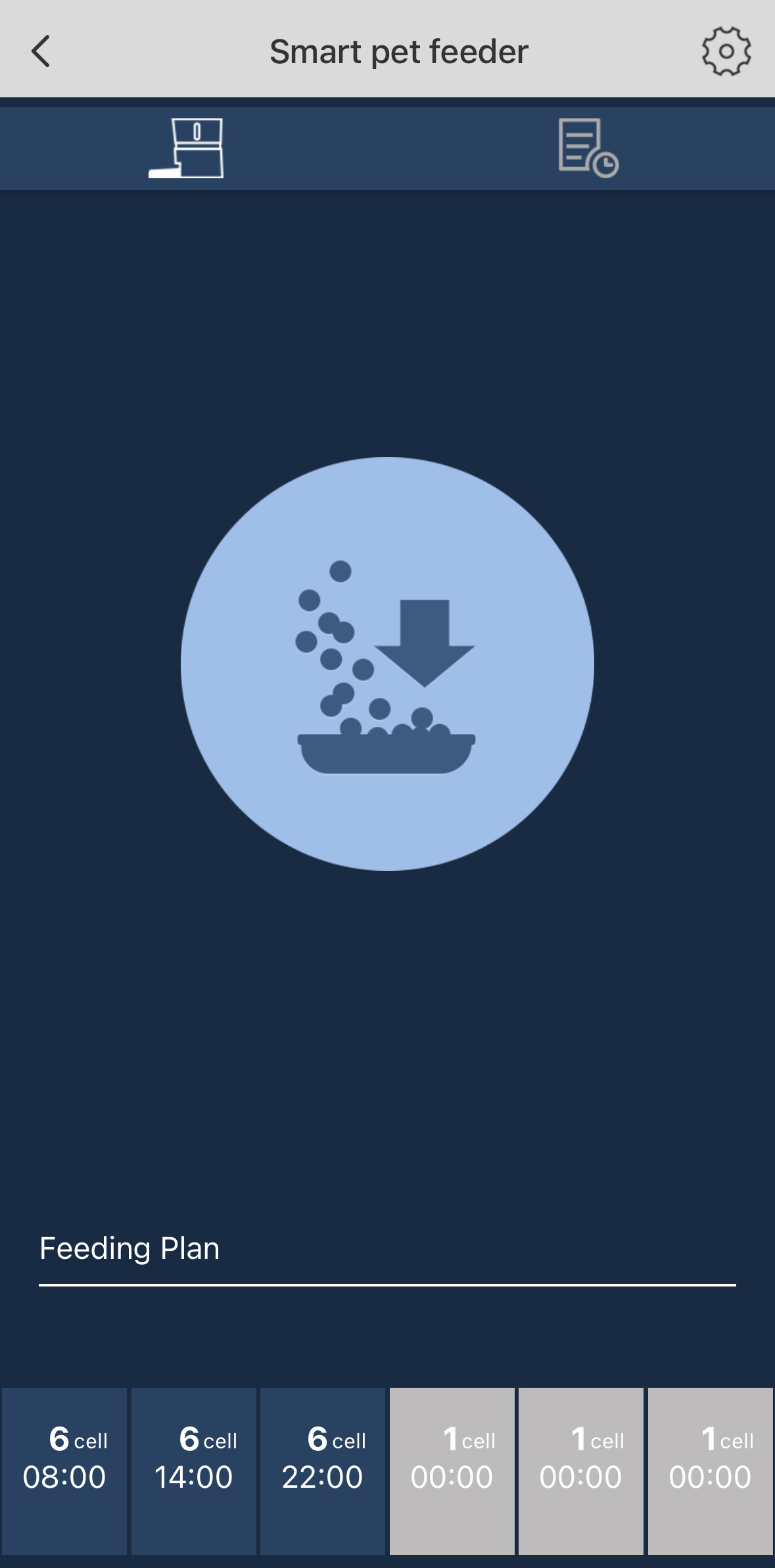

To elaborate on the >6 schedules. The total # of schedules must always be =6. No less, no more.
In the tuya app it shows only 6 schedules (see below). So if using your card I create for example 7 schedules, the feeder will execute all 7, but the app will never show the 7th schedule, so I will be pulling hair why feeder released food when the app doesn’t show anything scheduled. :slightly_smiling_face:
Hope this explains.

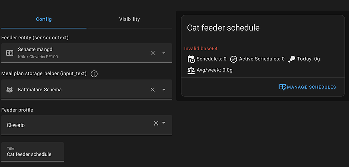

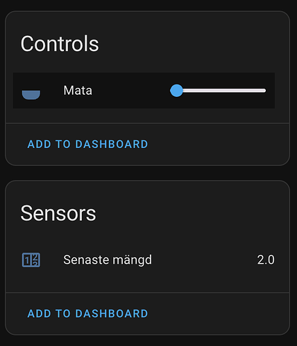

I just bought a Cleverio PF100 and added it with the Tuya-integration. But I only have two entities
  • a number entity (for number of portions)
  • a sensor (that displays amount of portions dispensed)
The card component cant find the number entity, can only use the sensor for the feeder entity in the setup for the card. I then get the error Invalid base 64. Any suggestions what I’m doing wrong?
@mingvas I assume you use the tuya integration provided by home assistant? I am working to implement meal_plan (base64) support but taking a while to get it implemented. Can you migrate to tuya local? That have the best support for meal_plan.
Yeah I use the integration only called Tuya. Can see if I can use Tuya Local instead!
