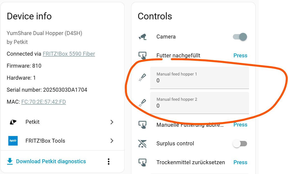

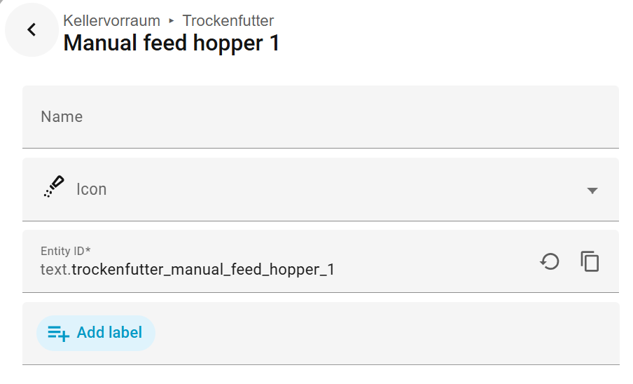

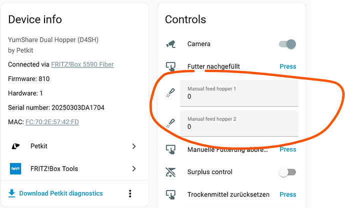

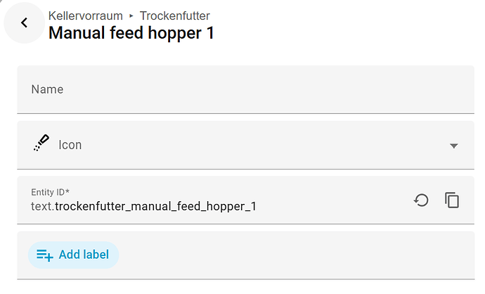

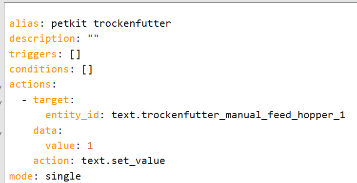

I really love the integration, however, I am not able to set up an automation that triggers my YumShare Dual Hopper (D4SH) to initiate feeding. Manually I can enter the integration, type in a number and hit the enter button…
I have been trying this automation code, yet, without success.
Thanks for your help!
Hi @4irm
Everything you described above is supposed to work.
I tested it myself and it works normally and the food is dispensed.
Did you retry ?
Thank you very much for your support! I had to restart Home Assistent but now it works.
