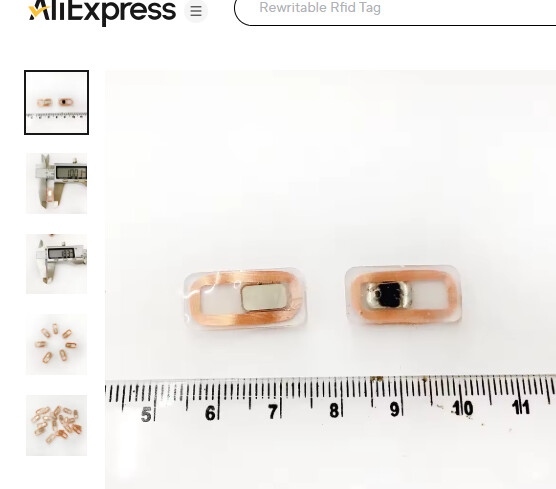

Maybe an idea to buy these, and glue them on the inside of a collar:
https://nl.aliexpress.com/item/1005009262260806.html

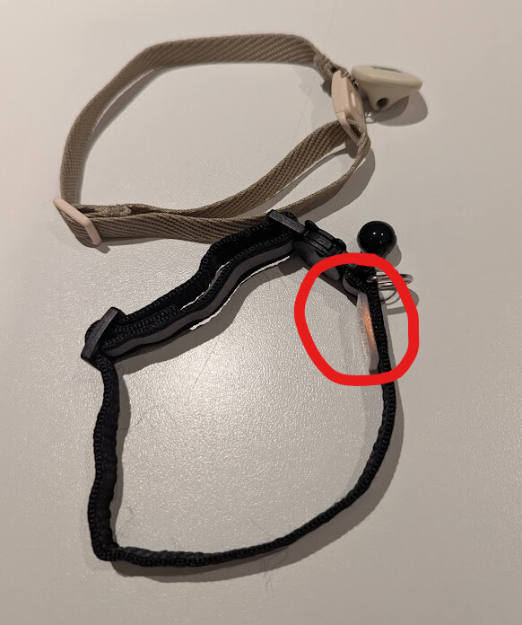

Guys, ordered myself these below, and i cloned the original rfid tag to it, it works, but the range is not good… i wonder why the original tag range is better, while its also a small tag? its an fdx-b original, i emulated my t5577 tag and rewrite it as fdx-b … i had the idea to glue the tag on inside, it looks perfect , you dont see the collar anymore, but its range its only like 10 cm max, so most of time the lid doesnt open … gonna look for a bigger one, that i can still glue, or maybe extend with an antenna…
