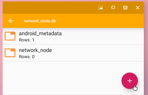

I’m not as fortunate…it returned 0 rows wit the SQL command using DB browser for SQLlite. Any suggestion for a linux app?? Installed the RasorSQL app. Same result. 0 rows
Installed and its running, but could not find : client_id and client_secret. any suggestions?
@ mvroosmalen1970 Did you login in the app? Does the network_node.db exist?
Jep, network_node.db exist but network_node has no records. Also tried the iobroker solution and its running, but also here no clientsecret published.
I posted some new information as an issue here: Airfryer Combi 7000 Series XXL (HD988X) · Issue #4 · noxhirsch/Pyscript-Philips-Airfryer
TLDR: The current HomeID app still got a sqllite3 db called network_node with the informationen needed.
