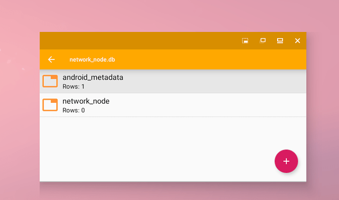

However: the Network_node_db contains NO entries in the network_node section.
So i cant obtain client id and client secret.

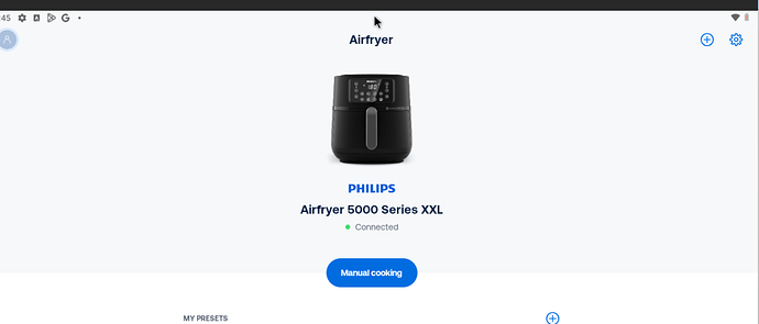

Do you see the appliance in the app? The network_node should be there. I see it with the same app version.

yes, i see the airfryer:
but there is no entry in network_node:

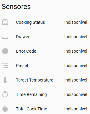

My current firmware version is:
Can I update to this version? Or will it stop working?
Should I update?
Because every time I open the HomeID app on my phone, it shows a pending firmware update for the device.
EDIT: After a few minutes, the device becomes offline and never get back.
Do you know what happened?
EDIT 2: I deleted the device and did reconnect to device and now works since yesterday. I believe that when I opened the HomeID App in my smartphone, it knocked down the integration, is it possible?
