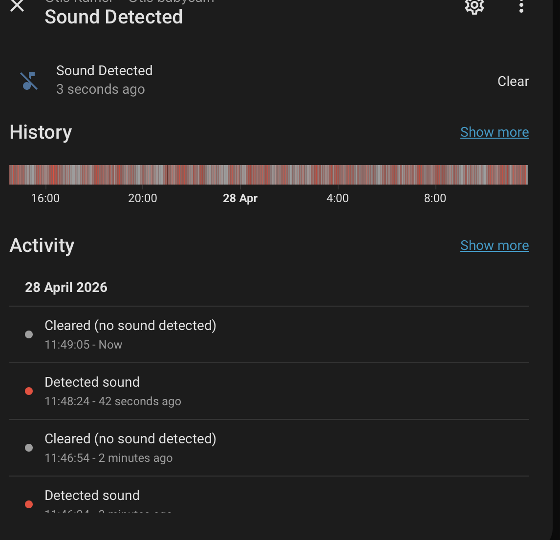

  • Motion and sound alerts as binary sensors with toggle switches (DPS 134/139)

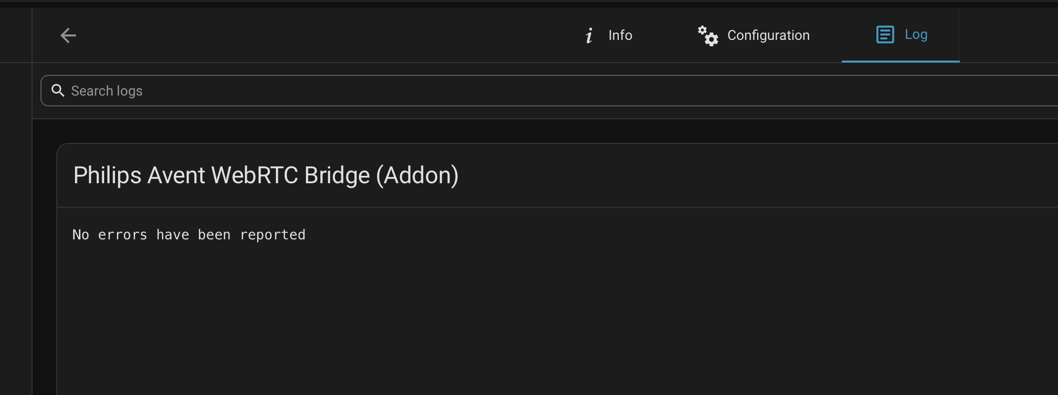

Ehy! Thank you for testing it out. Have you installed the addon?
The custom component needs a “translator” to inject authentication. The error says that the custom_component is not able to connect to it.
If you look at the readme there are the magic buttons to add the repo on the fly.
I suggest to use the stable for now.
Yes, Ive installed both the addon and the custom integration. The add-on doesn’t log any errors at the moment.
In the Config there isn’t any camera entries, do I need to add it manually there as well?
If yes, how do I find the camera id?
EDIT:
Stupid me, the add-on wasn’t running, feed is working now.

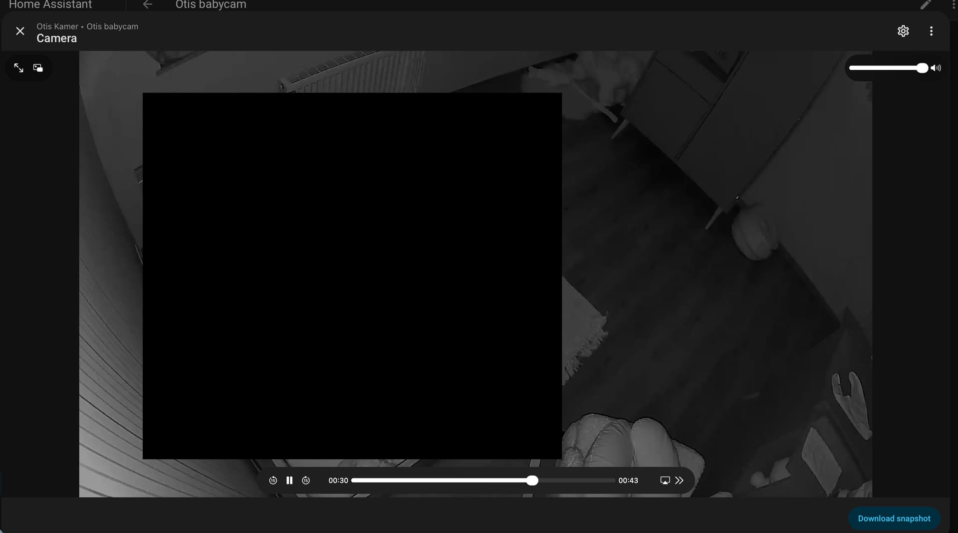

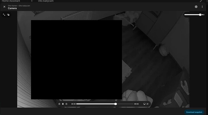

I’m only getting video, no audio at the moment.
Right now it seems like a hit or miss with the video too, sometimes it loads, other times it doesn’t.

The Download Snapshot function doesn’t seem to work, it downloads a 55bytes png file that doesn’t contain picture data, content of the file is
500 Internal Server Error
Server got itself in trouble
To get the audio you have to unmute the video feed.
About the snapshot that’s interesting could you provide a log and more info via GitHub issue?
Also the model of the camera so I can put down a table for supported hardware.
I received the video stream of SCD921 and tested nightlight successfully :ok_hand: Well done!
Is there a way that the camera runs 100% local?
The audio slider is by default set to max volume, I don’t see any unmute button? I’m on MacOS and Safari if that matters.
By model you mean SCD921?
Not sure where I can find any log related to the downloading of the snapshot, couldn’t see anything in the HA logs.

Hey Skye, glad to hear video is working!
About the audio: that’s a Safari thing unfortunately — Safari’s autoplay policy blocks audio by default until you interact with the page. The volume slider you see controls the
device speaker volume (DPS 209), not the browser playback volume. To actually hear audio from the stream, you need to unmute the video player itself — but Safari hides that button
in some card configurations.
A couple of things you can try:
  • Click/tap directly on the video feed — that should trigger the browser interaction Safari needs to allow audio playback
  • If you’re using the WebRTC Camera custom card, try right-clicking the video → “Show Controls” to get the native browser audio controls
  • Using the HA Companion App on macOS instead of Safari tends to work better since it doesn’t enforce the same autoplay restrictions
  • This is not specific to our integration — it’s a well-known Safari limitation that affects pretty much any
    camera feed in HA
About the snapshot 500 error: yeah, that’s a known limitation right now — the camera entity doesn’t implement a native snapshot method yet since the stream comes from the RTSP
bridge, not directly from the device. It’s on the list but not a priority at the moment. As a workaround you can grab a snapshot through the HA service camera.snapshot which pulls
a frame from the running stream instead.
And yes, SCD921 is perfect — good to have confirmation it works. I’ll add it to the tested models list!
Let me know if the audio trick works for you.
I tried using the iOS companion app, clicked unmute/mute/unmute but still not getting any audio on my iPhone, nor using the clicking on the feed on Safari on MacOS to get audio.
Also another thing I noticed is that the motion detection sensor does not work and the sound detection is behaving very weird:
WiFi signal sensor also is “stuck” at -75dBm, I can’t believe the signal strength doesn’t fluctuate one bit in 24 hours.
The temperature sensor is working fine.

Hi! I've just installed the integration and the bridge add on, when after entering credentials and then the code I get a cannot connect error but in HA but I get the notification in the Avent App that a new login was attemptemted. I would appreciate some help!
Thanks!
