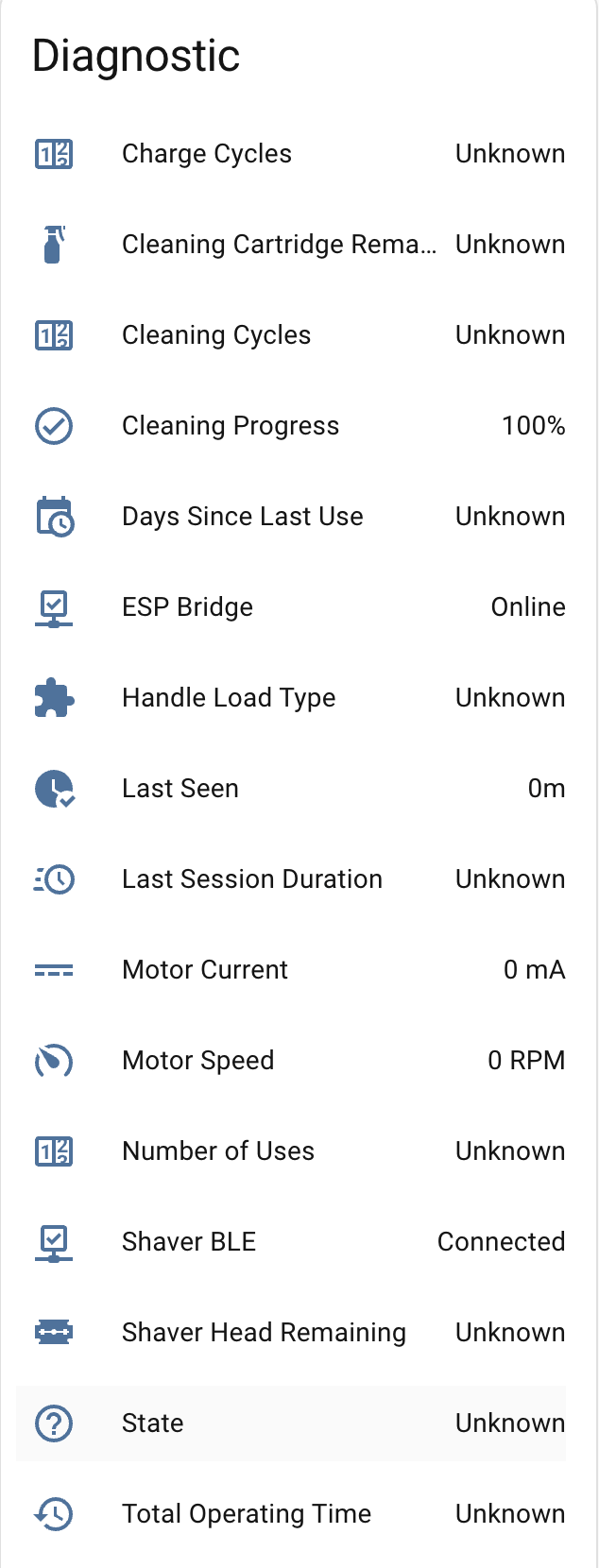

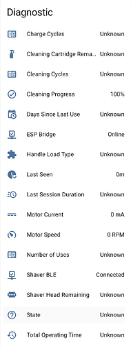

Good oh - well it’s a public holiday here today so time to play! :wink:
The good news is it appears to connect fine. FYI This is using a Lolin D32. I reset the shaver first (held the button down for 30 seconds) and the shaver was found and it connected:

So also yay. Now a number of settings don’t appear to be working (for example detecting if it’s charging), no doubt due to the differences between the models, but the main ones - in particular the battery level (which is why I started all this way back when so I could get alerted in advance if the shaver should be charged) - are working fine.

OK - so got some time to check this. I suspect as well as the less fancy shaver not supporting some sensors, the service_uuid’s etc may be different between the shavers. Again, no rush about this. The main thing is the battery tracking works. Anyhow, the results are as follows:
sensor.philips_shaver_state - is stuck on ‘unknown’. Full diagnostic info is:
binary_sensor.philips_shaver_charging - stays at ‘not charging’ even when plugged into charger
sensor.philips_shaver_activity - stays at ‘off’ even when in use
Live updates don’t seem to happen - no change to motion, rpm, etc

Hi @zagnuts,
thanks a lot for the detailed diagnostics — really helpful! I looked through both logs and I think the main issue is that you’re running a pre-v0.12.0 version of the integration. I can tell from two log signatures that only exist in the old polling-based coordinator:
Recent data (48.58s < poll interval 60s) – polling skipped
Live connection ended – polling will resume
Live monitoring active – polling paused
These were removed in v0.12.0 (early April), which replaced the dual live+polling design with a pure event-driven architecture. The current release is v0.12.4, and the ESP Bridge component is now at v1.5.2. Quite a few reliability fixes landed in that window (reconnect loop fix in v0.12.1, auth-after-reboot fix in v1.5.2, charger-on entity availability fix in v0.12.4).
Before I dig into the S7887-specific quirks, would you mind upgrading and sending another round of logs? Two steps:
  1. Update the HA integration to v0.12.4 (via HACS → Update, then restart HA).
  2. Update the ESP Bridge component to v1.5.2 — in your ESPHome YAML, bump the ref of the philips_shaver external_component, then recompile + flash. See ESP_BRIDGE_SETUP.md for the exact snippet.
Then:
  • Reset the shaver pairing once (hold power button ~10s until it flashes four times), let the ESP re-pair, and capture the same two logs again (ESPHome device log + HA debug log for custom_components.philips_shaver).
Appreciate the testing — this kind of feedback is what makes the integration usable across models I don’t own.
Cheers,
Martin
Hi @zagnuts,
thanks again for the logs — they had enough for me to pin the root cause down without a second round, so I went ahead and released the fix as v0.12.5 (integration) + v1.6.1 (ESP bridge).
Short version: two bugs on top of each other. The integration tore down the BLE transport on the first read timeout, and the bridge fired its ready event before encryption completed — so reads for some characteristics were happening against a pre-encryption GATT cache. Both fixed.
To update:
  1. HACS → Philips Shaver → Update (goes straight to v0.12.5).
  2. Bump the ref of the philips_shaver external_components entry in your ESPHome YAML to main (or the v1.6.1 tag) and reflash. HA will show a Repair notification if the bridge is still outdated.
If you have a few minutes after that, I’d love another short log on the S7887 — just initial connect + ten seconds of shaving + plugging in. Happy to dig in further if anything still looks off.
Cheers,
Martin
Coolio. Fantastic work, Martin. Updated the integration and added “refresh: 0s” to the external components section of my esp code. Oops. :wink:
Everything works now except for:
  • Motor blocked & unplug required - both showing ‘problem’
  • Motor speed - 0 rpm (likely shaver does not report this)
  • Total operating time - stays at 0.00s
    Obviously none of those are critical. I’m just going to disable the sensors. :slight_smile:

@zagnuts
Great, glad the update landed cleanly — your logs show reads going through against the post-encryption cache now, which is exactly what I was hoping to see. Appreciate you running
the retest.
Quick take on the three leftovers:
“Motor blocked” + “Unplug required” stuck at Problem
Your 0x0110 reads 13 00 00 00 — that’s a bitfield with bits 0+1+4 set: motor_blocked, clean_reminder (the entity for that only appears on models with a cleaning station, so you probably don’t see it), and unplug_required. These are sticky flags: the shaver latches them until the corresponding bit is written back to zero. The integration doesn’t auto-acknowledge yet, which is why they stay on forever.
Before I wire up an auto-ack toggle, can you clear them manually once? Developer Tools → Actions → switch to YAML mode, paste and run:
action: philips_shaver.acknowledge_notification
  notification: notification_motor_blocked
  notification: notification_unplug_required
If both binary sensors flip to OK and stay OK for a minute or two, I’ll ship auto-ack as an option in the next release. If they snap back right away, I’d rather leave the flags visible than fight the firmware on something that might actually mean something on your model.
“Motor speed: 0 rpm” and “Total operating time: 0.00s”
I dug a bit deeper into the protocol and the semantics aren’t quite what my sensor labels suggest:
  • Motor speed reads characteristic 0x0104. On your S7887 it’s subscribed but the firmware never sends a notification.
  • “Total operating time” is actually the wrong label on my end — 0x0106 is an internal seconds counter the firmware uses as a clock reference for on-device shave history, not a motor runtime total. Reading 00 00 00 00 forty days after your reset means that counter is effectively frozen on the S7887.
  • The actual motor lifetime counter should live on a different characteristic (0x0112) that I’m not currently reading.
If you’ve got a minute, could you fire this one call and paste the response? It reads all three in one shot:
action: philips_shaver.read_characteristic_raw
  characteristic_uuid:
    - "0x0104"
    - "0x0106"
    - "0x0112"
Ideally once at rest, then start shaving and run the same call again. That tells me three things:
  1. Whether 0x0104 on read (vs. notify) returns a real value while the motor is running — if so I can poll it instead of relying on subscriptions.
  2. Whether 0x0106 is really frozen at zero or just slow to update.
  3. Whether 0x0112 exists on the S7887 at all. If it does, that’s the total-runtime source I should have been exposing, and I’ll rename the current sensor and add this in the next
    release.
Either way — integration’s working, the rest is for my own curiosity and for the next Series 7 user who shows up. No rush at all.
Cheers,
Martin
OK - here goes!
  1. Ran the two actions, and both the binary sensors have gone to ‘OK’ and haven’t changed
  2. Ran the next one, and the response was:
status: partial
results:
  8d560104-3cb9-4387-a7e8-b79d826a7025:
    value: e818
    bytes: 2
  8d560106-3cb9-4387-a7e8-b79d826a7025:
    value: "00000000"
    bytes: 4
  8d560112-3cb9-4387-a7e8-b79d826a7025:
    value: null
    bytes: 0
    error: >-
      No service UUID mapping for characteristic
Then during shaving:
status: partial
results:
    value: e818
    bytes: 2
    value: "00000000"
    bytes: 4
    value: null
    bytes: 0
    error: >-
Then after shaving - the same ie no change. So end result is I suspect they can be ignored for this shaver. Not an issue, but good to know. FYI The Motor Speed sensor now stays at 2,100rpm.
