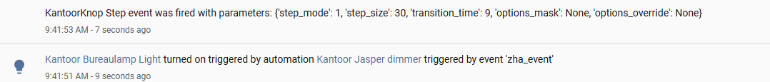

  • Dim up / down doesn’t work (does show entry in logs - see screenshot)
Anybody got this working? My hue dimmer switches don’t work properly anymore.

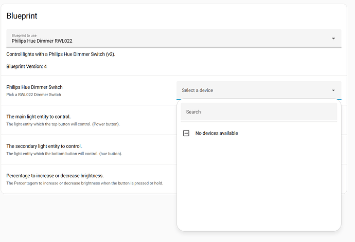

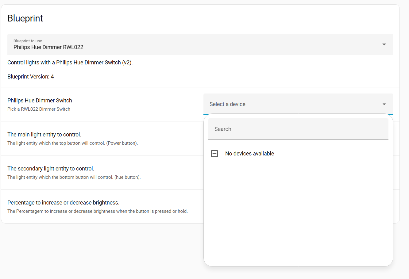

I have imported but it doesnt find the remotes for some reason
Do they need to be added using zigbee or can it be done via the hue hub? I currently have it via the hub (assuming wrongly)
This way, and specifically ZHA.
This is specific for ZHA
