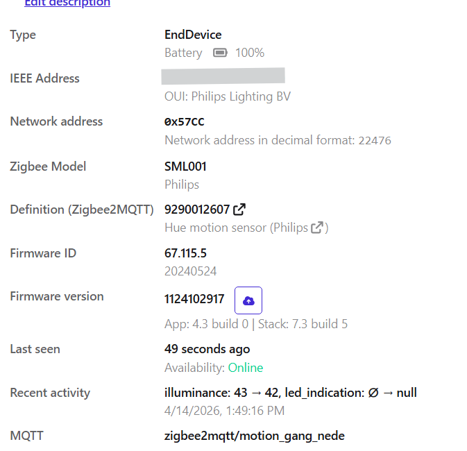

What firmware are you running on the sensors? I have two of these myself, running on the same batteries for at least a year on both of them. If it’s old try updating it. Mine for comparison:
Take a look at this thread, mind you I haven’t read them myself so you need to do the quality check yourself :slight_smile: https://www.reddit.com/r/homeassistant/comments/1rw4q9o/i_figured_out_why_hue_motion_sml001_and_sml002/
my firmware version on the SML001’s is 0x43007305 which converted to decimal gives 1124102917 which looks very similar to yours. I updated all my hue devices before I migrated them to HA, without the hue bridge. Keeping firmware up to date is one of the things I prefer to do. In that regard it’s a pity that those updates are not working in HA.
