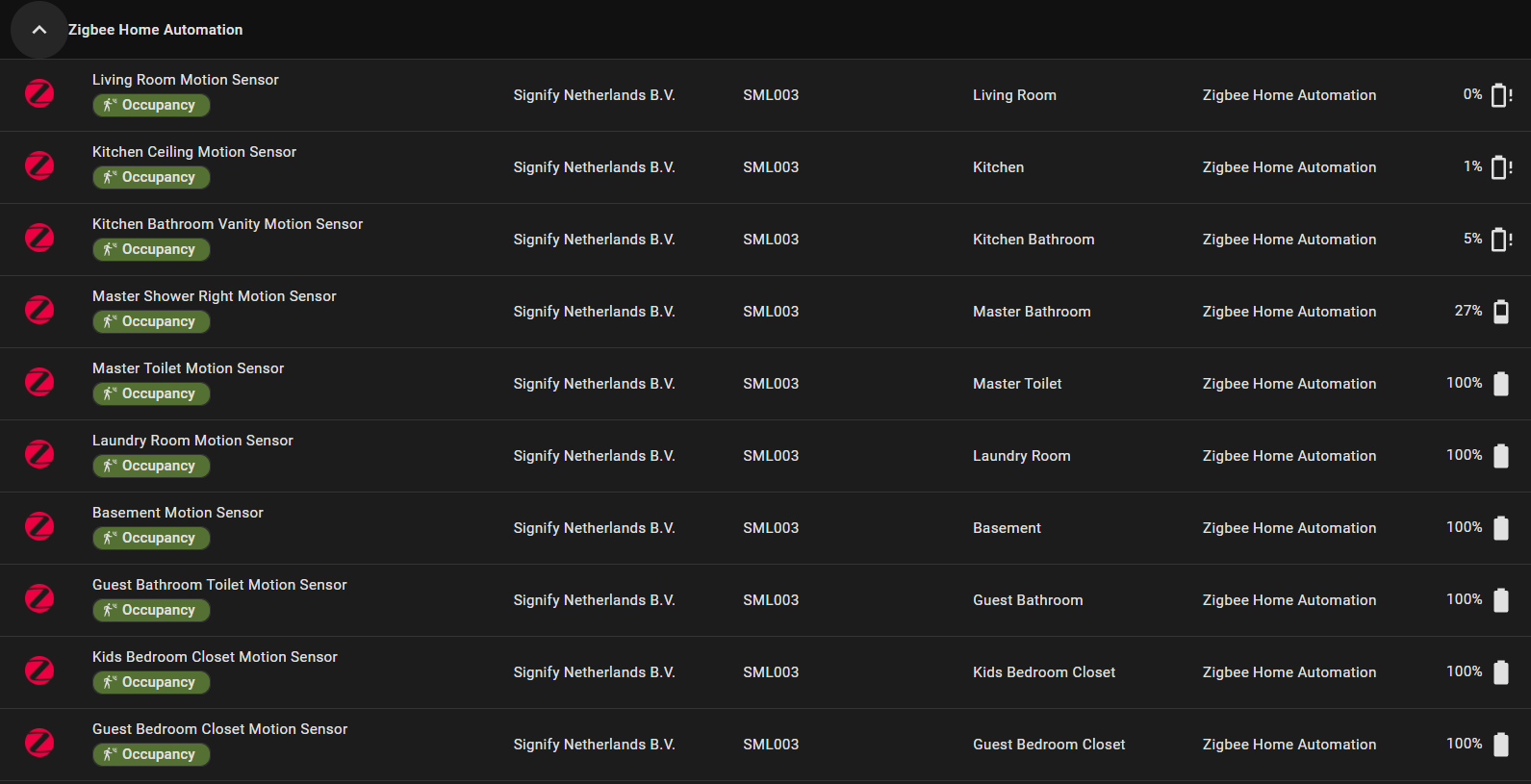

Hello! I have over 25 of the Philips Hue Motion Sensor (model: SML003), and I’ve been using them only with Home Assistant Zigbee with ZHA for about a year now.
About a month ago, they all started dying one by one. I bought most of them around the same time, so it makes sense that they’d all start dying around the same time. But after replacing the batteries with brand new batteries (I’ve tried both Energizer from multiple stores and Kirkland Signature from Costco), the batteries die within a few weeks.
The battery life has always shown 100%, so there’s no way to know what’s going on. They just pop offline suddenly, and I only know because a room won’t turn on or off, and I find a bunch of them outta battery.

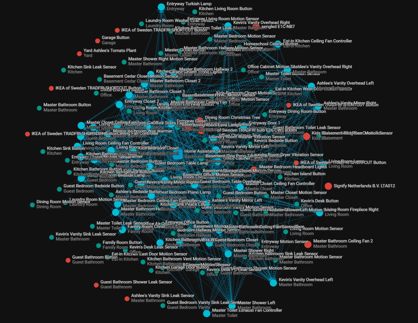

I’m currently using the ZBT-1, but I have a ZBT-2 coming. I have plenty of devices, so I don’t think it’s a signaling issue. Anything red are devices that aren’t connected:

I pay $30 for another set of AAA batteries each week. This is getting ridiculous. I don’t like spending time repeatedly changing batteries nor do I like paying for them. What’s going on? Why is this still happening?
The recent purchase or Duracell (over Energizer and Kirkland Signature (Costco brand) still show “Good” on my battery meter.
That means this time, it’s not battery life, but Zigbee signaling. I haven’t taken out any routers or anything, I’ve only added them (Christmas tree plugs).
Was there a recent firmware update? And why only these 9? Some of the others work fine.

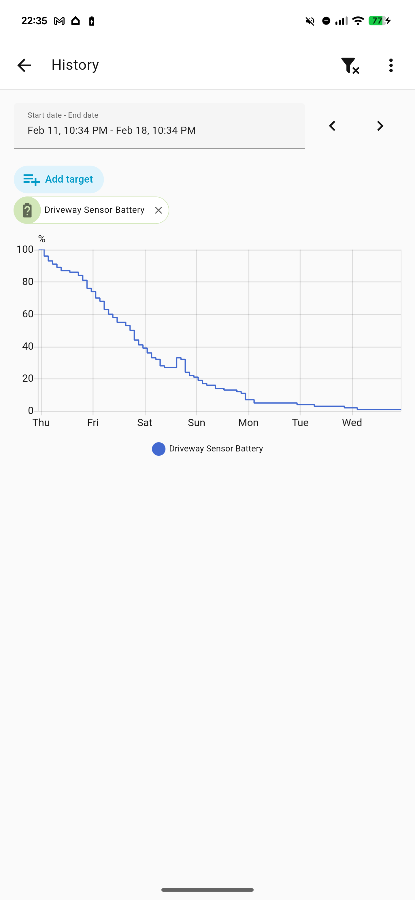

Same issue here, my hue outdoor and most of my other hue sensors/buttons are going fast.
This was new batteries in the hue outdoor that lasted 1 week.

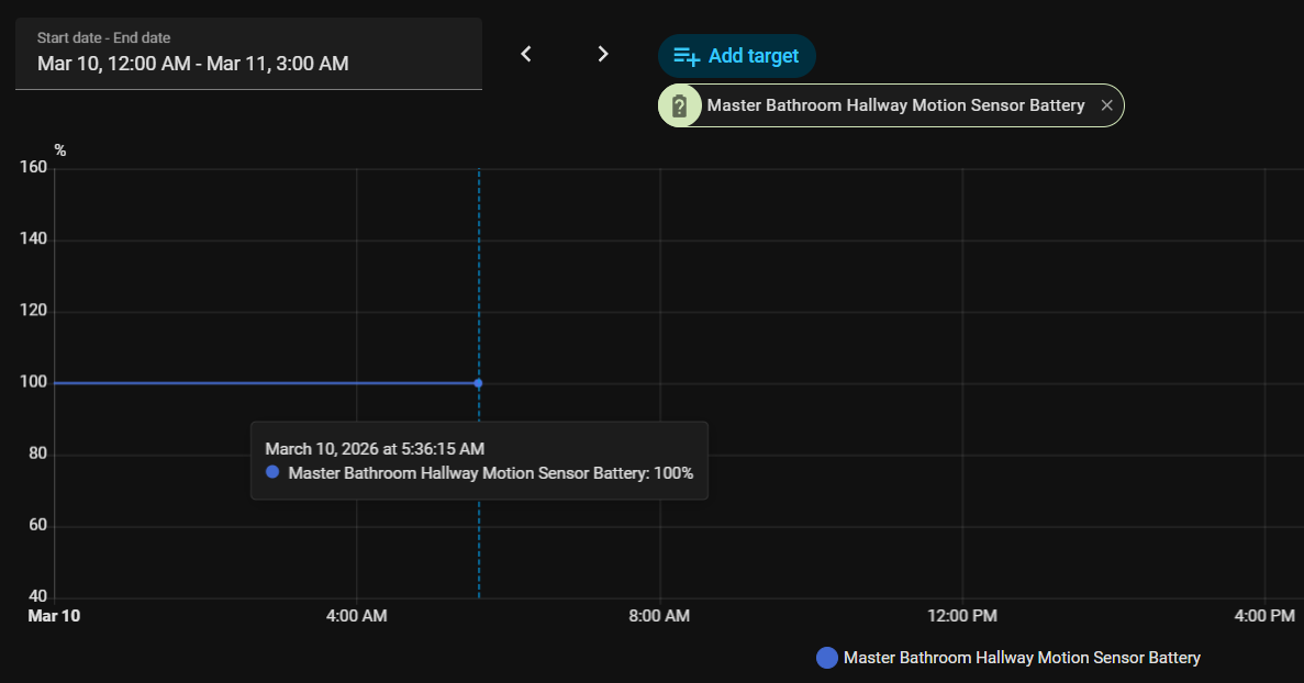

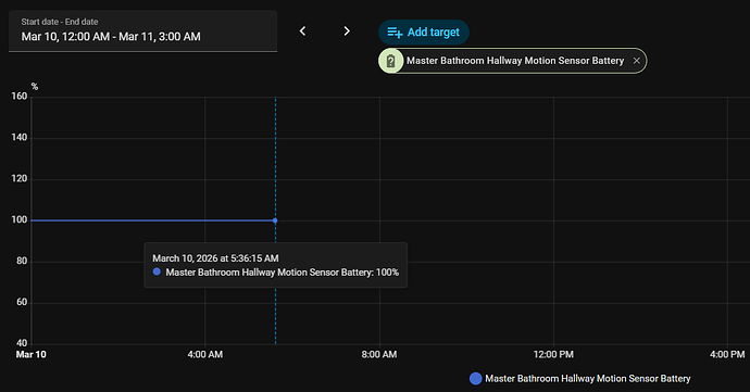

Thanks for showing that data! Since none of my motion sensors are showing battery usage, there’s no way to see it graphed like that.

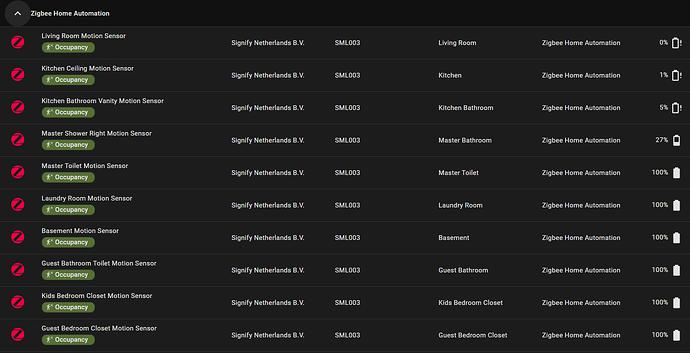

In the last 3 weeks, I’ve only had 5 go bad. I replaced the batteries 6 times on a couple last night because they simply wouldn’t turn on. Not sure why just those had issues.
Something new though, 4 of the ones I added show battery levels below 100% for once!
I have 33 of these exact sensors total, and only those 4 show battery levels under 100%. They’re also 4 of the 5 that just got brand new batteries. The 5th one disconnected or died with no change in the battery life:

Looking at the number of connections, I was right, routers are connected to each other in a big mesh. Each individual router is connected to just about every other router. I count 20 connected devices on many routers and at least one of them with a full 32 connections! A few had less than 20.
If 20 or 32 is the max for those routers, and routers are meshing with each other, it would make sense that I’m maxing out the available slots for end devices. While none of my IKEA buttons or motion sensors have this battery issue, just these Philips Hue Motion Sensors, I’m wondering if it’s somehow related to the way they connect to the mesh.
Other notes

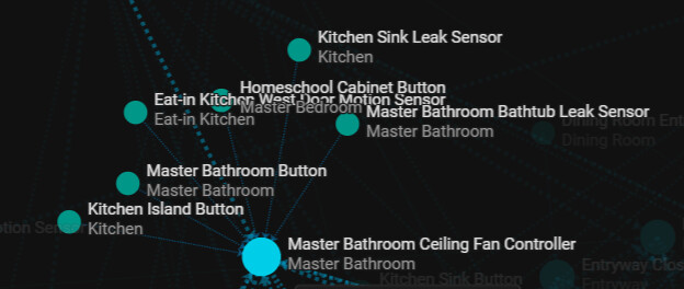

The vast majority of routers have no end device connections; only other routers.
It’s surprising how routers all mesh with each other in this weird loop, but end devices only have a single connection to a single router.
Here’s one example of a router with 6 end devices and 10 routers where most have no end devices:
It’s very possible the failing Philips Hue devices are connecting to a router that’s not favorable to the way they manage battery life, but it’s also weird this only suddenly started after a ZBT-1 firmware or Home Assistant upgrade. Something was upgraded when I started noticing these battery-life issues.
