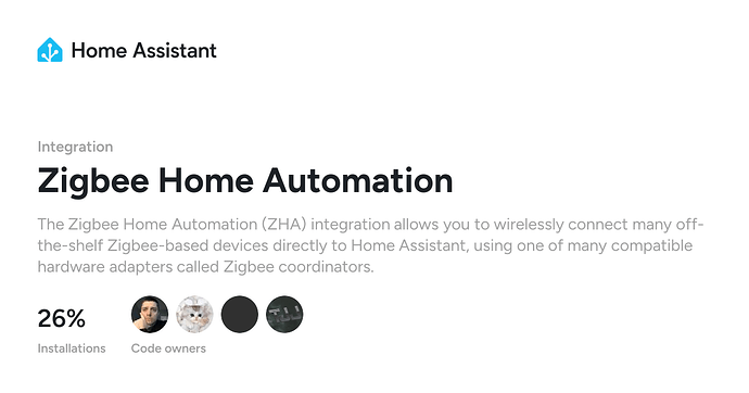

As for how to report issues, check this help article:
Integration issues are in the core tracker.
Also check the troubleshooting documentation for ZigBee, it has a section on reporting issues that list mandatory information you must include in the report in the addition to the regular things:
However, in case it’s a problem with your coordinator, you could make a support request with Nabu Casa (it’s commercial company, they are responsible if the product they sell is defective).

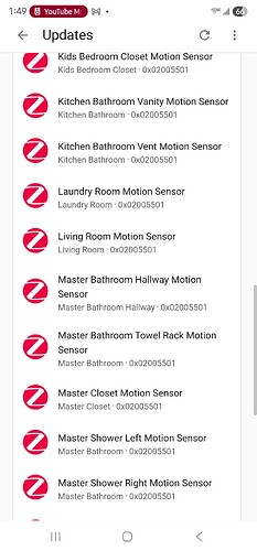

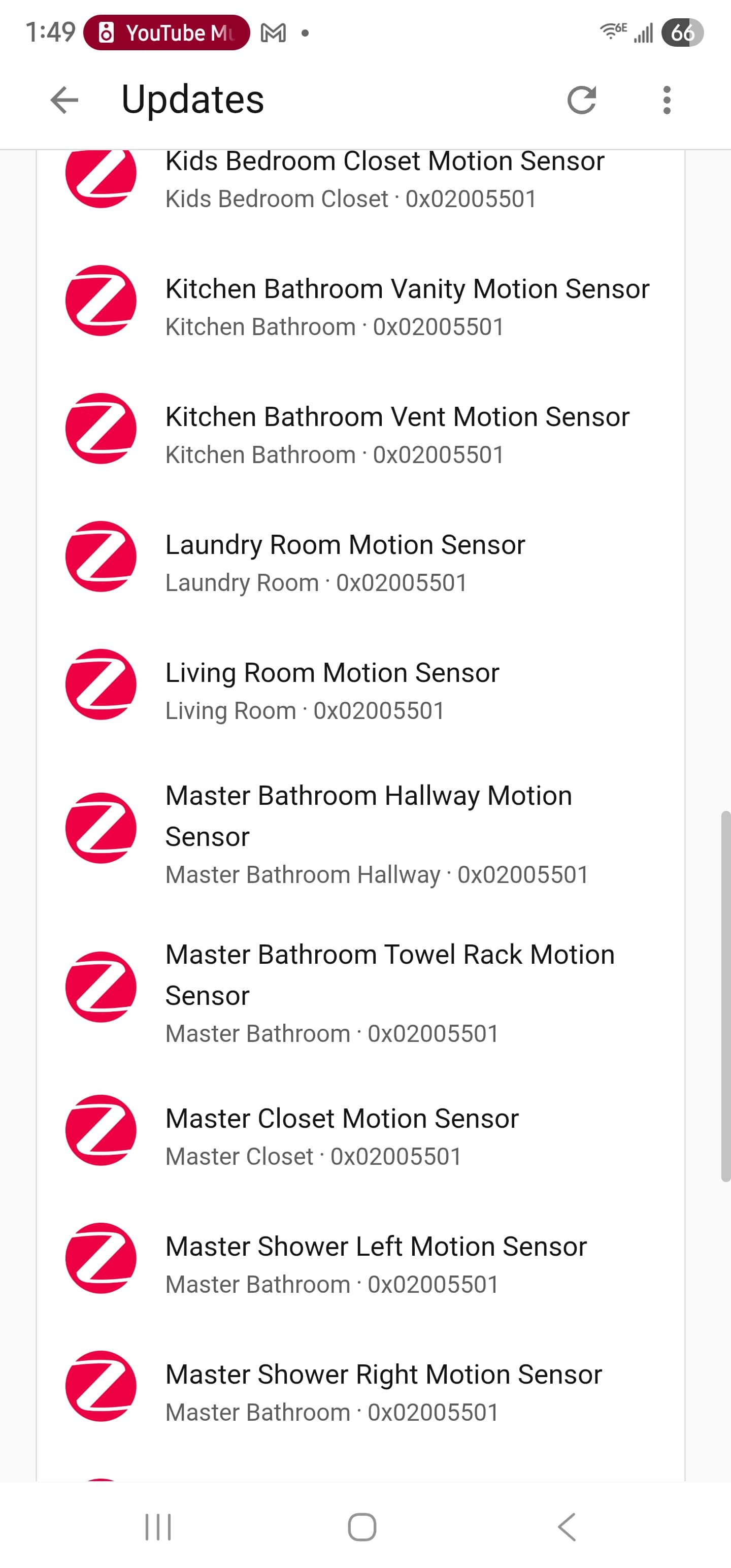

I’m gonna be more affected than the vast majority of people because I have 33 of these exact same model of sensor. I’m sure most folks would just assume their one or two sensors are bad, but because I owned them for a year without issue and only have issues with these, it’s clear to me something changed.
I’m tired of spending all this money on new AAA batteries and replacing them in my sensors. Anything I can do to fix it would be great.

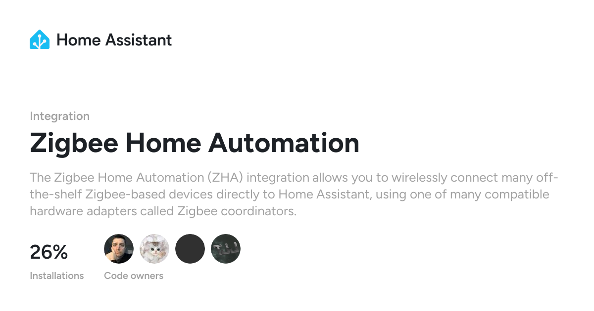

Posted on GitHub:
