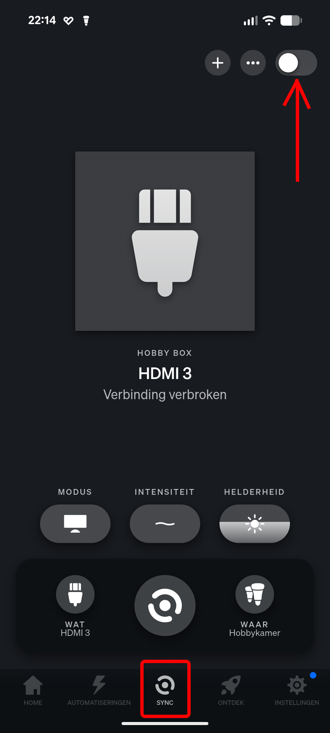

That does not sound normal, but I am not sure how it would related to this integration. Does it do the same when powering off from the Hue app?
Maybe it is something related to the HDMI-CEC settings?

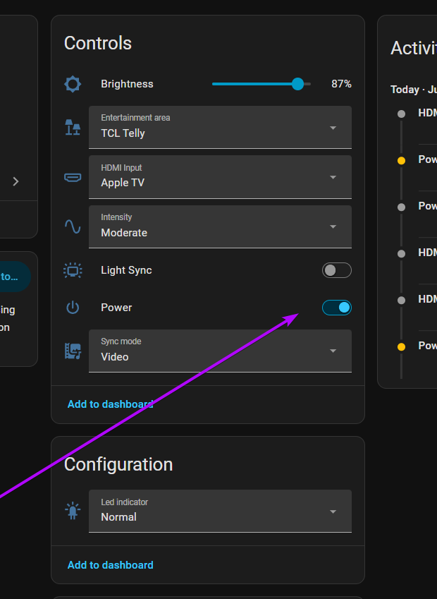

Nope when I turn the strips behind the TV off via the app, nothing else is affected. I don’t think I’ve ever deliberately turned the Sync box (8k) off.
Also to elaborate, I meant this occurs when I toggle the power within the integration
The power switch in the integration should do the same as this power button in the Hue app. Could you try that power switch and see what it does?

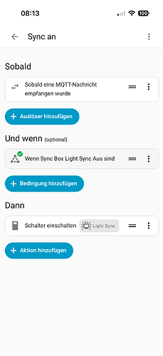

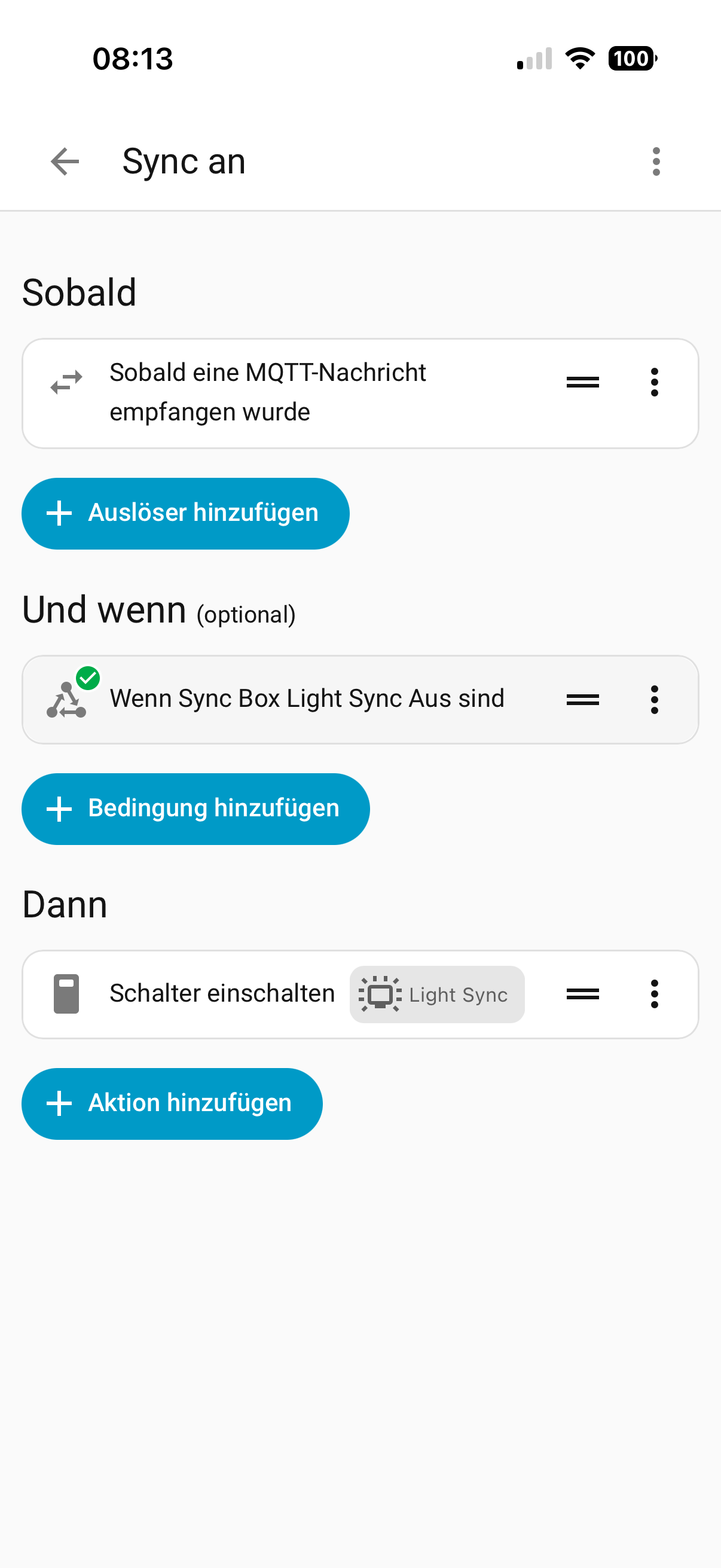

I’ve had Home Assistant for two days now. I installed HACS and the MQTT broker. I added the Hue Sync Box via HACS and tried out the associated automations. I successfully transmitted the MQTT command from my remote control. Can anyone explain why the automation isn’t triggering?
Show us the full yaml please.

I’ve just checked on mine and turning on the switch ought to be sufficient.
If you try manually, ie just toggling the switch directly in Home Assistant, does it work?
If it does then the issue might be with your trigger.
I last watched TV yesterday evening, and the automation worked fine. Today, when I started things up, the Sync Box didn’t turn on automatically. I then manually triggered and stopped the automation in HA, and that worked. Now, if I start it using the SofaBaton, it works again. Could something be “going to sleep”? Unfortunately, I’m a complete beginner when it comes to troubleshooting this kind of thing.
