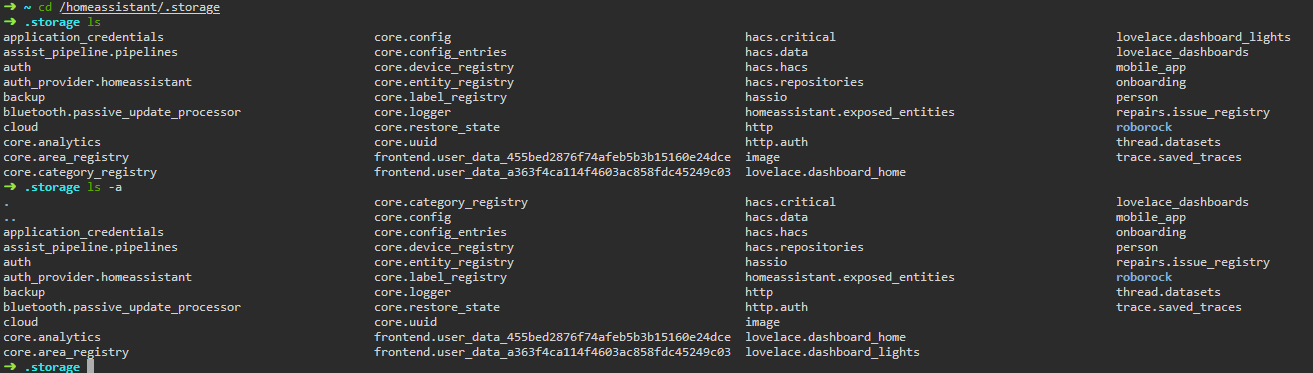

Is input_text something that should be in there already, or something I need to create? If the latter, would it just be a file with max 500 added to it?
Assuming I’m in the right place (inside the homeassistant folder) I’m not seeing an input_text file to edit there:
The /config folder has the configuration.yaml file and some other things in it, but no .storage folder so I don’t think it’s the right place, the homeassistant folder I think looks closer to what I should be seeing?
Thanks again and sorry about the bother on this!
That looks like the right folder to me (just in front of your prompt you can see it says .storage). In mine, I have many similar files to yours, but also files like input_button, input_number, and input_text, which describe input helper objects. Yours doesn’t have those files.
Have you created a text input helper before? (Settings > Devices & services > Helpers > Create helper > Text). If so, you’d expect the file to exist… otherwise perhaps HAOS stores these files somewhere else? I run a container, so I can’t say.

Ah, I see - I hadn’t created a text helper yet, so the directory didn’t yet exist. After creating one I now have that input_text file.
I’m assuming I just need to change 255 to 500 on ‘max’ here, restart, and then it should be good to go?:
