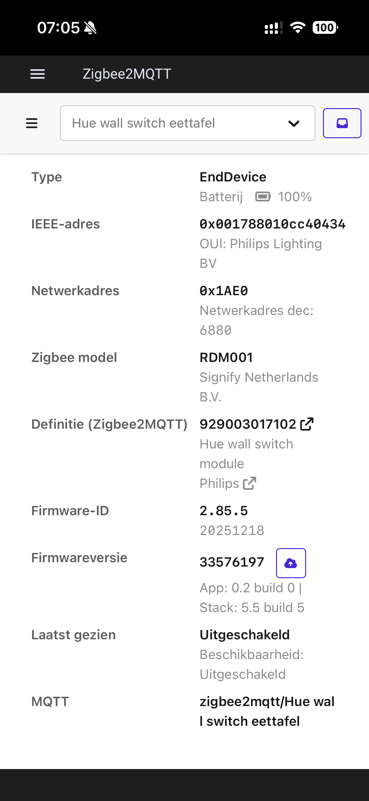

To bring everyone up to speed on the full picture: I’m running the Philips Hue Wall Switch Module through Zigbee2MQTT, not the Hue Bridge integration, that got cleaned up early on after I realized having both active at once was probably muddying the troubleshooting. The button-to-action mapping comes from the RDM004 blueprint linked earlier in this thread, so the automation logic itself isn’t something I built from scratch.
The problem I keep running into is that the light reliably goes out about five minutes after the last button press, no matter what state I leave it in. My first assumption was that the module was simply dropping into its battery sleep mode and taking the light down with it, since that’s the behavior I’d seen and couldn’t get past even after trying different pairing approaches and reporting settings. But watching the switch entity more closely, I noticed that right around that same five-minute mark, its action attribute quietly resets itself to N/A, and the light drops at almost exactly that moment.
That timing lines up too well to be a coincidence, so my current theory is that this isn’t a sleep or hardware issue at all, it’s an automation reacting to that N/A reset as if it were a genuine button press. If the trigger in the blueprint or in my own setup is listening for any change on that entity rather than a specific value, the reset would fire it every time, five minutes after the fact, completely independent of the actual sleep behavior of the module.
What I still don’t know is whether that N/A reset is something the Hue module itself sends, or just Z2M clearing a stateless attribute after a timeout with nothing actually happening on the device side. If it’s the latter, the fix is probably in tightening up the automation trigger rather than anything to do with the module’s battery or sleep behavior. If anyone else running this same combination, RDM004, Z2M, and this blueprint, has run into the same five-minute pattern, I’d be glad to hear whether that reset is expected and harmless or worth chasing further.

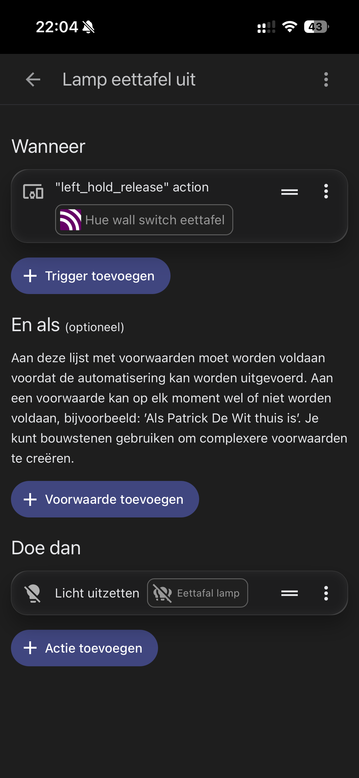

Looks like left_hold_release event is being fired. What is the blueprint set to do when left_hold_release is triggered? Is it set to turn off the light?
I just saw that i i dont used it anymore Maybe because it didnt works. No my automation to turn lights of is
