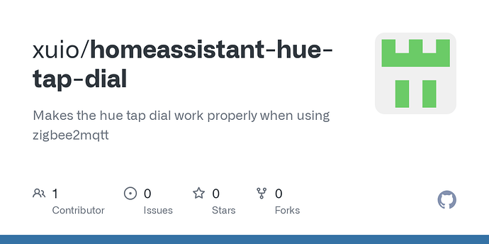

I started to use a bunch of these controllers with zigbee2mqtt and got frustrated with the multiple button presses and other superfluous mqtt messages that make it a bit difficult to use.
So I created an integration that hopefully resolves this:
It supports short & long presses, dial rotations and combined button holds + dial rotations.
For easy dial control, it exposes a parameter brightness_delta to the automation.
To create an automation that changes a value on rotation you can use the exposed “Device” as a trigger and select brightness_step_up and brightness_step_down as triggers. Then you can access the delta and scale it down like so:
{{ trigger.event.data.brightness_delta | float ) * 0.1) | round(0) }}
it is positive for right turns and negative for left turns, so you can just add it to the current value of the device.
To make it work you need to enable simulated brightness in zigbee2mqtt. A delta of 1 and an interval of 50ms seem to work well.
I would appreciate your feedback if you decide to try it out! :slight_smile:

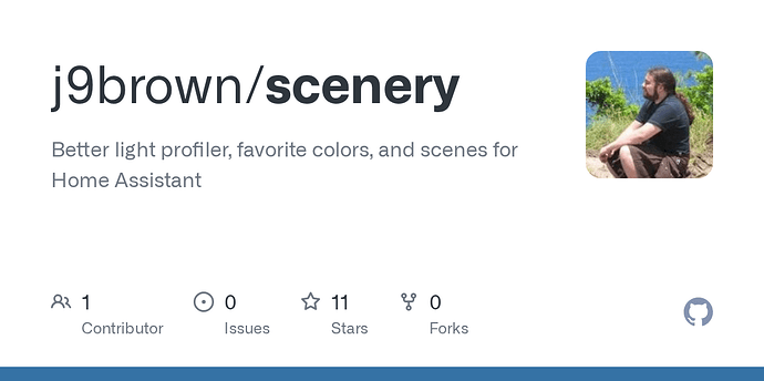

I just set up my Philips Hue Tap Dial controller as a scene controller with ZHA. It works quite well so I thought I’d share my experience with folks here.
First, I used Scenery to define some favorite colors and light profiles for my lights (and light groups).
Then, I created an automation blueprint to associate a Philips Hue Tap Dial controller with a light (or a light group). It works like this:
  • Single/double/triple/quadruple/quintuple click button 1, 2, or 3 to turn on the light and apply a light profile.
  • Click button 4 to turn off the light.
  • Hold button 1, 2, 3, or 4 to run a script.
  • Turn the dial to change the brightness of the light.
For my purposes, I configured button 1 to turn the light on bright white, button 2 for warm white, button 3 for a variety of colors that are easy on the eyes for bedtime, button 4 turns the light off. Multi-clicking each button produces variations on this theme. I configured the scripts to perform global actions for lights in the same area when I hold a button. In particular, holding button 4 turns off all of the lights. It feels pretty intuitive overall.
I’ve uploaded the blueprint in the Scenery repository because it works best when you have already defined a bunch of light profiles (and that’s what Scenery is good for). Hope you find it useful!
Link to the blueprint:

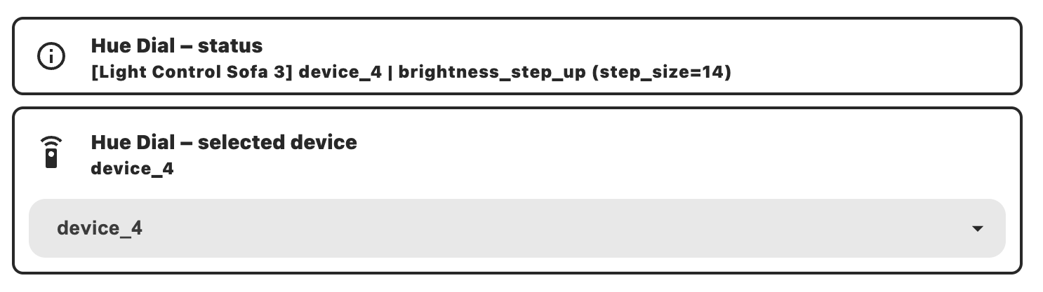

based on a comprehensive analysis of the log output of my Hue Dial Taps in Z2M in detail (what exactly happens for single press, hold, step/slow/fast rotation) I created - with a lot of ai help - a universal architecture to use the Hue Dial Taps in a way, that the rotary knob can be used for different devices.
I have 10 Hue Dial Taps in my apartment and they are central to controlling my different light devices (a mix of CCT, CCT/RGB, special devices like star projectors, infrared controlled candle lights, led fire place, etc.). I also will add a touch kiosk device later, but I'm a fan of still providing haptic controls in my apartment.
The control logic of the basic architecture provided here is as follows:
The Hue Dial Tap has 4 buttons and a rotary dial. Each button controls a different device. Press a button (1-4) to select the device you want to control. Now you have five seconds to send additional commands to the device by using the dial or other button actions (single press, double press, hold) all control that device. After 5 seconds the selection resets to idle.
In idle state the dial does not affect any of the four devices. Instead it can be used for something else entirely, like e.g.:
  • Controlling the volume of a speaker in the room
  • Adjusting the brightness of a whole light group
  • Any other action you want to assign
This is the example final hue dial switch configuration at my place:
Below is the complete project summary with the opportunity to just copy&paste the yamls into the needed automations and scripts + the necessary information to create the required helpers. To easily monitor the triggered button and rotate actions I highly recommend creating a dashboard in HA which shows at least these two helpers shown in the screenshot (and part of the setup instructions below). Like this I was able to do a detailed test whether the correct actions where triggered by the various possible button/dial rotate sequences:
Part 1 — Philips Hue Dial Tap Switch (RDM002): Scalable Architecture for Home Assistant via Zigbee2MQTT
This post describes a clean, scalable architecture for controlling multiple devices with one or more Philips Hue Dial Tap Switches (RDM002) in Home Assistant via Zigbee2MQTT. The design separates routing logic from device logic, so you can add new devices or change behaviour without touching the core automation.
This is the foundation. Part 2 adds working device-type automations (CCT and CCT+RGB lights). Part 3 adds idle-mode volume control for speakers.
How it works
Each dial tap has four buttons and a rotary dial. The architecture implements the following state machine:
  • Idle state — no button selected. Dial rotation is handled by a shared idle script (Part 3 uses this for speaker volume control).
  • Button 1–4 single press — selects that button's device. The dial and any further actions on that button now control that device only.
  • Button 1–4 double press — dispatches a double_press action and returns immediately to idle.
  • Button 1–4 hold — selects the device and dispatches a hold action.
  • Button 1–4 hold release — dispatches a hold_release action.
  • 5-second timeout — if no button or dial interaction happens for 5 seconds, the selection returns to idle.
All routing logic lives in one automation (works for any number of dial taps — just add more MQTT triggers). All device-specific logic lives in scripts that you fill in (Part 2).
One-switch-at-a-time lock
When several dial taps share the same room or zone, they also share selection state. To prevent two people operating two dials at once from corrupting that shared state, the router enforces a simple rule: once a switch leaves idle, it locks out every other switch until it returns to idle (via double press or the 5-second timeout). Idle dial rotation is exempt — it never sets the lock, so volume control from any idle dial always works.
What you need
  • Home Assistant with Zigbee2MQTT and MQTT integration
  • One or more Philips Hue Dial Tap Switches (RDM002) paired in Z2M
  • The friendly names of your devices from the Z2M frontend
Step 1 — Create helpers
Create these helpers via Settings → Devices & Services → Helpers, or add them to your configuration.yaml.
Input select — selected device
  • Name: Hue Dial – selected device
  • Entity ID: input_select.hue_dial_selected_device
  • Options: idle, device_1, device_2, device_3, device_4
  • Initial: idle
Input text — last button pressed (double-press detection)
  • Name: Hue Dial – last button pressed
  • Entity ID: input_text.hue_dial_last_button_pressed
  • Max length: 10
  • Initial value: 0
Input text — active switch (one-at-a-time lock)
  • Name: Hue Dial – active switch
  • Entity ID: input_text.hue_dial_active_switch
  • Max length: 50
  • Initial value: (leave empty)
Input text — status monitor
  • Name: Hue Dial – status
  • Entity ID: input_text.hue_dial_status
  • Max length: 255
Timer — idle timeout
  • Name: Hue Dial – idle timeout
  • Entity ID: timer.hue_dial_idle_timeout
  • Duration: 00:00:05
Counter — tap counter (double-press detection)
  • Name: Hue Dial – tap counter
  • Entity ID: counter.hue_dial_tap_counter
  • Minimum: 0, Step: 1, Initial: 0
Step 2 — Create the stub scripts
Create these two scripts via Settings → Automations & Scenes → Scripts → Add Script → Edit as YAML. They are stubs that fire persistent notifications so you can confirm routing works. Part 2 replaces them with real logic.
Script 1: hue_dial_idle_action
Called when the dial is rotated and no device is selected. Part 3 replaces this with speaker volume control; for now it just reports what it received.
alias: "Hue Dial – idle action"
description: >
  Dial rotated while no device is selected.
  Replaced in Part 3 with speaker volume control.
fields:
  dial_source:
    description: "Z2M friendly name of the dial"
    example: "Light Control Living Room"
  dial_action:
    description: "'brightness_step_up' or 'brightness_step_down'"
    example: "brightness_step_up"
  dial_step_size:
    description: "Raw action_step_size from Z2M (0-255)"
    example: 26
sequence:
  - action: persistent_notification.create
      title: "Hue Dial – idle"
      message: >
        [{{ dial_source }}] {{ dial_action }}
        (step_size={{ dial_step_size }})
Script 2: hue_dial_device_action
Called for all actions on a selected device. device_num tells you which button/device (1–4). Part 2 replaces this with a full assignment table.
alias: "Hue Dial – device action"
description: >
  Handles all actions for any selected device.
  device_num identifies which device (1-4) is being controlled.
fields:
  dial_source:
    description: "Z2M friendly name of the dial tap"
  device_num:
    description: "Which device is selected (1, 2, 3 or 4)"
    example: 1
  action_type:
    description: "'single_press' | 'double_press' | 'hold' | 'hold_release' | 'dial'"
    example: "dial"
  dial_action:
    description: "'brightness_step_up' or 'brightness_step_down' (dial events only)"
  dial_step_size:
    description: "Raw action_step_size from Z2M (dial events only; 0 for button events)"
    example: 26
sequence:
  - variables:
      dial_action:    "{{ dial_action | default('brightness_step_up') }}"
      dial_step_size: "{{ dial_step_size | default(0) | int(0) }}"
      title: "Hue Dial – device {{ device_num }}"
      message: >
        [{{ dial_source }}] {{ action_type }}
        {{ dial_action if action_type == 'dial' else '' }}
Step 3 — Create the router automation
Replace the topic list with your own Z2M friendly names. Add or remove trigger blocks as needed.
alias: "Hue Dial Tap – all devices router"
description: >
  v22: Routes Zigbee2MQTT events from all Hue Dial Tap Switches to shared scripts.
  Only one switch can be active at a time — when a switch exits idle, it locks out
  all other switches until it returns to idle. The active switch is tracked in
  input_text.hue_dial_active_switch.
mode: parallel
max: 50
max_exceeded: silent
triggers:
  - trigger: mqtt
    topic: zigbee2mqtt/YOUR DIAL TAP NAME HERE
  # Add more devices:
  # - trigger: mqtt
  #   topic: zigbee2mqtt/Light Control Bedroom
conditions:
  - condition: template
    value_template: >
      {{ trigger.payload_json.action not in [none, ''] }}
actions:
  - variables:
      z2m_action:     "{{ trigger.payload_json.action }}"
      dial_step_size: "{{ trigger.payload_json.action_step_size | int(0) }}"
      dial_source:    "{{ trigger.topic | replace('zigbee2mqtt/', '') }}"
      selected:       "{{ states('input_select.hue_dial_selected_device') }}"
      device_num: >
        {{ selected | regex_replace(find='device_', replace='') if selected != 'idle' else '0' }}
      active_switch:  "{{ states('input_text.hue_dial_active_switch') }}"
  # ── IGNORE dial_rotate_* (duplicate of brightness_step_*) ─────────────────
  - if:
        value_template: "{{ z2m_action is match('^dial_rotate_') }}"
    then:
      - stop: "dial_rotate ignored"
  # ── ONE-AT-A-TIME LOCK: drop events from other switches while one is active
  - if:
        value_template: "{{ active_switch not in ['', 'unknown', dial_source] }}"
    then:
      - stop: "Another switch is active"
  # ── DIAL EVENT ─────────────────────────────────────────────────────────────
  # dial_step_size > 0 filters out the spurious brightness_step_* that fires
  # during a button hold (which has action_step_size: null → 0).
  - if:
        value_template: >
          {{ z2m_action in ['brightness_step_up', 'brightness_step_down'] and dial_step_size > 0 }}
    then:
      - action: timer.start
          entity_id: timer.hue_dial_idle_timeout
      - if:
          - condition: state
            entity_id: input_select.hue_dial_selected_device
            state: idle
        then:
          - action: input_text.set_value
              entity_id: input_text.hue_dial_status
              value: "[{{ dial_source }}] idle | {{ z2m_action }} (step_size={{ dial_step_size }})"
          - action: script.hue_dial_idle_action
              dial_source:    "{{ dial_source }}"
              dial_action:    "{{ z2m_action }}"
              dial_step_size: "{{ dial_step_size }}"
        else:
              value: "[{{ dial_source }}] device_{{ device_num }} | {{ z2m_action }} (step_size={{ dial_step_size }})"
          - action: script.hue_dial_device_action
              device_num:     "{{ device_num }}"
              action_type:    dial
      - stop: "Dial event dispatched"
  # ── BUTTON PRESS: increment counter, reset only on button change ───────────
  - if:
        value_template: "{{ z2m_action is match('^button_[1-4]_press$') }}"
    then:
      - variables:
          btn_num: "{{ z2m_action[7] }}"
      - if:
            value_template: >
              {{ btn_num | int(0) != states('input_text.hue_dial_last_button_pressed') | int(0) }}
        then:
          - action: counter.reset
              entity_id: counter.hue_dial_tap_counter
              entity_id: input_text.hue_dial_last_button_pressed
              value: "{{ btn_num }}"
      - action: counter.increment
      - stop: "Press recorded"
  # ── BUTTON PRESS RELEASE: single or double press resolution ───────────────
  - if:
        value_template: "{{ z2m_action is match('^button_[1-4]_press_release$') }}"
    then:
      - variables:
      - delay:
          milliseconds: 400
      - if:
            value_template: >
              {{ states('input_text.hue_dial_last_button_pressed') == '0' }}
        then:
          - stop: "Consumed by double press instance"
      # ── DOUBLE PRESS: dispatch, then return immediately to idle ──────────
      - if:
            value_template: >
              {{ states('counter.hue_dial_tap_counter') | int(0) > 1 }}
        then:
              value: "0"
              value: "[{{ dial_source }}] button_{{ btn_num }} | double_press"
          - action: input_select.select_option
              option: idle
          - action: timer.cancel
              entity_id: input_text.hue_dial_active_switch
              value: ""
              device_num:  "{{ btn_num }}"
              action_type: double_press
          - stop: "Double press dispatched"
      # ── SINGLE PRESS: select device, lock this switch ────────────────────
          value: "0"

Step 5 — Monitor and test
Add an Entities card to your dashboard with:
  • input_select.hue_dial_selected_device — current selection
  • input_text.hue_dial_active_switch — which dial currently holds the lock
  • input_text.hue_dial_status — last action with source dial
With the stub scripts in place, every action creates a persistent notification showing exactly what was detected. Once you confirm routing works, move on to Part 2 to replace the stubs with real device logic.

Here comes the final Part 3.
Short summary of Part 1 and 2 before:
Part 1 provides a mechanism / control logic to use the Hue dial tap to control 4 different light devices and use the rotary wheel for all of them to e.g. control brightness. (I have 10 Hue dial swithches in my apartment, in every room at least one).
Part 2 provides examples for controlling CCT and combined CCT/RGB lights.
  • Single button press either turns the light on or let's the already turned on light blink for identification.
  • Press hold after single press / press hold when the light is off: starts the CCT temperature or RGB color selection cycle until button is released.
  • Press hold again within 5 seconds (before Hue dial switch goes back into idle mode): Switch from CCT to RGB or vice versa and continuing with temperature / RGB color cycle.
  • Double press turns the light off (often not needed if you have e.g. presence based detection to turn off light automatically (e.g. in bathroom or kitchen).
  • Rotary wheel action (within 5 seconds after single press or press hold): change brightness of currently selected light.
Now Part 3 implements volume control for currently playing speakers in the same room of the Hue dial switch. I have several Alexa speakers, one Samsung Soundbar (SmartThings) and Sonos speakers. The Alexa and Samsung speakers were a bit tricky to implement because they have some API glitches, while the Sonos speakers are much better local smart home companions. So quite some debugging and workarounds went into the Alexa and Samsung speakers. Because I play from Spotify on my Alexa and Samung speakers (often in "Everywhere" mode on all my 9 Alexa speakers in different rooms) I also used checks against the HA Spotify integration to further stabilise the playing speaker detection and be less dependent on Alexa API and Samsung API glitches. Finally I can now comfortably and quickly adjust the volume individually for speakers in every room, especially useful also when all speakers are playing in "Everywhere" mode.
When the Hue dial taps are in idle mode (no button was pressed to control lights in the past 5 seconds) then rotary wheel action leads to a check if any speakers in the same room (area) are playing. If yes, these speakers receive a volume up or down command depending on the rotary wheel direction received.
Because one rotary wheel action on the Hue dial tap, which is more than just one step rotation, generates a burst of payloads (sometimes up to six if I do a longer rotation) I implemented a mechanism which evaluates all payloads received within 1.5 seconds and takes from these payloads the max action_step_size value. Like this I achieved I quite good consistency of my actual rotary wheel actions with the then calculated volume change in the automation.
I'm really happy with the usage experience now, for both the light control and volume control. And also for other people being at my place I'm confident that the control logic will be easy to understand, without requiring extensive instructions. With the knowledge of double press and hold options one can probably even intuitively find out the rest oneself (except the volume change functionality with the rotary wheel, that certainly needs to be mentioned, but many speakers in my apartment are also in reach so that the volume can also be changed on most speakers themselves, and a smart home kiosk will also be available in the future to allow central control off all devices in the apartment).
So here's Part 3:
Part 3 — Idle-Mode Volume Control for Speakers
This builds on Parts 1 and 2. In Part 1 the dial, when idle (no button selected), called a stub hue_dial_idle_action. This part replaces that stub with a complete speaker-volume-control feature: rotate any dial while idle and it adjusts the volume of whatever is playing in that dial's room.
It works across Sonos, Amazon Echo (alexa_devices), and SmartThings speakers, automatically discovers which speakers belong to the dial's area, figures out which are actually playing, debounces the dial's noisy event bursts, and confirms each volume change before accepting the next.
