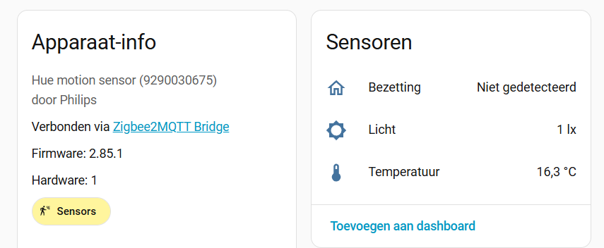

Works fine for me with motion sensors. Got update this week for all my sensors. Not using the Hue bridge anymore though.

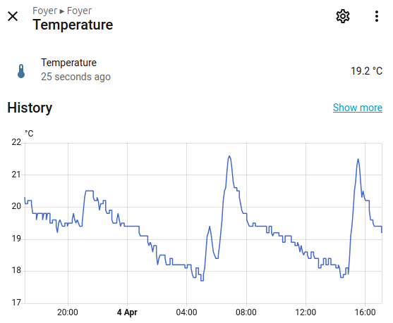

I am running 2026.4.1 and have two Philips Hue Motion Sensors connected via the Philips Hue integration. Both of them report temperature regularly.
